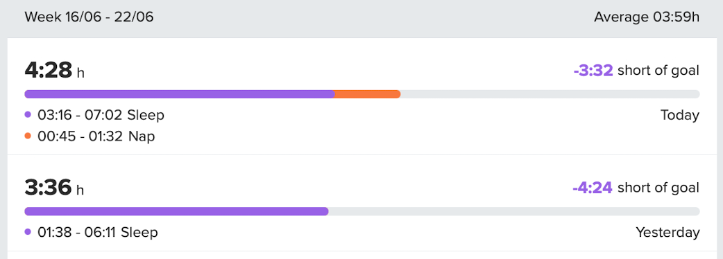

          Did you find a way to make it work ?
          I have the same issue with Race S.
          I have it for a month now, and except on two times, it always detects my start sleep time 2/3 hours later than reality (turn off lights at 11PM and it says I fell asleep at 2/3AM …)
          It is not a big deal as I rather trust my sensations than the watch but due to that, recovery stats are bad and other metrics are impacted…

              @IceRim I did but unfortunately same issue (yesterday and this night)
              For example this night it reports
              • falling asleep : 3AM (turned off light at 11PM)
              • wakeup : 7AM (accurate)
              • nap detected : between 1h - 1h42 (AM)
              Will try to change some params to see (rest HR or sleep target)
              Yesterday (firmware 2.43.8) almost all was incorrect
              Start/end sleep time and even the sleep duration seemed incorrect
