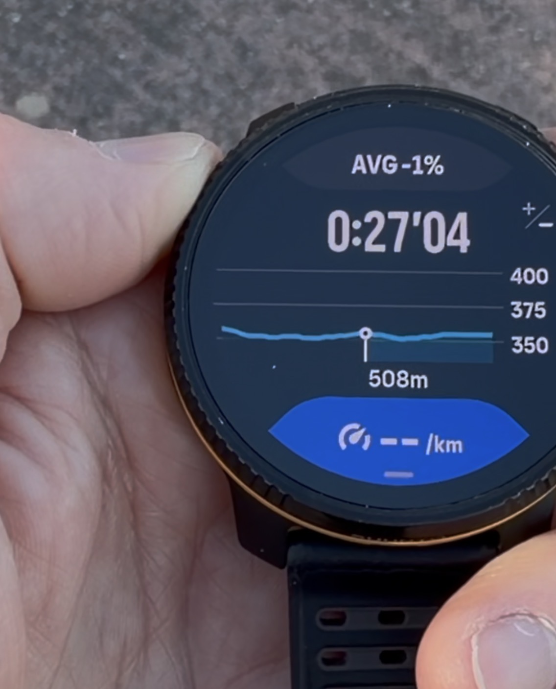

          And also notice these artifacts
          Race S

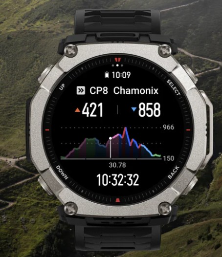

            1.- Published by you a year ago @sky-runner Navigation with waypoints
            This is so important…When you go to a very long ultra race, the very first thing we usually study is the profile of that race.
            The Coros implementation you referenced can be improved with what did Amazfit. This shot:
            As you can see, is much cleaner setting the colors of the climbs and changing the waypoint icons Coros used, with just white dots. Nothing more, clean and perfect.
            This is important because in a very long run, those icons Coros has can overlap.

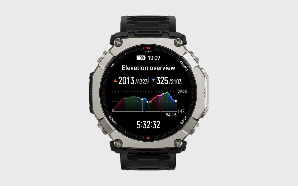

            3.- Somehow related, and for a watch that has a Climb Guidance feature, this should be considered as a bug-improvement:
            Altitude navigation
            This screen:
            Should be more similar to 1. Climb colors and waypoints should be there for the watches that support Climb Guidance.

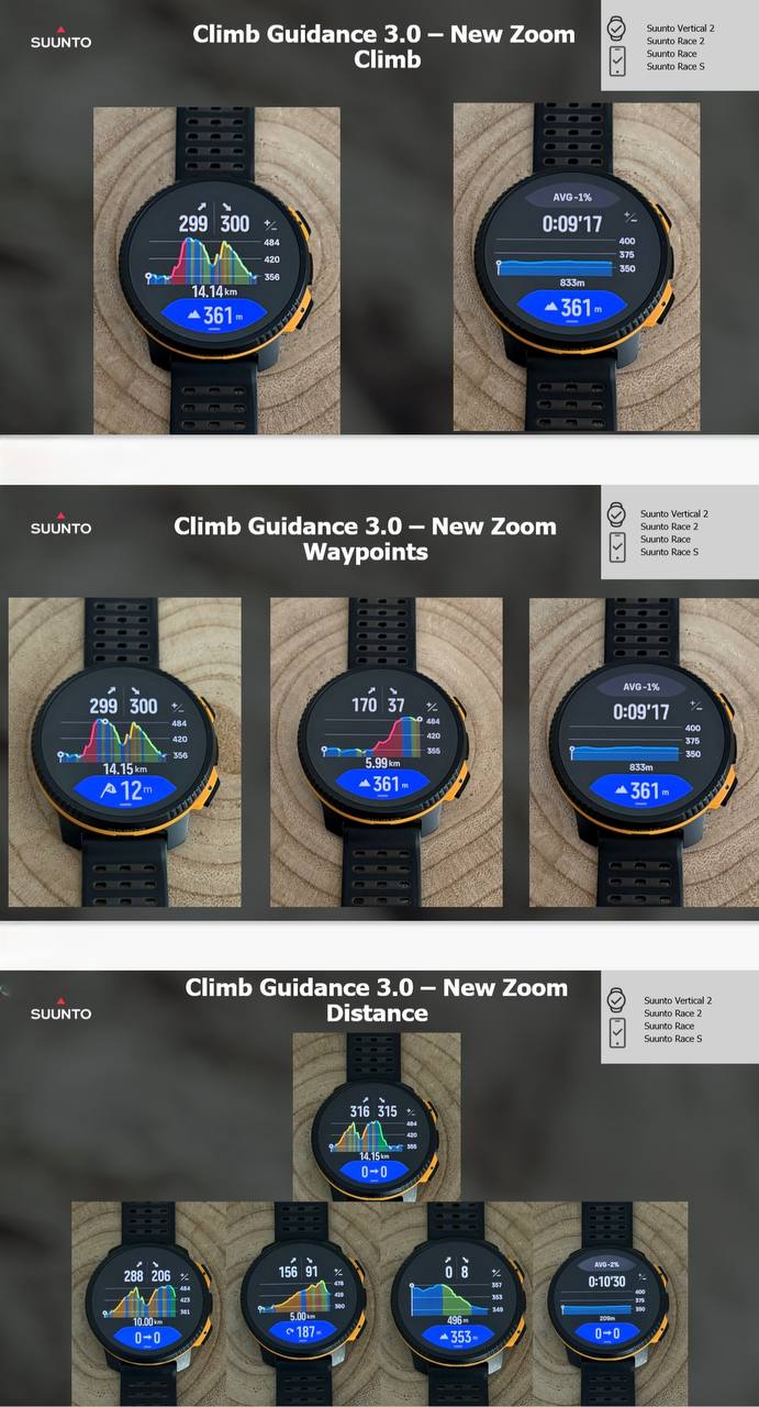

                @dreamer_ Thank you for the detailed feedback and for taking the time to share these ideas.
                Since the last update, Climb Guidance 3.0 already offers three different zoom approaches that address several of the use cases you mentioned. You can also see this behaviour demonstrated in the video shared in the thread. In all cases, the final zoom level always focuses on the current climb segment.
                Segment based zoom
                This mode shows the full elevation profile of the route while allowing you to zoom directly into the current climb segment. It provides context of the entire route while keeping the focus on the climb you are currently tackling.
                Waypoint based zoom
                When waypoints are added to the route, the system automatically segments the profile between those waypoints. The zoom view can display up to the next four upcoming waypoints and the final zoom level always focuses on the current climb segment. In this view you can clearly see ascent, descent, distance, altitude and any customised metric in the lower data field.
                Distance based zoom
                The profile can also be explored using distance based zoom levels such as the next 10 km, 5 km or 500 m. As with the other modes, the final zoom level always focuses on the active climb segment.
                Regarding the comparison with other implementations, it is worth noting that many solutions simply highlight climbs and descents without true segmentation or contextual zoom levels. While Climb Guidance can certainly continue to evolve, the current implementation already provides a very detailed and structured view of the elevation profile.
                From my experience testing climb guidance implementations across many different devices and platforms, Suunto’s current approach, while not perfect, is by far the most complete solution available today. It provides a level of segmentation, contextual zoom and information density that other implementations simply do not offer while still maintaining excellent readability during long activities. In real world use, especially during ultras or long mountain efforts, this balance between clarity and depth of information makes a very significant difference.
