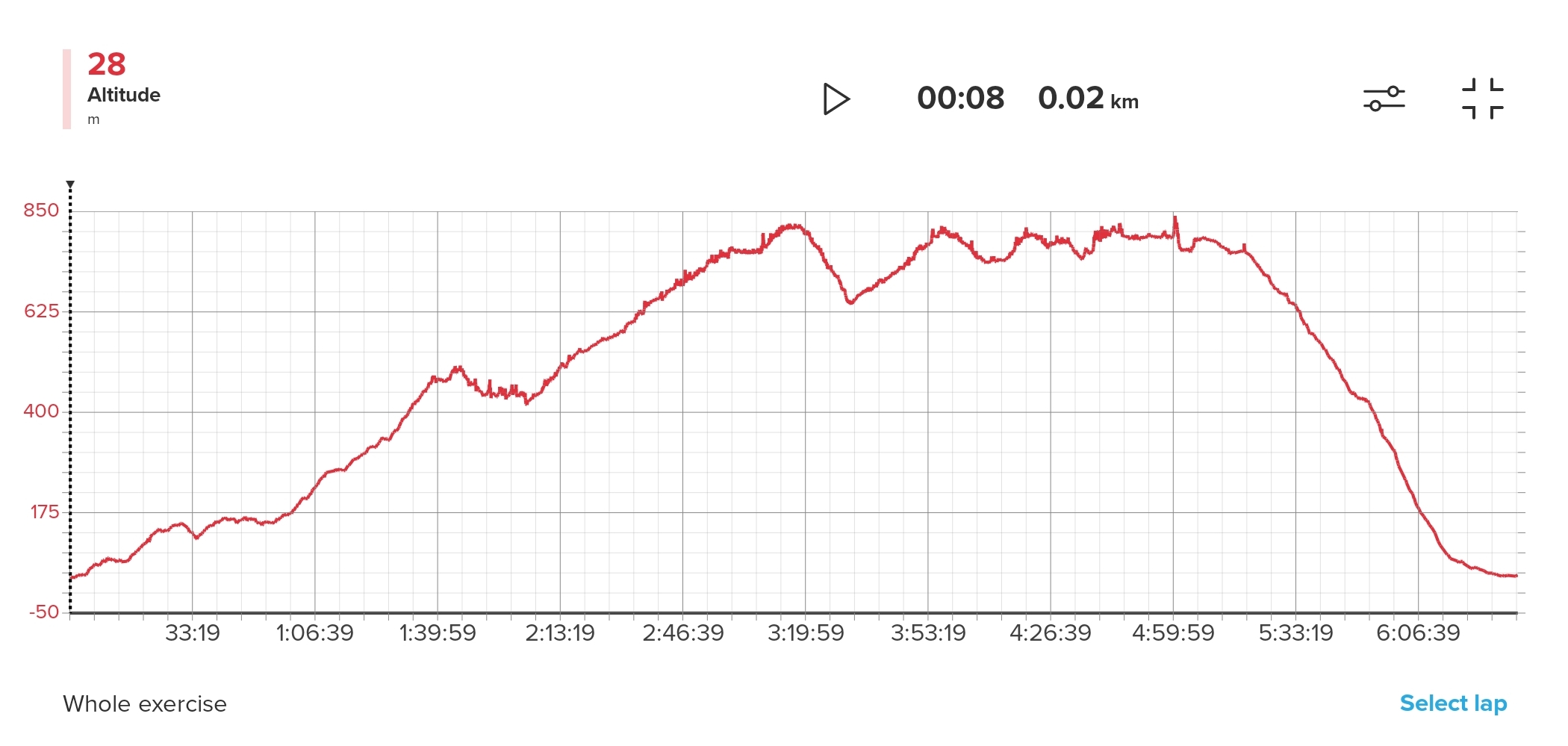

        @Brad_Olwin This applies to 2 Suunto watches, 9PP and Vertical. A lot of time has passed since the release of Suunto 9 Peak Pro and this problem repeats very often in both watches, regardless of resets or cleaning (these were brand new watches).
        Altitude graph
        Suunto Vertical shows 1553m total climbs. Totally absurd in very strong winds.
        Laps
        Link to this activity (I had to stop further hiking due to the gusty wind):
        https://maps.suunto.com/move/maszopmz/65b4e463aecad96a9da9c27f

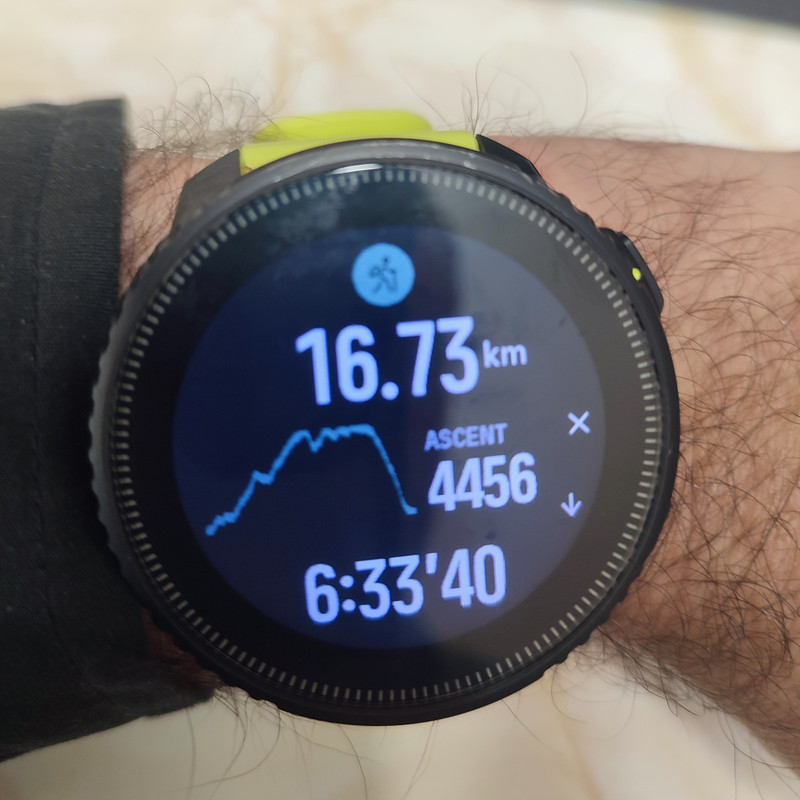

              And again.
              Suunto Vertical shows 4456m ascent instead of about 1400. Wind about 60km/h.
              Altitude graph
              Brad_OlwinB 1 Reply Last reply Reply Quote 0

                @maszop I just did a very windy run and had overestimates as well in elevation gain. Not as bad as yours but it happened on the Vertical. It does not happen often to me and I might consider putting the watch under a sleeve as this would likely help. I was changing directions often so the wind hitting the sensor was not all the time. My graph has the issues yours does with lots of little spikes. It can happen, not sure much can be done about this as I have seen the same issue with an Apple Watch Ultra. The sensors have to be sensitive to detect small changes in pressure; enough wind in the right place will affect it. Maybe Suunto can make this better, I am not sure if that is possible.
                BTW I have had worse issues like this on the 9baro and less issues with the Vertical, the sensor is in a much worse position on the 9baro.
                I can dig up the data if you like.

                  @Brad_Olwin Unfortunately, covering the watch with sleeve does not help. I’ve tried various methods, keeping it in my pocket, under my sweatshirt, under my jacket, completely outside and there are always strange things happening in strong winds.
                  This is a link to the activity, I manually changed the ascent and descent to the correct ones, recorded once in calmer weather.
                  https://maps.suunto.com/move/maszopmz/65e36100073ba655aff7e2b7
                  Here is the result from the watch:
                  ascent
                  I wonder if a simple (optional) filter would be enough to normalise (flatten these results) - e.g. to be turned on when we observe such drastic anomalies.

                          @Tieutieu Vertical and the previously used 9PP measure point height very accurately. No issues with that.
                          The problem is with these spikes visible on the chart - sudden, small, but very frequent changes in elevation.
