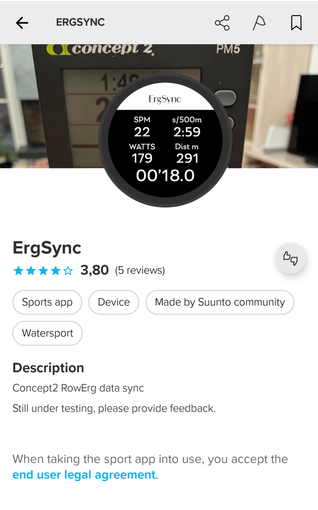

            I just uploaded version 0.4 of ErgSync to SuuntoPlus store:
            • 3 screens with all stats from PM5 (use bottom button to switch)
            • added logging of 4 main stats
            • switched to using icons
            • fixed distance display (4 > 5 digits), please test
            • display wrist HR
            TODO
            • update graphics and descriptions in SuuntoPlus store for new version
            • improve the readability of data (restore text descriptions instead of icons - please give feedback)
            • looking into options of how to send the activity along with 4 logged stats to Concept2 LogBook (ErgData)
            Martin LillepuuM P 2 Replies Last reply Reply Quote 5

              said in Suunto and Concept 2 indoor rowing:
              Hi,
              TODO: update graphics in SuuntoPlus store for new look
              Here are some photos of ErgSync v0.4 https://photos.app.goo.gl/LRGEyvKZCFhAu9oA7

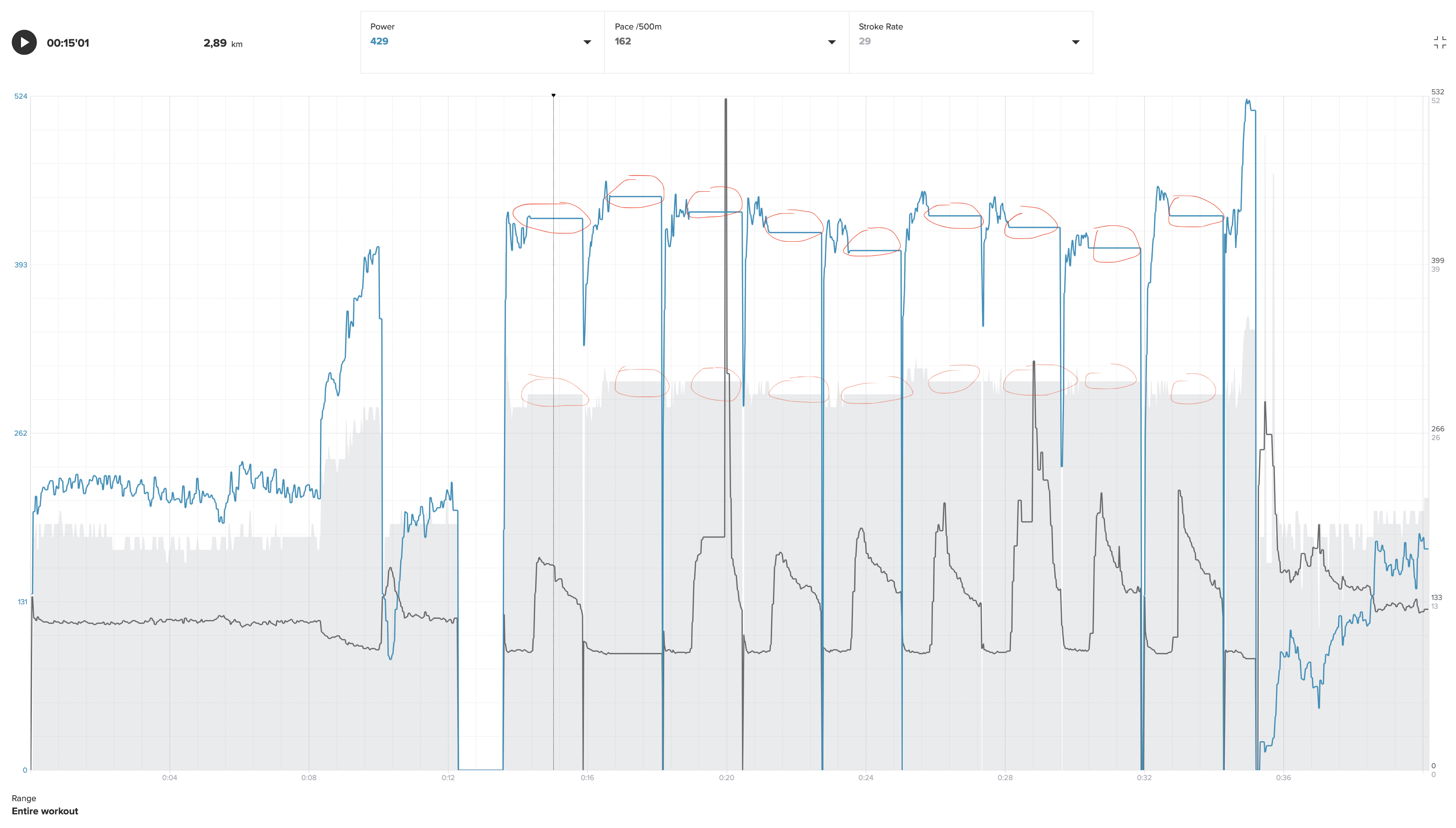

                          Did some intervals the other day, and when in recovery between the intervals the last recorded power and stroke rate seems to be continuously logged until the next interval starts. Assuming this is a PM5 thing as its data also looks to be locked, but maybe the data is on a different data stream or those values can be set to zero for the Suunto logging during recovery time?
                                  the last measured power and stroke rate keeps getting logged on the watch
                                  From my screenshot, where the continues lines lie at like 440 Watts during the rest mode instead of the actual power
