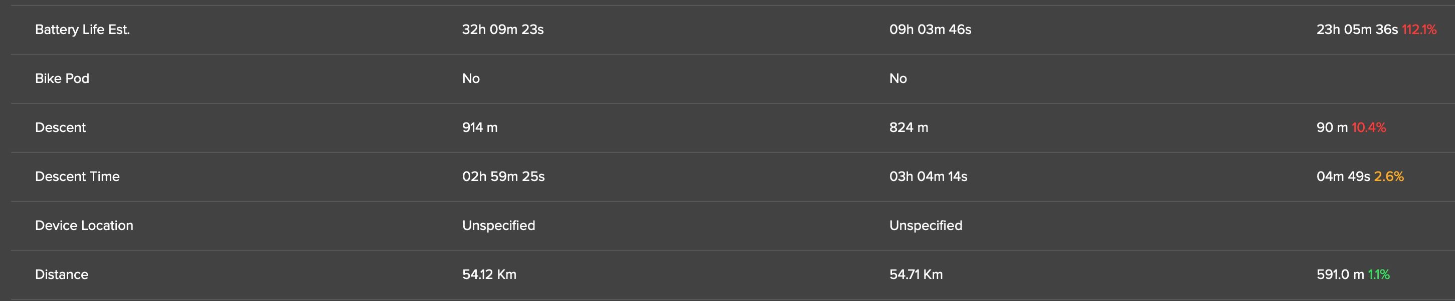

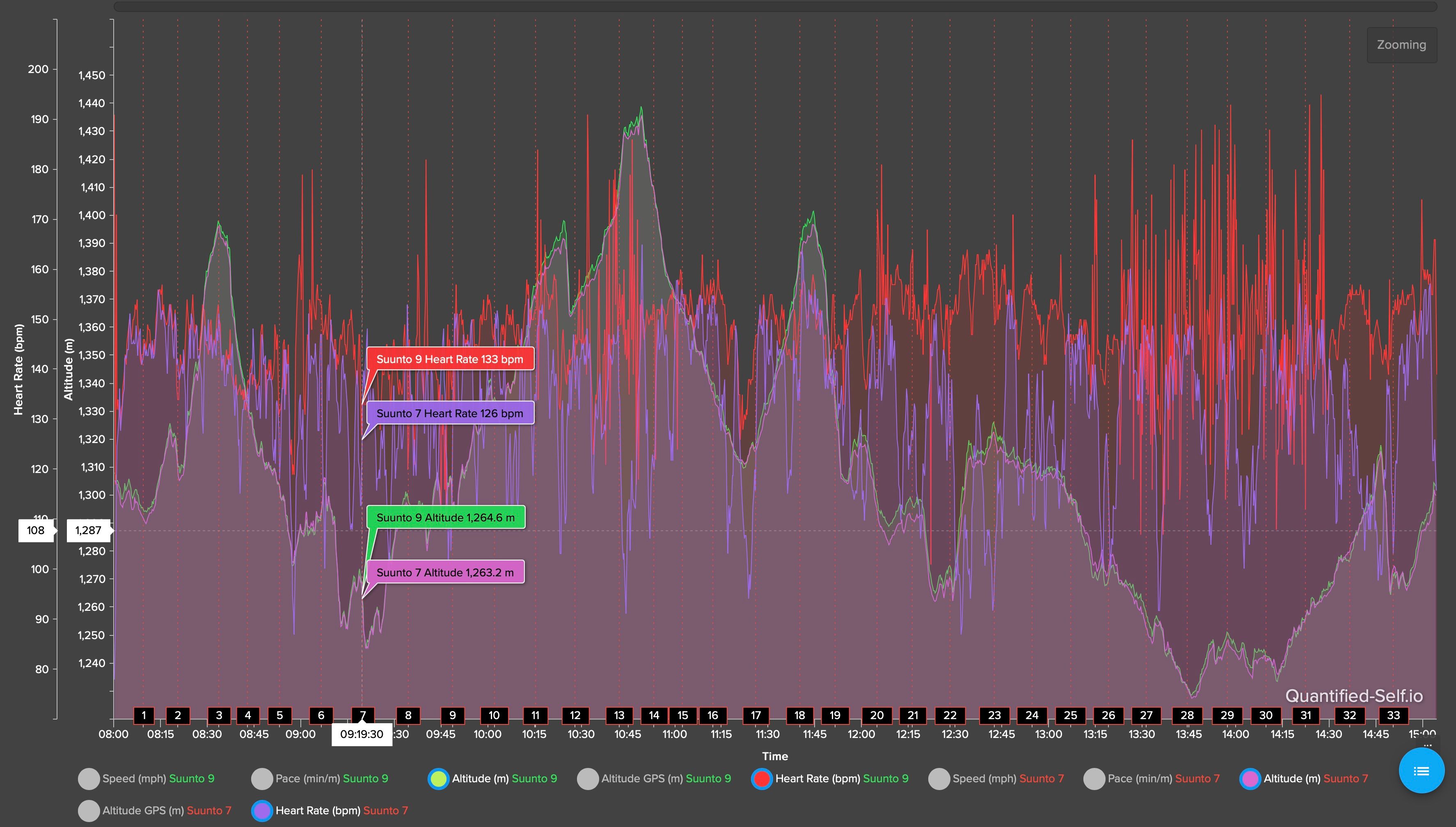

      Well, it works and worked well! I used my Suunto 7 in an ultramarathon last weekend. Antelope Canyon 55k. I wore the S7 on my left wrist and because I was carrying my phone and wanted max battery, I put the watch in Airplane mode, turned off touch to wake and turned off powersavetilt. I left vibration on and ran in Trail Running Basic. My time was 7:03 and the watch would have easily gone another 2h as I ended with 18% of the battery left, enough to last the rest of the day. The tracking was excellent even in the slot canyon. Comparison with S9baro and smart sensor belt below. The distances were less than 500m apart and agreed with the race distance.
      So any of you wondering if the S7 will last a marathon…I doubt too many have a finish over 7h
      The S7 is in red and S9 in green (S9 on best recording)

                @Brad_Olwin can you please put some more details about total ascent, descent, distance for both? Thx!

                    @Marcin-Byrtek Here is the link, my HR did not get to 184. https://www.suunto.com/en-us/move/bradleyolwin/5e6d50e8d311ce62de37fb33

                      @Brad_Olwin
                      Can you post the link of S7 and S9 to compare.
                      On SA, it’s the S9? There is a est. VO2max.
