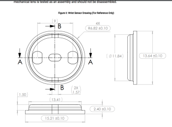

                              Also from the technical sheet bw2.0

                                  @dimitrios-kanellopoulos this drawing that you have provided shows 2 leds + optical sensor 🙂

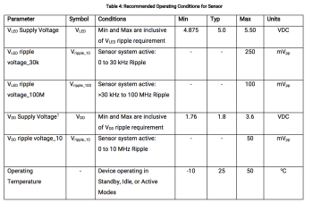

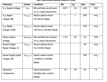

                                    I also finished electronics however it’s not my expertise.
                                    Taking a look at the specs:
                                    BW2.0
                                    BW1.2
                                    I dont see anything specific to the led sensors count.
                                    Correct me or help me to understand (before suunto replies)

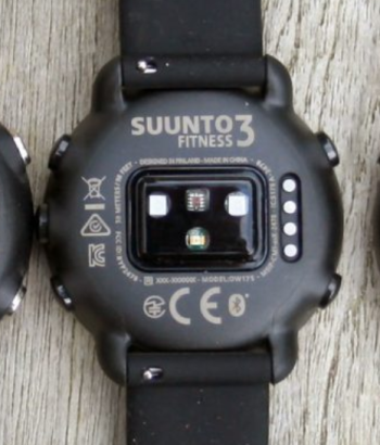

                                        Btw take a look at this:
                                        What do you make out (I am not expert here) and I more will trust you @slashas rather than 5K runner etc.

                                          @dimitrios-kanellopoulos looks like BW1.2 by shape, led placement 2 green, 1 yellow, optical sensor. Looks exactly the same as on my baro 🙂 this is just speculations, to confirm that I need FW 🙂

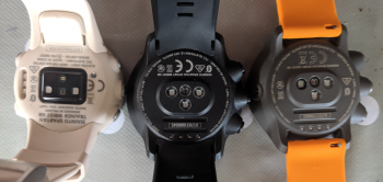

                                            Take a look here:
                                            Left is the trainer and then it’s SSSWHR and Baro. The SSWHR and Baro have a different component.
                                            Community Manager / Admin @Suunto
