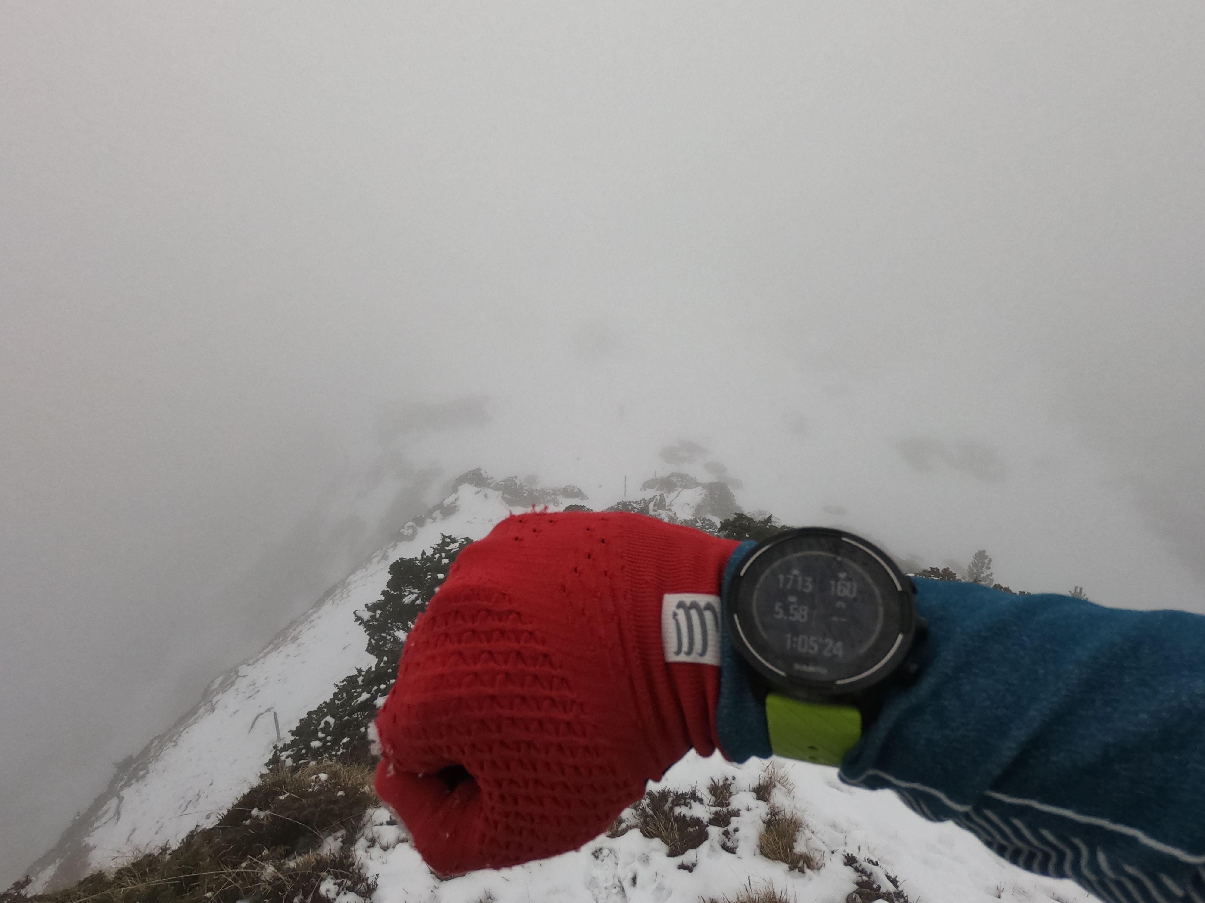

                                        OK, for me, rather than @stromdiddily:
                                        Case 1:
                                        Imagine you are in a place where there are no tracks but identifiable “summits”. A plateau, or moorland, say.
                                        Imagine reliably-surveyed maps have identified and differentiated points of elevation to within that 10m precision. In fact, down to 0.3m precision.
                                        Imagine you do not want to wait for the watch to display your location (and are running another S+ than SAFE) in coordinates and relatively slowly locate yourself on the map that way.
                                        Imagine visibility is this (high summer, 11:15, around 30m to the lumpy silhouette):
                                        And you don’t recognise those particular rocks but know they’re at the top of a hill. Your altitude (and your course) give you your precise location.
                                        If there are different heights, the top of whatever rise you’re on is likely “HIll 632” or whatever. NOT “Hill 633”. The less visually dramatic equivalent of a peak. That is a fast enough location fix that you don’t have to break stride. Your altitude (and your course) give you your precise location.
                                        Case 2:
                                        Following contour lines to bypass a cliff, watercourse or other obstructive feature otherwise obscured from view. With an accurately-surveyed map, the altitude precision saves wasting energy when you need to conserve it.

                                          @Fenr1r why not then just gps position ? What am I missing?
                                          He refers to start position altitude if I understood right.
                                          If we are going to say it’s like a high store building were you walk on a balcony and you need to detect which floor you should be (if I understand correctly ) imo the -±2, 3-10meter error won’t get you so safe. There I would not try to trust my watch to be honest nor any gps based device. But I like the conversation 😀.

                                            @Dimitrios-Kanellopoulos said in Suunto 9 FusedAlti not remembered after activity:
                                            Time.
                                            How many digits do you have to keep in your head to differentiate, say, 3 possible coordinate locations vs 3 max elevations? Think about it. X+Y, and those coordinates only start to vary at the end. Without a map on the watch (where this wouldn’t be a discussion) most people would have to double check those coordinates with the map each time. Having waited for the watch to produce them, or leaving it stuck on “Find Location” screen, providing no other info.
                                            With 3 sites, even working in feet, it’s hard to go beyond 5 digits (each) on Earth. And the watch can still be providing whatever other goodies it can. Possibly just direction. Or time.
                                            You might remember I wanted to include manual input in the Alti Fusion. This is why. (At user risk, of course.) I’m not leaving it up to Skynet.
