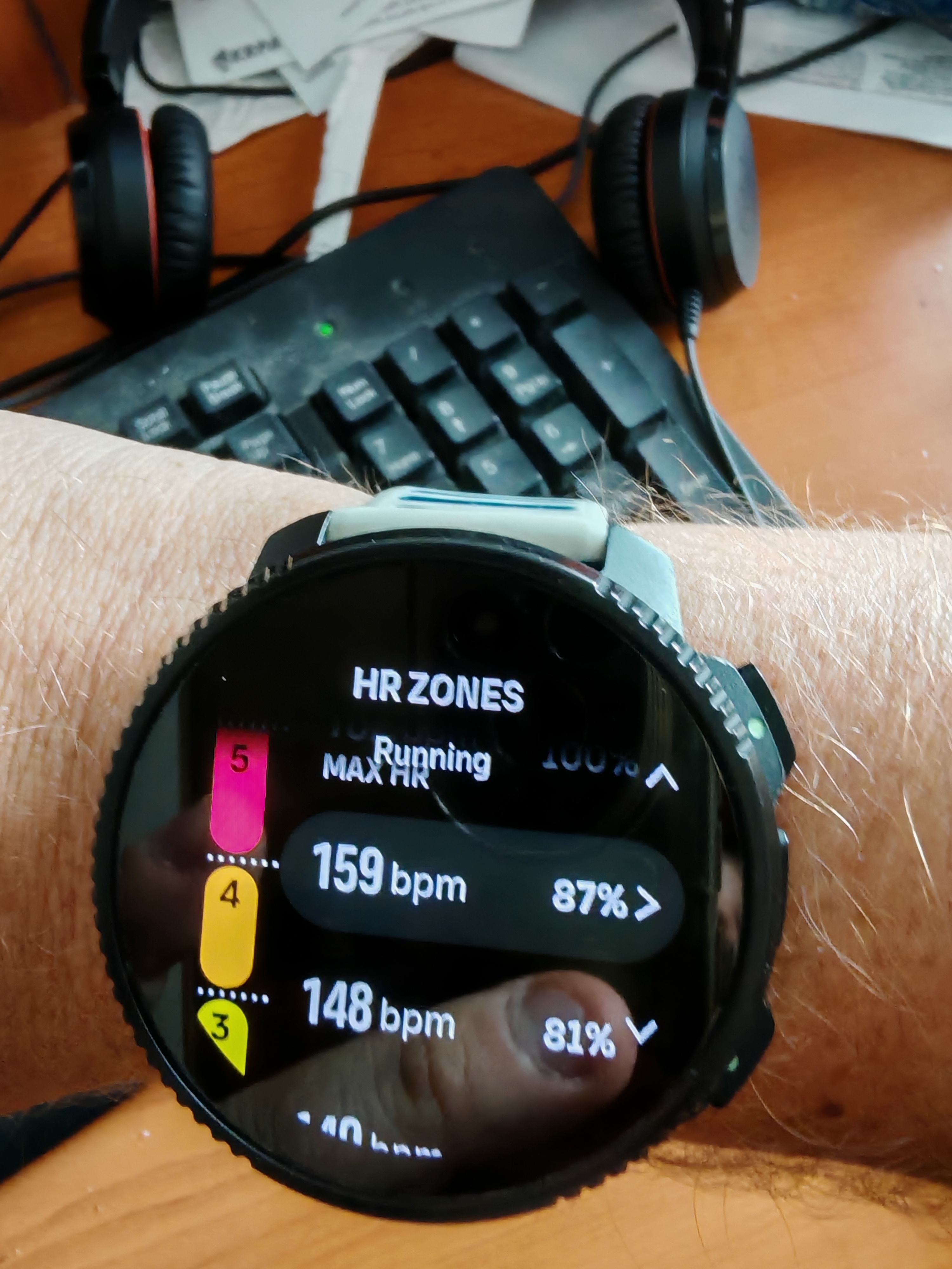

      Hello, I am trying to set HR zones and pace in watches, after I did anaerobic threshold test, my zones HR zones are
      Z1: 100–130
      Z2: 131–140
      Z3: 141–148
      Z4: 149–158
      Z5: 159–182
      and pace is
      Z1: 7:45/km
      Z2: 7:00/km
      Z3: 6:35/km
      Z4: 6:10/km
      when I set it in watches under Settings -> Training -> Intensity zones -> Advanced zones -> Running -> Special Hr Zones for running turned on and I set hr zones there, that is ok
      but when I am trying to set Pace zones in same menu, it is saved for about week, but then it will rst to times, you can see on screenshot. Why is it doing that? There is problem, when I generate training plan from suunto coach, first week is generated correct but when I started second week, paces where changed and whole training for second week was generated with new wrong zones, that is absolutely unrealistic for me in my actual sport condition :)… Any advice, how to make it permanent?
