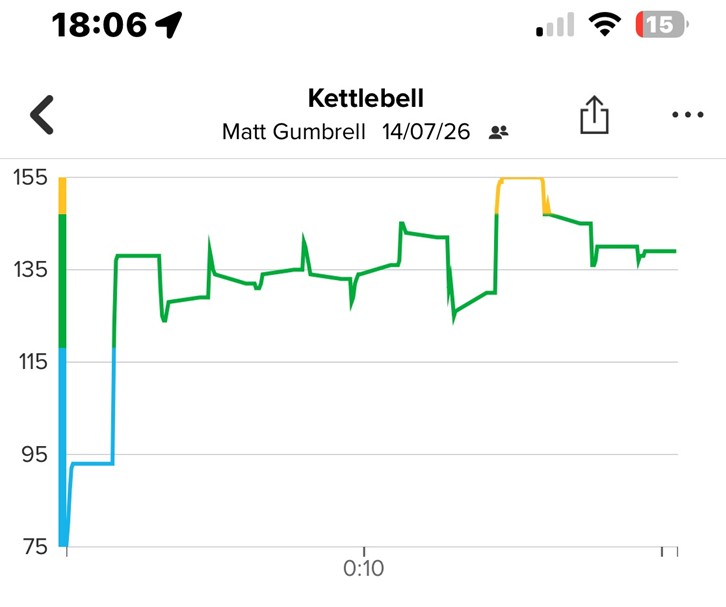

      It may just be huge coincidence but my Suunto HR sensor started continuously disconnecting from my Race on the afternoon of 14th July.
      The data is still saved in the HR sensor internal memory & synced to the watch when I end the activity but looks corrupt as below.
      HR sensor is only 8 months old & so far I’ve tried the following but the issue persists.

            When you experience the drop outs does your HR look similar to this in the app afterwards ?
