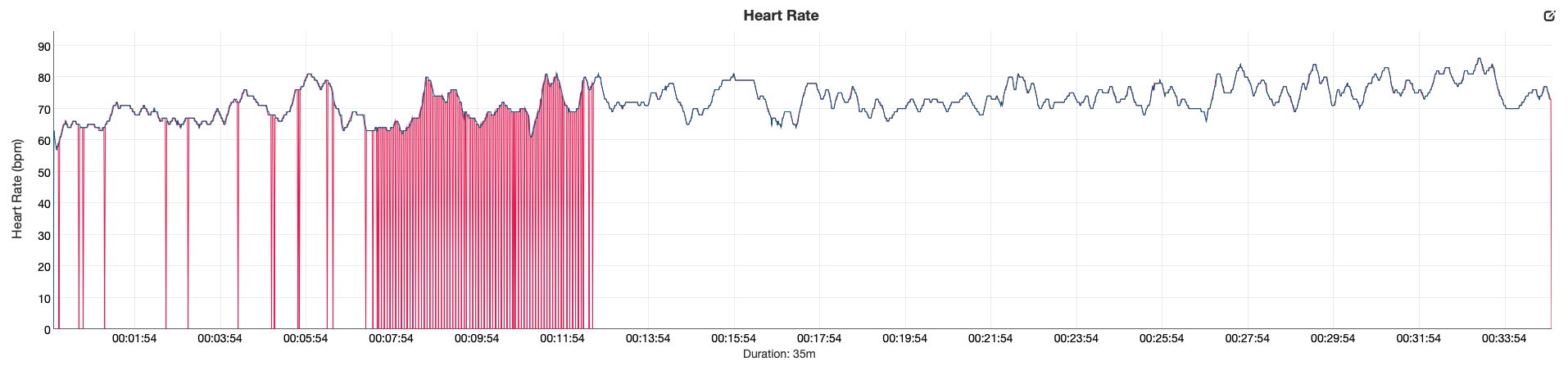

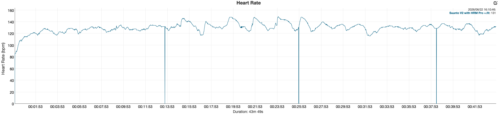

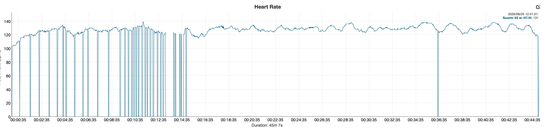

      I have recently had my HRM zero out mid run and had to take it off and reattach it to get a proper reading. The red one is with a Coros band. The one with two drop outs is with a Garmin HRM Pro+ The blue total disconnect one was with a new Polar strap. As I look at most workouts with BT HRMs I see dropouts and reconnects. My Coros and Garmins do not do this. It was an issue about a year ago to have total disconnects and that seems to be remedied, but I wanted to ask. Why does Suunto have an issue staying connected even when the HR during a workout does not disappear? In the red one it showed okay in the workout that it was okay and stayed continuous, but that doesn’t seem like it should be happening. (BTW the last red one is where I just walked around the farm in a walk activity to see what it would do so the HR is very low.)
      The graphs are done using DC Rainmaker Analyzer.
      Any insight would be great, Thanks!
