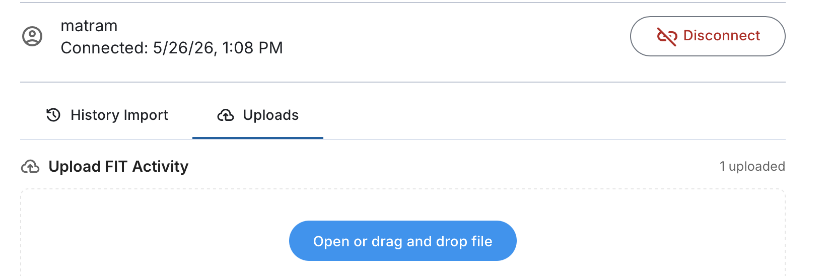

              Dimitrios, maybe we are mis-communicating? To clarify, I want to upload a FIT workout file (not activity) and secondly I do not have API access.
              I am not sure what you mean by “official channel of the app”. Are you referring to apizone - how-to-workout-upload (not allowed to include a link)? This seems to be what I need, but I am not allowed to use that. 😞
              quantified-self which you suggested, only seems to upload activities not workouts.
              intervals.icu uploads workouts but only packaged as a Guide in the format they have selected. Hence my idea about reverse engineering the guide file.
