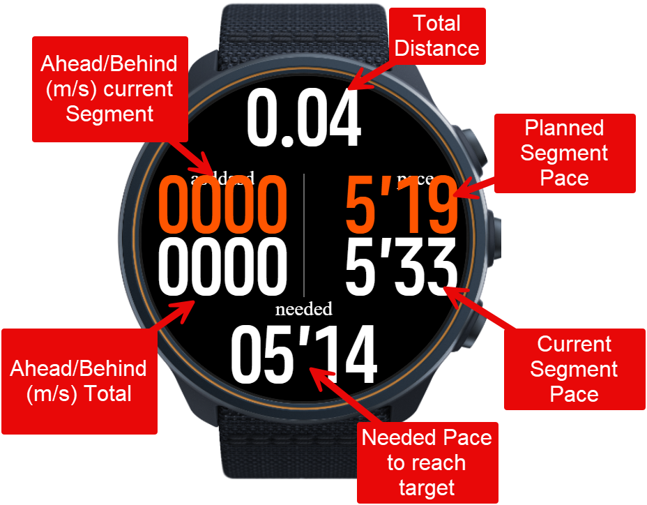

      Pretty new (and old…) on this, but cannot figure out how get negative values to display on the S+ Simulator? I am developing a Race Pacer app that takes user input based on pace zones and segments (running) and want to display ahead/behind per segment w. respect to predefined race plan (either time or distance). App in short:
      Sements are planned beforehand - and entered through user settings in mobile app:
      Watch display current configuration, where the problem is with the Ahead/Behind on the left fields:
      I have tested most outputFormats in HTML - but no success. I also tested Math.abs in the main java - and then it works as expected (without (-))…
      So - the logic is there and most things seem to work - and the race is on saturday… Any ideas/inputs?
      (Also: any ideas on how to connect the watch to the laptop (W11) - I have followed all instructions but I am not able to connect my Race through USB and/or BT. It appears the laptop does not see the watch, but it sees other BT-devices)

          @Tieutieu Seems an interesting concept - and I can see where you are going. Unfortunately I have no grasp of the waypoint concepts (never used it). I might be having a look - but my ambition with this app is more on pre-planning roadraces where additional tools could be used in // to identify suitable target paces etc.
          But it remains a theoretical plan as I still cannot load the app to my watch…
