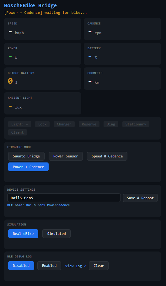

      The problem: why an ESP32 is needed
      Bosch eBikes broadcast live data over BLE using their proprietary Live Data Interface (LDI) protocol (a protobuf-encoded stream over a custom service UUID). Suunto watches don’t natively speak this protocol — they have no built-in way to connect to a Bosch drive unit and decode its data.
      The only way to bridge the gap today is with a small piece of hardware in between. I used an ESP32 microcontroller (~€5–10) that acts as a transparent proxy: it connects to the bike as an LDI client, then re-exposes the same data stream as an LDI server that the Suunto can read through a SuuntoPlus app.
      It works, but it means carrying an extra device on the bike. A small ESP32 dev board fits neatly zip-tied to the frame, powered from a USB power bank.

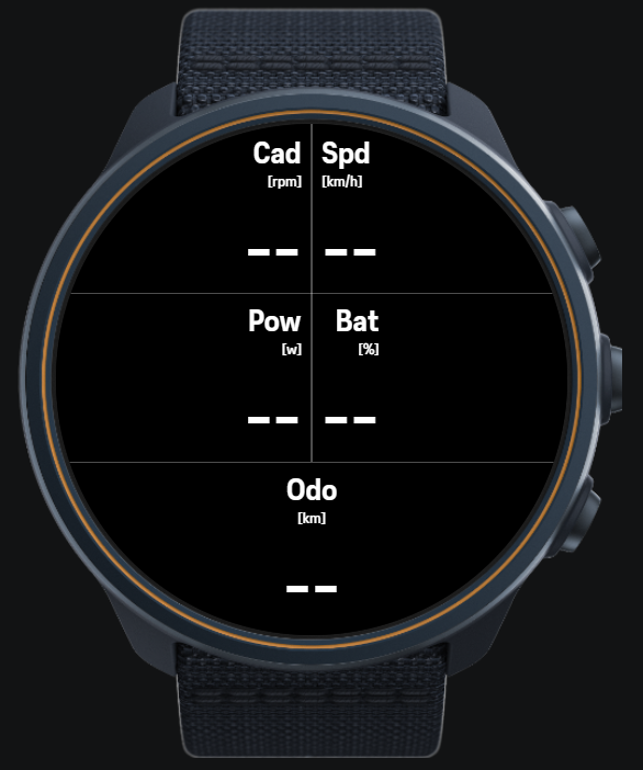

      A SuuntoPlus app that shows in real time:
      Cadence rpm
      Speed km/h
      Motor power W
      Battery %
      Odometer km
      Post-workout summary includes max and average cadence and power.
      What you need
      A Bosch eBike with smart system and latest firmware from May 1st 2026
      Any ESP32-WROOM-32 board (~€5–10)
      A Suunto watch with SuuntoPlus support (Race, Race S, Vertical, 9 Peak Pro, …)
      VS Code + PlatformIO (for the ESP32) and the SuuntoPlus Editor extension (for the watch app)
