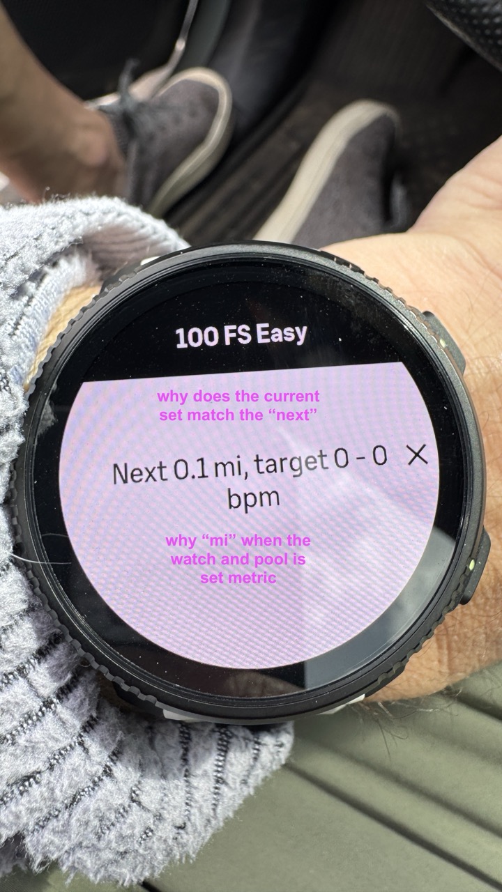

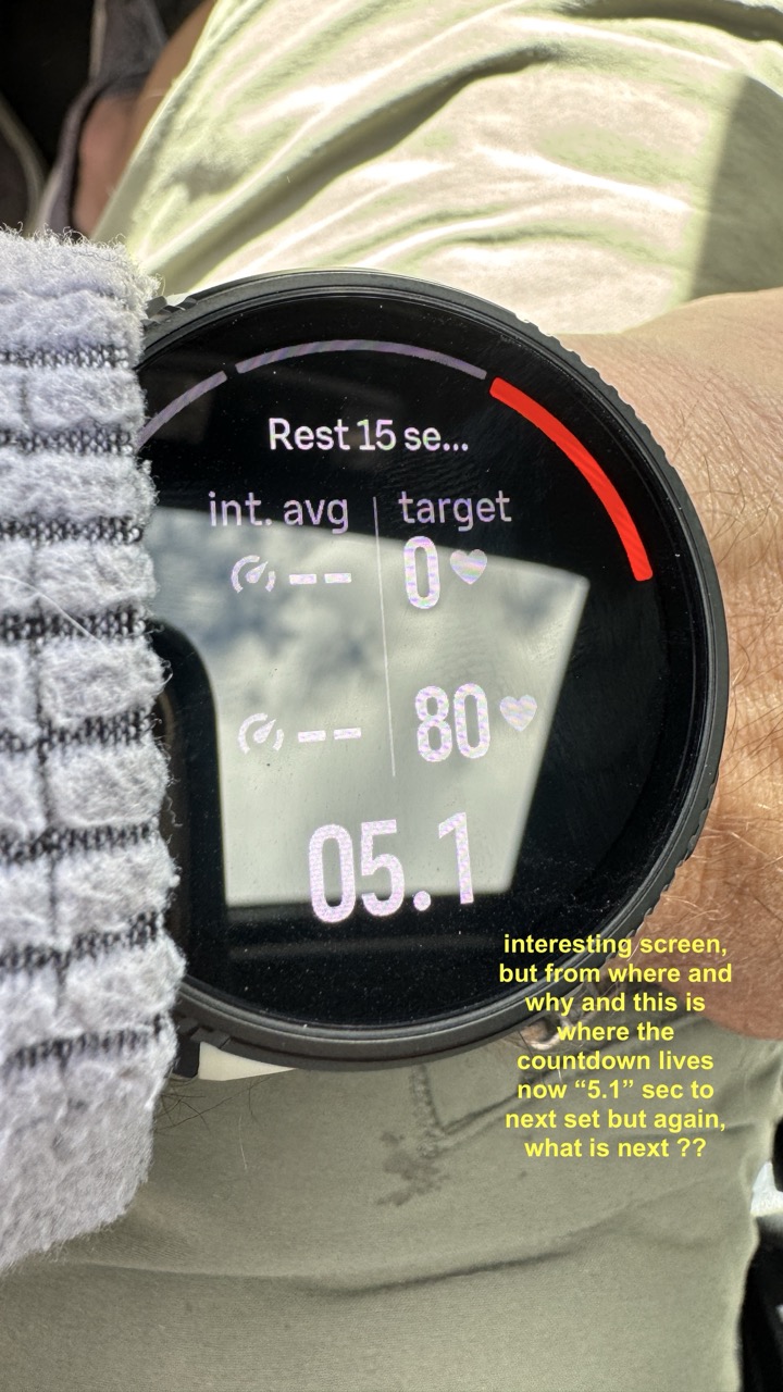

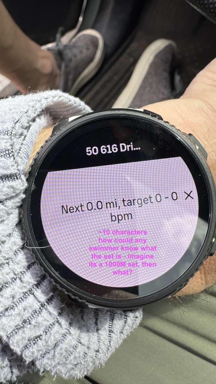

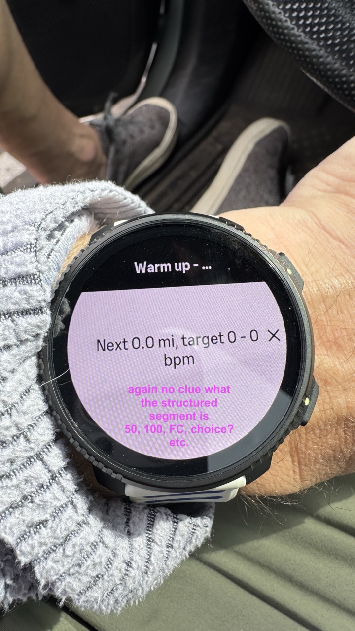

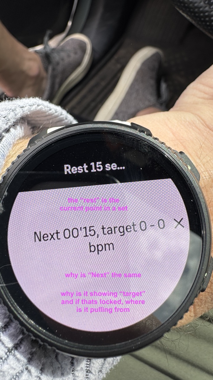

      So that’s the clickbait, thx for reading. But (lotsa 'buts in this post), honestly, I just swapped out my Garmin Epix2 and jumped on the Suunto wagon after the Q1 release announcements about swimming.
      As far as I can find, there are little to no details on how ‘pool’ swimming works and how it could work with structured training workloads from - let’s say - TrainingPeaks.
      The manual lap button update = amazing, but honestly - table stakes
      The connection to TrainingPeaks = amazing, but honestly - table stakes
      2 major tick boxes.
      But… help my ignorance or simple oversight.
      A structured workout ( especially in a pool) works when you know that during a rest, say 15, 20 seconds, you know what’s up next. So you can prepare for it. I was able to find a countdown to the next set, but the ‘what’ is a mystery (see pics 1-2)
      The repetition of the current segment on a set (e.g., 15 sec rest) is clear, but why is it duplicated in the ‘next’ detail, and why, when set to metric, does “.01 mile” appear? Suunto, does anyone swim in Finland, whats up here?
      FWIW, Garmin really nailed the data screens for swimming. I respect that Suunto is otw to get there, but please, Suunto smart people, clue me into what I am missing. I’d love to find out I’m totally off base and the simple capabilities are there, I’m just the noob missing them:
      1: current interval time (yes) + current interval distance (yes) + current interval (e.g. 2/4)
      2: interval complete - rest time shows (yes) what’s next???
      3: text for current interval somewhere to know what you’re currently swimming (yes, maybe, but limited ot 10 characters on top of the screen?)
      Just pretend you could set the screens to start with that. Help pleaseIMG_0956 Large.jpeg IMG_0954 Large.jpeg IMG_0957 Large.jpeg IMG_0959 Large.jpeg IMG_0952 Large.jpeg ?
      Ars VitaeA EgikaE E 3 Replies Last reply Reply Quote 2

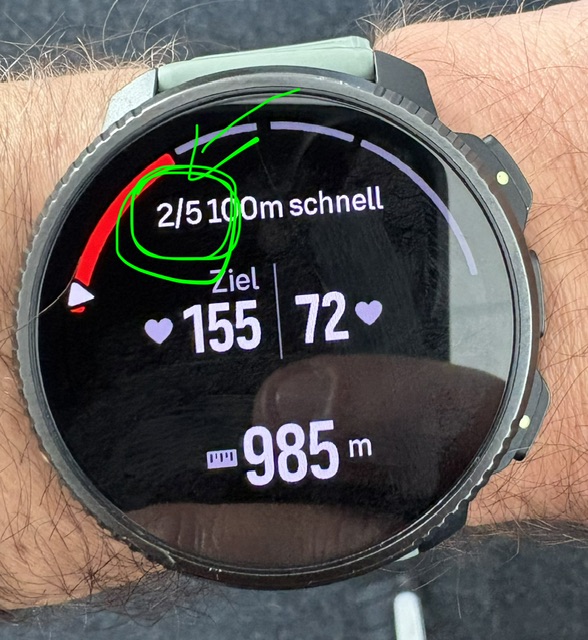

            @Webby-Skymaster which screen with the “next” is this?
            Is it synced from another software? Does it maybe depend on the api used for syncing?
            Sorry, just guessing here as I have not seen those screens before

              @Webby-Skymaster The issue with these screens is not only for swimmers, the whole structured workout thing is bad for even basic interval running, and i can’t understand how this was deemed “sufficient” when developed.
              Even, I, a complete newbie to sport smartwatches, and , at the time, a complete newbie to “training” , immediately had the same remarks as you the first time I used it.
              Like you said, but for running :
              • You have no way of knowing what’s next
              • you don’t know how many reps you are in (for example in 10 times x30sec, its nice to know if you are on repeat 8 or 9…)
              • and the fields are way, way too small and even the text is too small to be usable while doing HIIT.
              EgikaE 1 Reply Last reply Reply Quote 3

                @Elipsus I do have the number of repetition in the structured workout.
                Also when I create one, the character number is limited to what actually fits on the screen.
                So I suspect the screens in the first post here are from some 3rd party…?

                    The screens I shared are what was presented to me.
                    No 3rd party or personal alterations.
                    The structured workout was synced from TrainingPeaks.
                    What I struggle with is that the sport is designed for intervals (I do hear the noise re. intervals with Sunnto), but I’m surprised that the bugs or issues here are so glaring. The ‘next’ would be to have simple QA testing scripts, usually written by a product owner or segment owner who understands the sport.
                    My question really is: why is ‘next’ presenting ‘now’ as duplicating information, and why is the interval-defined step lost?
                    All in all, I get the challenges with this. I’ll just swim with my Garnin and train all other sports with my V2. I’m a fan boy. Just hate laziness when it comes to product specifications that clearly has/had a roadmap and implementation plan.
