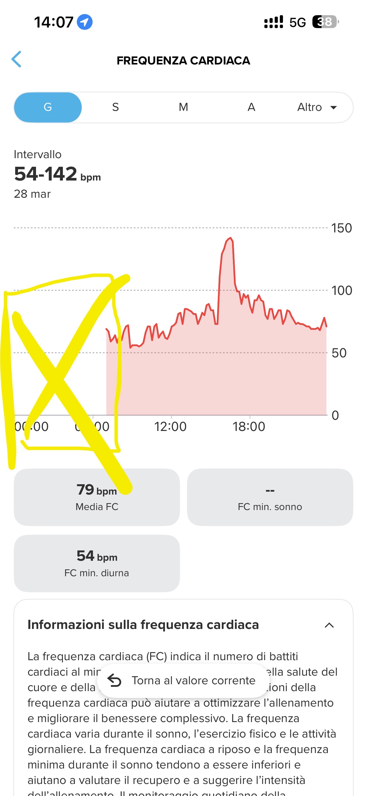

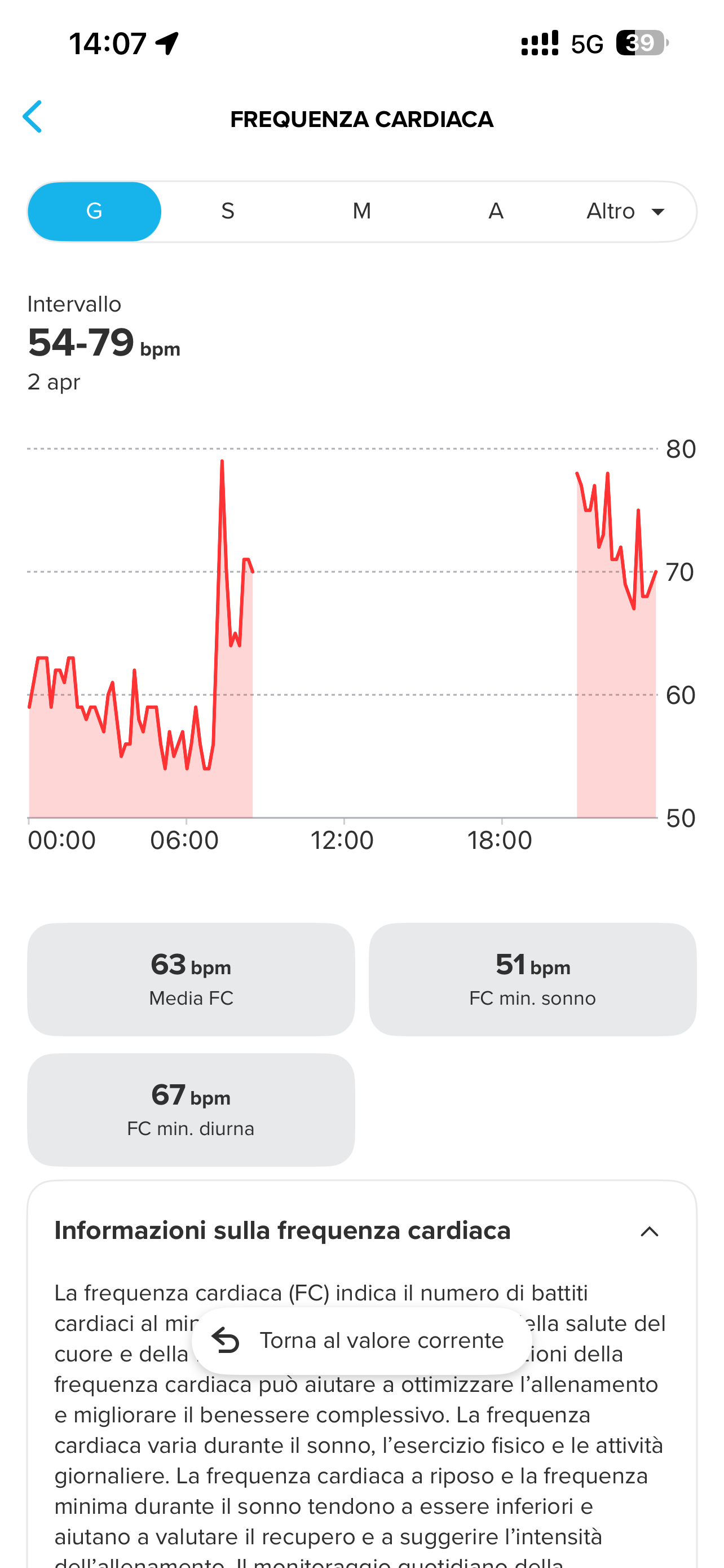

          @BrunoH sensor crash:
          Vertical 2 v2.56.18
          Manuel ExtremeM 1 Reply Last reply Reply Quote 1

            I have been studying, testing, and comparing optical sensors for 10 years. I know very well how they work and I understand the difference between a malfunction and a reading error.
            I did not report a reading error. I did not report suboptimal conditions. I did not report inaccurate heart rate readings.
            This report is about a crash/shutdown at rest without any clear reason. The sensor suddenly turns off without warning, even though the conditions in which it was previously working have not changed.

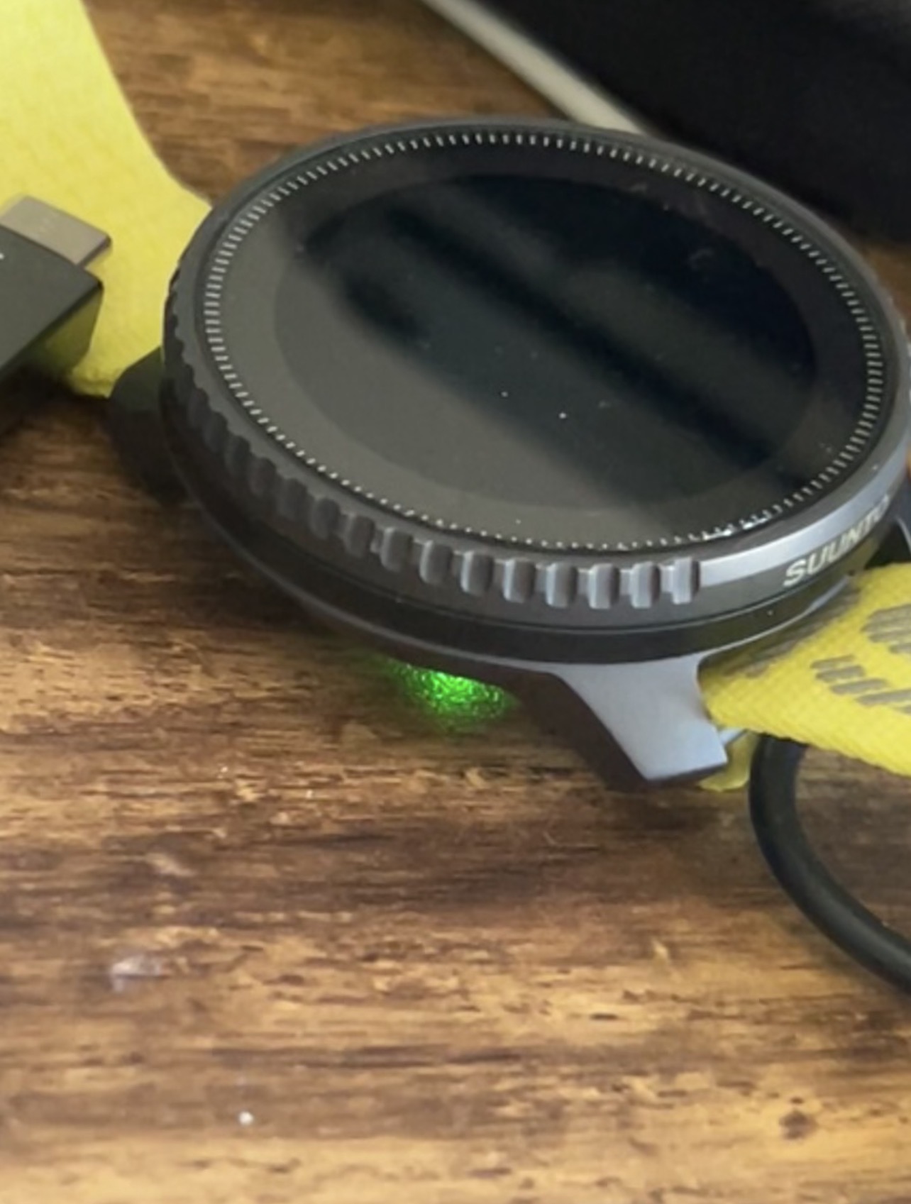

                    @Manuel-Extreme off wrist detection is not contact based, but somehow optical.
                    From here on I have no more ideas, sorry.

                      This is the Vertical 1 sensor: it has been like this for 4 hours and has never turned off.
                      The Vertical 2 sensor: if it reads the signal incorrectly for 10 seconds, it shuts down until you intervene manually.
                      There’s no point in downvoting (-1) every time I report the issue. I will keep doing it until it’s resolved.

                        @Manuel-Extreme this will not just be “resolved”
                        Try placing your watch on a white/black/glossy/matte/etc surface and you will notice different behavior.
                        In your example the watch thinks it is on your wrist and trying hard to detect your pulse ☺️
