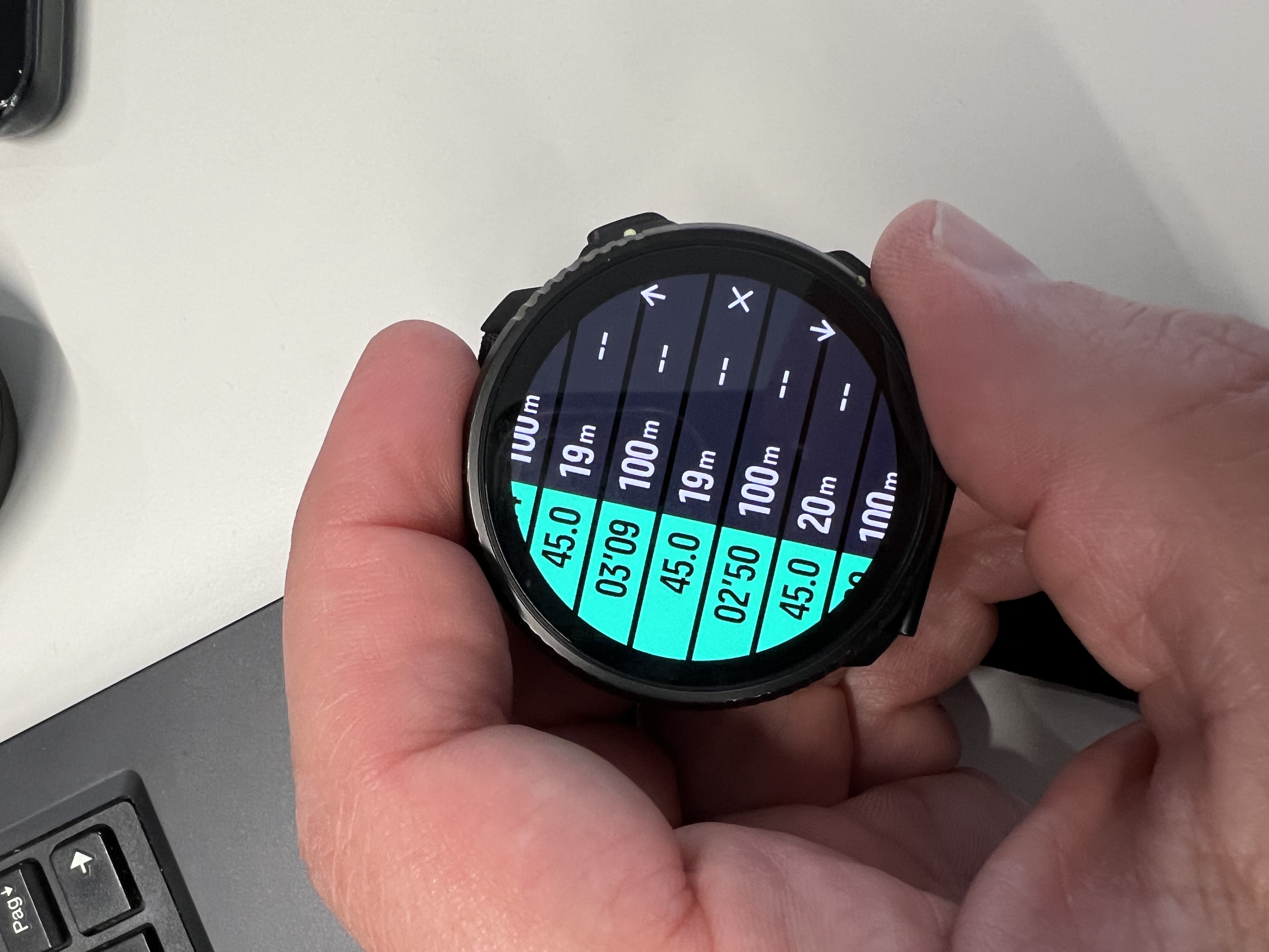

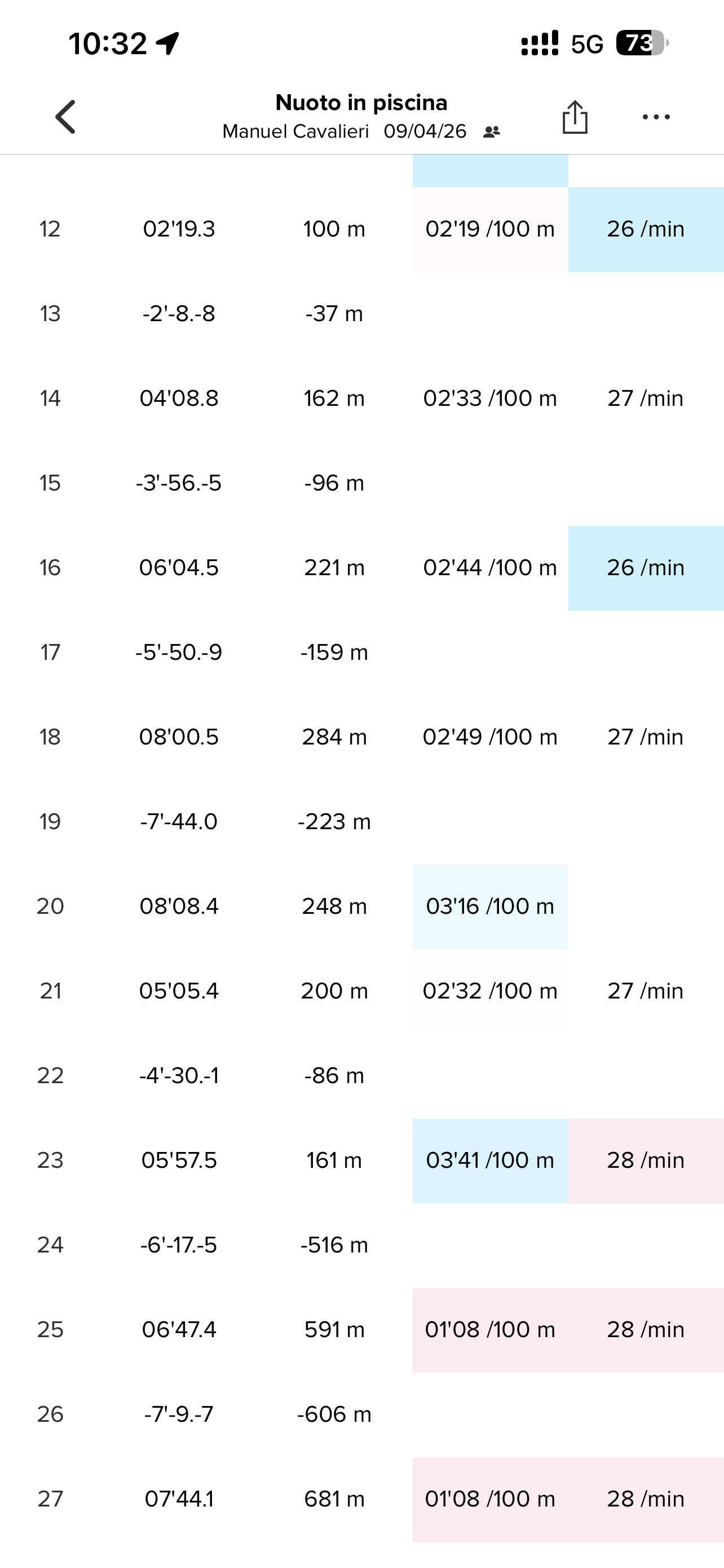

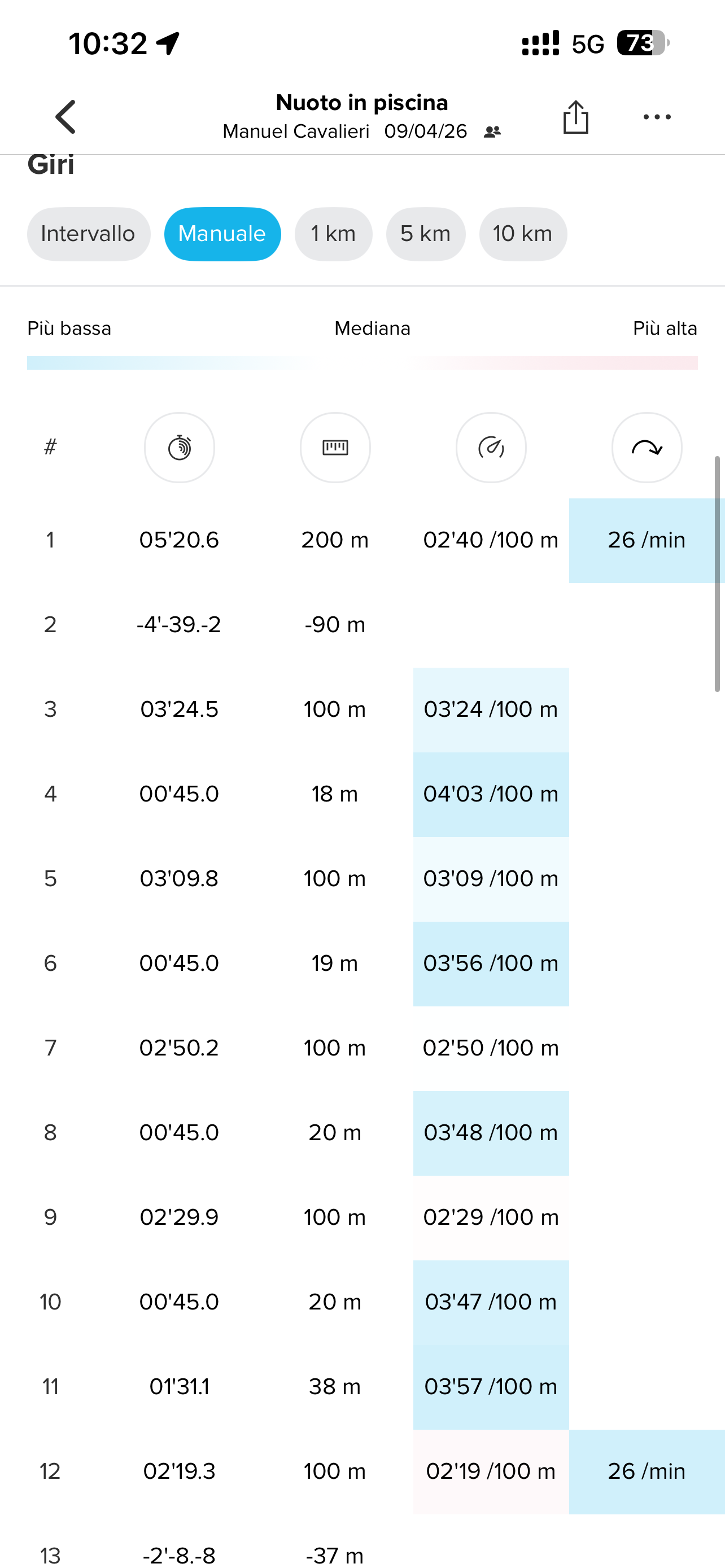

      [Suunto Vertical 2 - 2.53.43] Pool swim laps incorrect and inconsistent between watch and app (TrainingPeaks and Suunto Guides structured workouts)
      Description
      During pool swimming activities with structured workouts (TrainingPeaks and Suunto Guides), the laps detected by the device are incorrect. Lap distance and duration are inconsistent and do not match the actual intervals performed. Additionally, lap data shown on the watch differs from the data displayed in the Suunto App.
      Reproducible steps (if applicable)
      1. Start a pool swimming activity
      2. Load a structured workout (TrainingPeaks or Suunto Guides)
      3. Perform the workout including freestyle and drills, with automatic intervals and manual stops
      4. Save the activity and review lap data on the watch and in the Suunto App
      Expected result
      Laps should match the structured workout intervals, with correct distance and timing, and consistent data between watch and app.
      Actual result
      Laps have incorrect distance and duration and do not correspond to the actual intervals performed. Data differs between watch and Suunto App.

      • Media: foto
      Logs
      Logs 2026-04-09 10:45 (UTC+2)
      Notes
      Issue observed since January 2026.
      IMG_0261.jpeg IMG_0259.png IMG_0262.jpeg IMG_0258.png 69d74f3e995526132e125c60.fit
