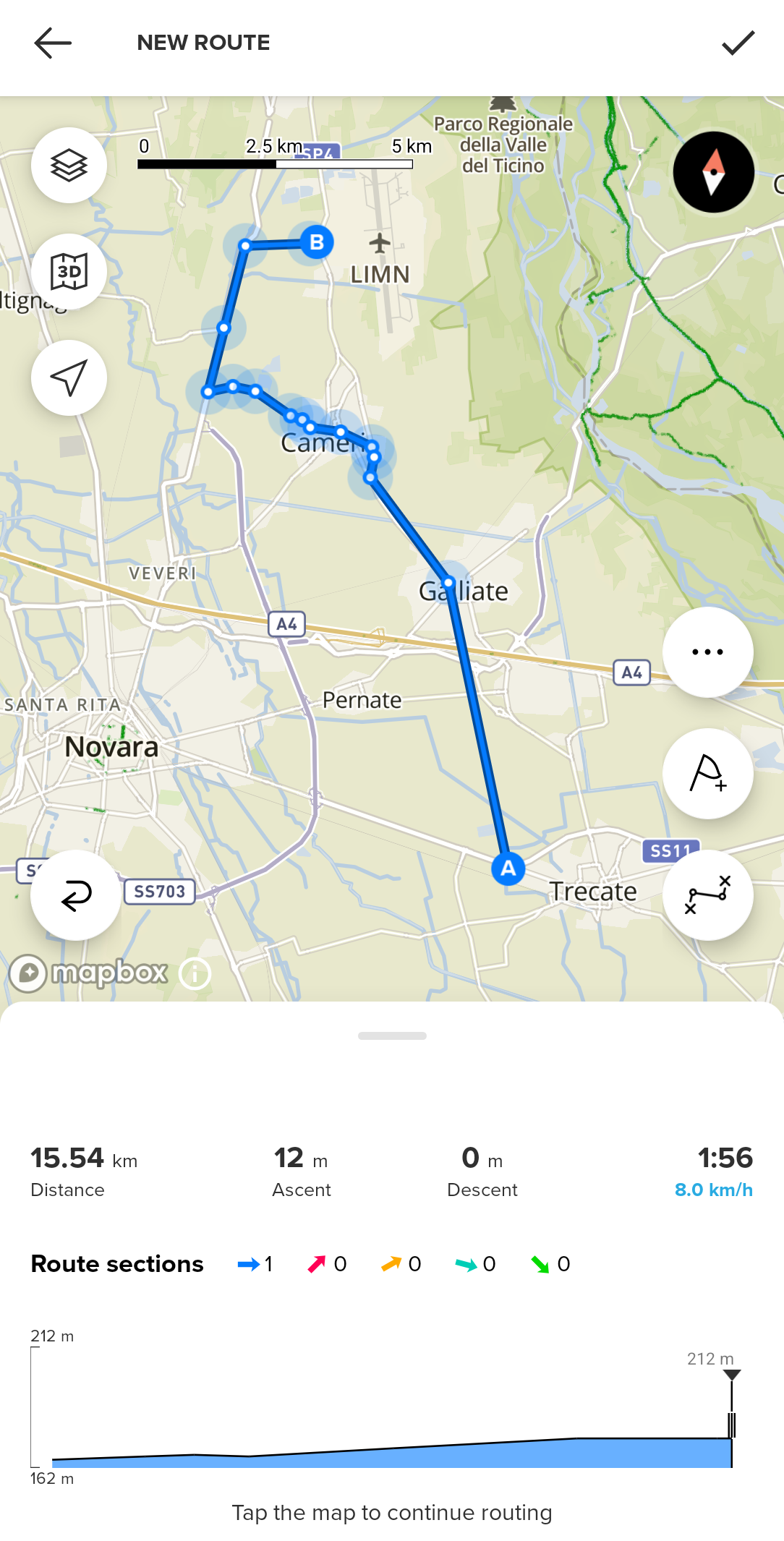

              @Brad_Olwin You can draw a route offline on the map, but only using the “Free drawing” option, i.e. just drawing straight lines by hand. A bit more time-consuming, but it can be used offline.
              But currently you need a map of the given area in the application cache.
              GiPFELKiNDG C 2 Replies Last reply Reply Quote 2

                  @GiPFELKiND The map has been in the app cache for some time. Turn on airplane mode on your phone and you’ll see that some areas you’ve recently used or saved routes in the Suunto app have maps of those areas in the app cache.
                  Of course, Suunto should have had fully usable offline maps long ago. I hope they implement this soon, as it’s a huge limitation of the entire Suunto platform.
                  I just tested a much more convenient method. The Maps. com app can generate an offline GPX file that can be opened in SuuntoApp and used on the watch—even offline. This is exactly what’s missing from SuuntoApp itself.

                      I do not what I am missing, but after creating the new route offline, as you described, ie using the “free drawing” option, the Suunto app wants me to save the newly created route before it can be followed/used, either in the app itself or be synced to the watch.
                      But when trying to save the route and pressing the button “Save”, the app shows a error message saying “No internet connection” and wont accept the “Save”, hence the new route created offline does not sync to the watch…and/or can not be used in the app for navigation.
                      What am I missing?

                          @CarlW Are you using Android phone or IPhone?
                          C 1 Reply Last reply Reply Quote 0
                          • C Offline
                            CarlW @maszop
                            @maszop
                            Iphone

                              @CarlW said in Vertical 2 syncing of routes:
                              @maszop
                              What am I missing?
                              BR
                              Carl
                              You are not missing anything. This is a big disadvantage of the iOS app at the moment.
