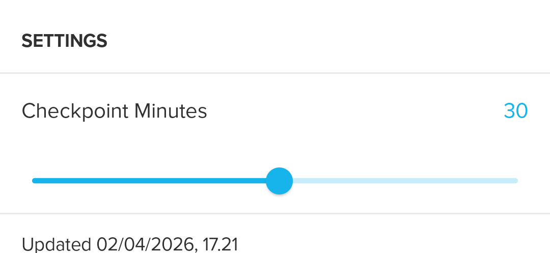

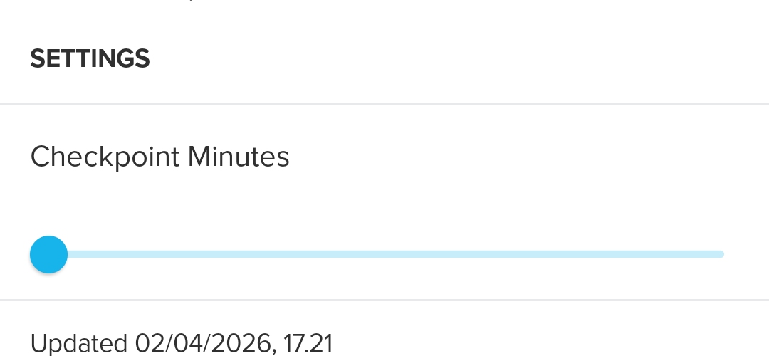

                  @harry08 At first:
                  And it allows sliding:
                  The value is null until the user touches the slider and syncs.
