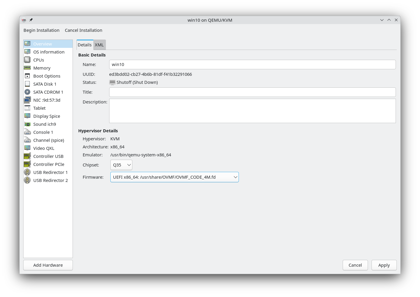

      In overview, change firmware to OMVF_CODE_4M.fd:
      Image of further configuration settings with overview selected

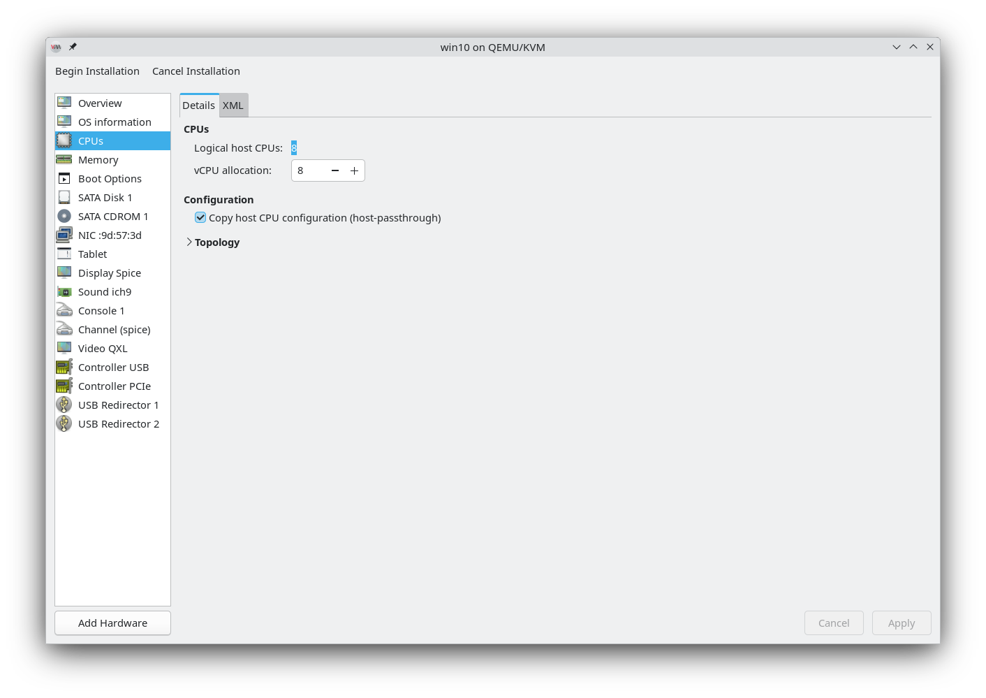

      In CPUs, make sure the host-passthrough is checked:
      Image with CPUs tab selected
