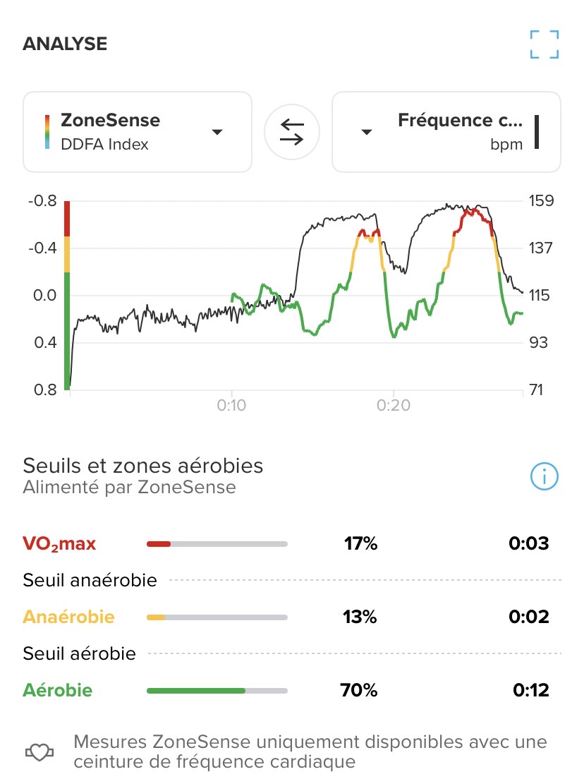

            In the areas where Zone Sense marks the curve in red (anaerobic), I was clearly in zone 3. I could count or recite the alphabet without any trouble, yet the watch showed me at the absolute limit of the red zone.

              @Dieter1960 VO2M in ZoneSense VO2M spans from your LT to your max, so potentially a large range. You could be right at LT with red ZoneSense and would be able to say a few words.

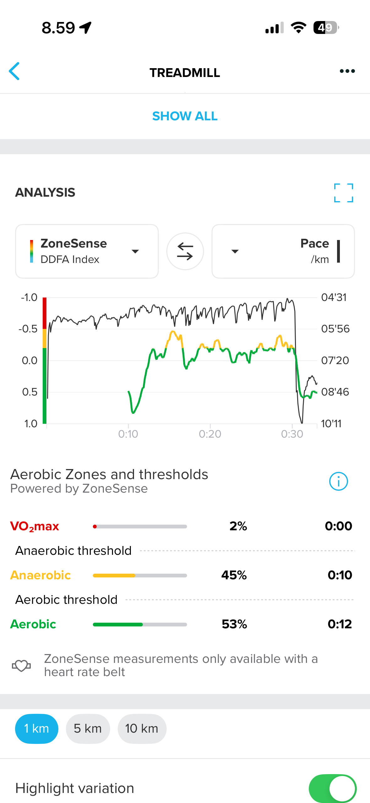

                    Another strange ZS chart from my yesterday’s 30 min treadmill run. First a 10 min warmup on 8, then gradual increase to 13. Somehow ZS claims that running at 5:29 is more challenging for me that at 04:46. Also a 2% VO2max effort? 🙀 While the chart is not even touching that zone…

                      @cheetah694 ZoneSense isn’t aware of your speed, effort you put in, not even your current heart rate. It applies statistical calculations on a series of your individual beat-to-beat intervals (time between subsequent beats of your heart). If the statistics show a certain pattern, ZS will show you the respective zone. So its accuracy depends on, in addition to the applied algorithm, the quality of the data received from the HR belt, and your individual physiology.
