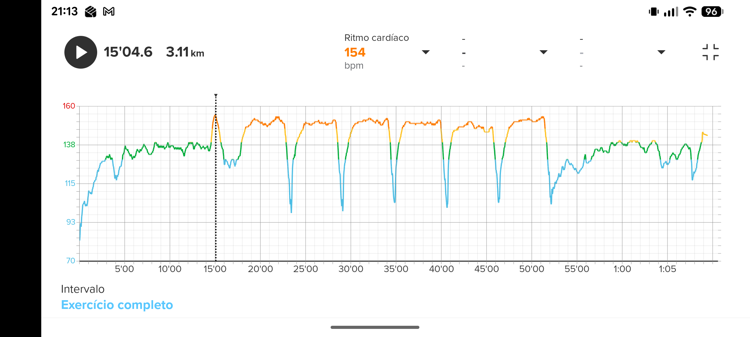

      @Henrik-Nilsson they gave me a predefined answer with the usual stuff… It’s strange how a bug of this magnitude does makes them more proactive to solve it.

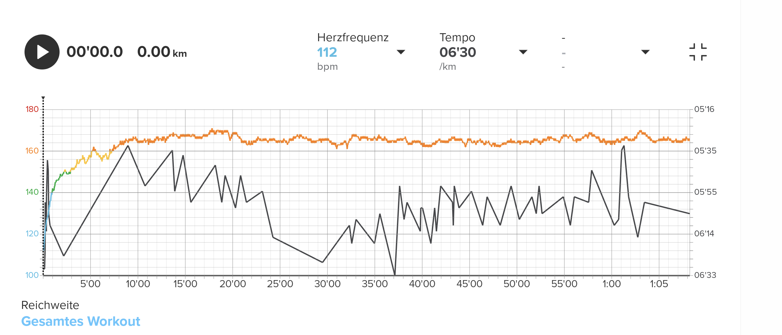

                  Update - factory reset did not help as well, same behavior than before. Pairing the sensor was possible after three tries, starting the training also needed two tries until the sensor was detected. Then the heart rate was measured for some time until the connection dropped. Came back after some minutes, dropped again and so on. In the end, my 5k @ 5.34/km was rated a recovery run. Definitely had nothing to do with strap contacts being too dry (28°C… definitely enough sweat).
                  Interestingly, also the speed reading is quite “staggered”, this was not the case before the sensor problem occurred (the graph was much smoother).

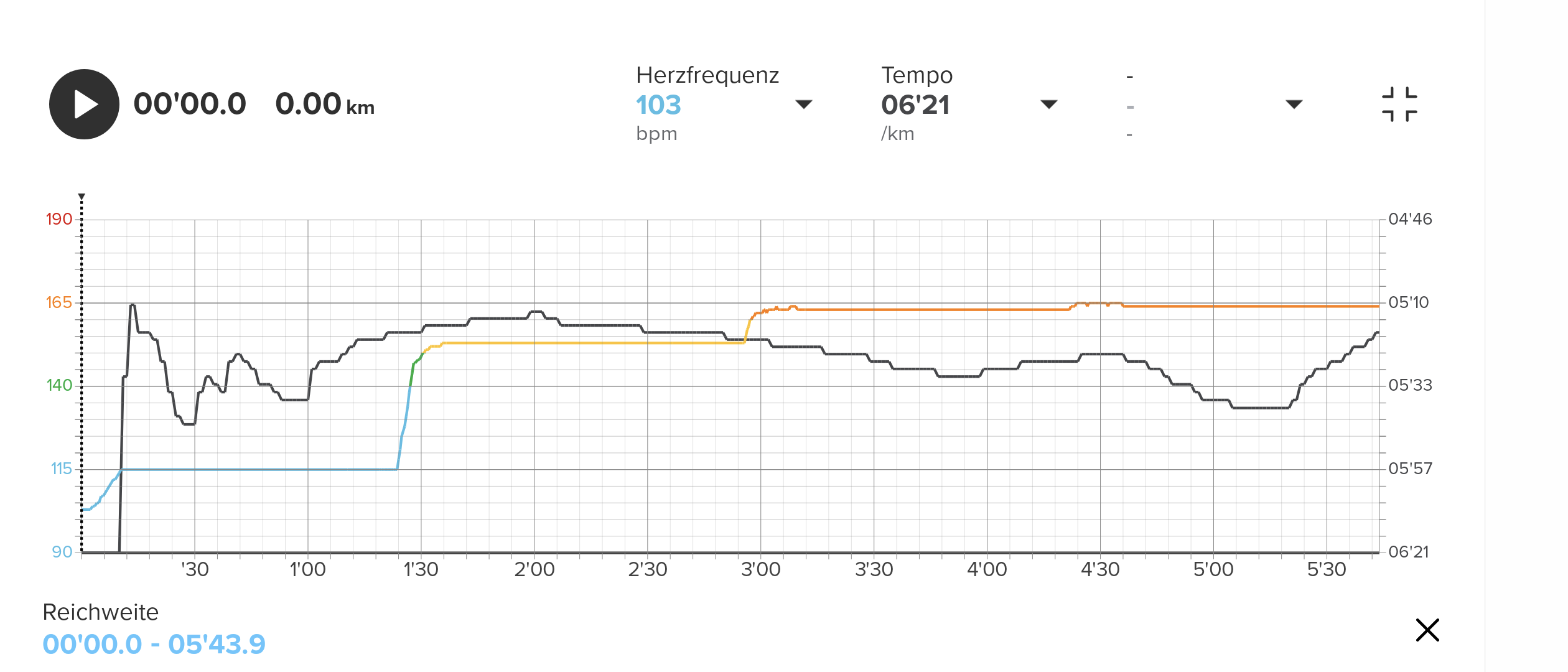

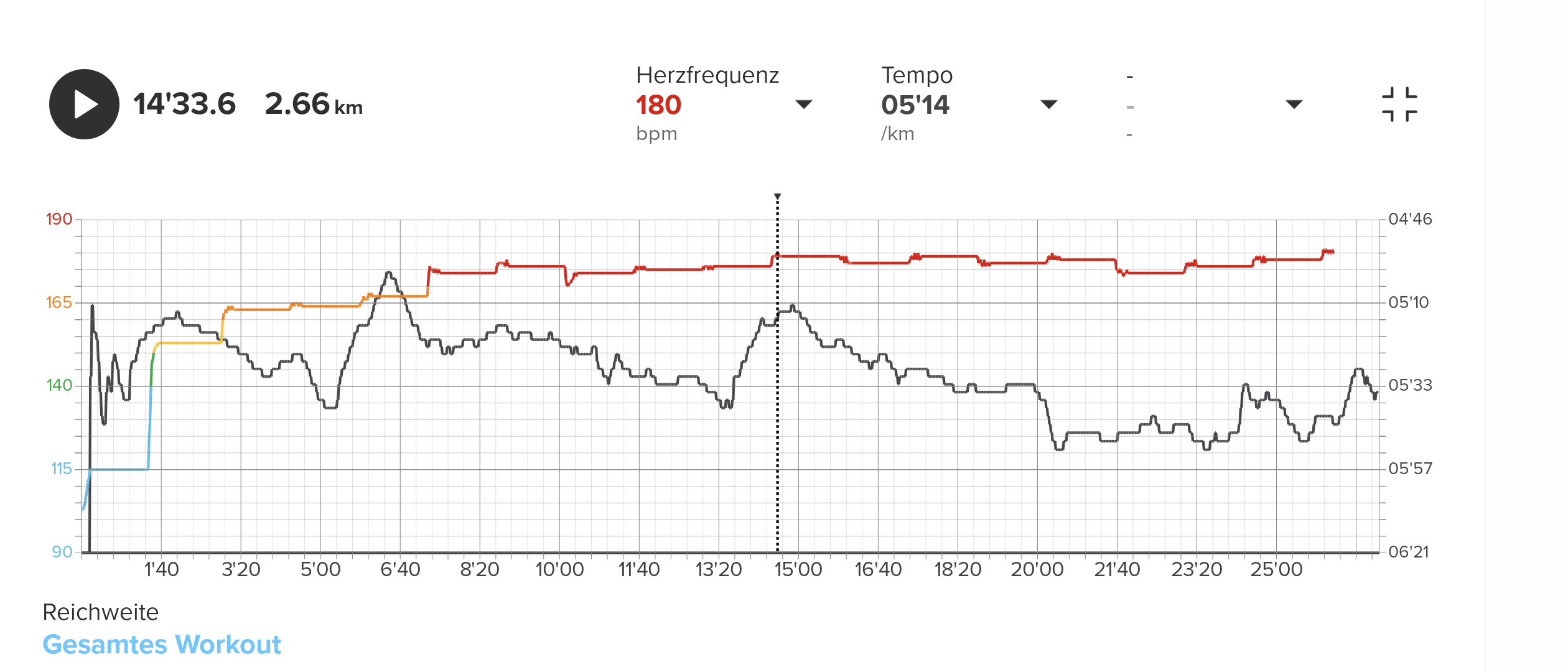

                  I saw that speed sampling problem before, though:
                  And it used to be good for the first few months since I used the Suunto:
                  Since the strap is brand new, it’s either the sensor itself which does not transmit, or the watch is not able to handle the BT connection. Hard to find out, though, without having an alternative sensor.
