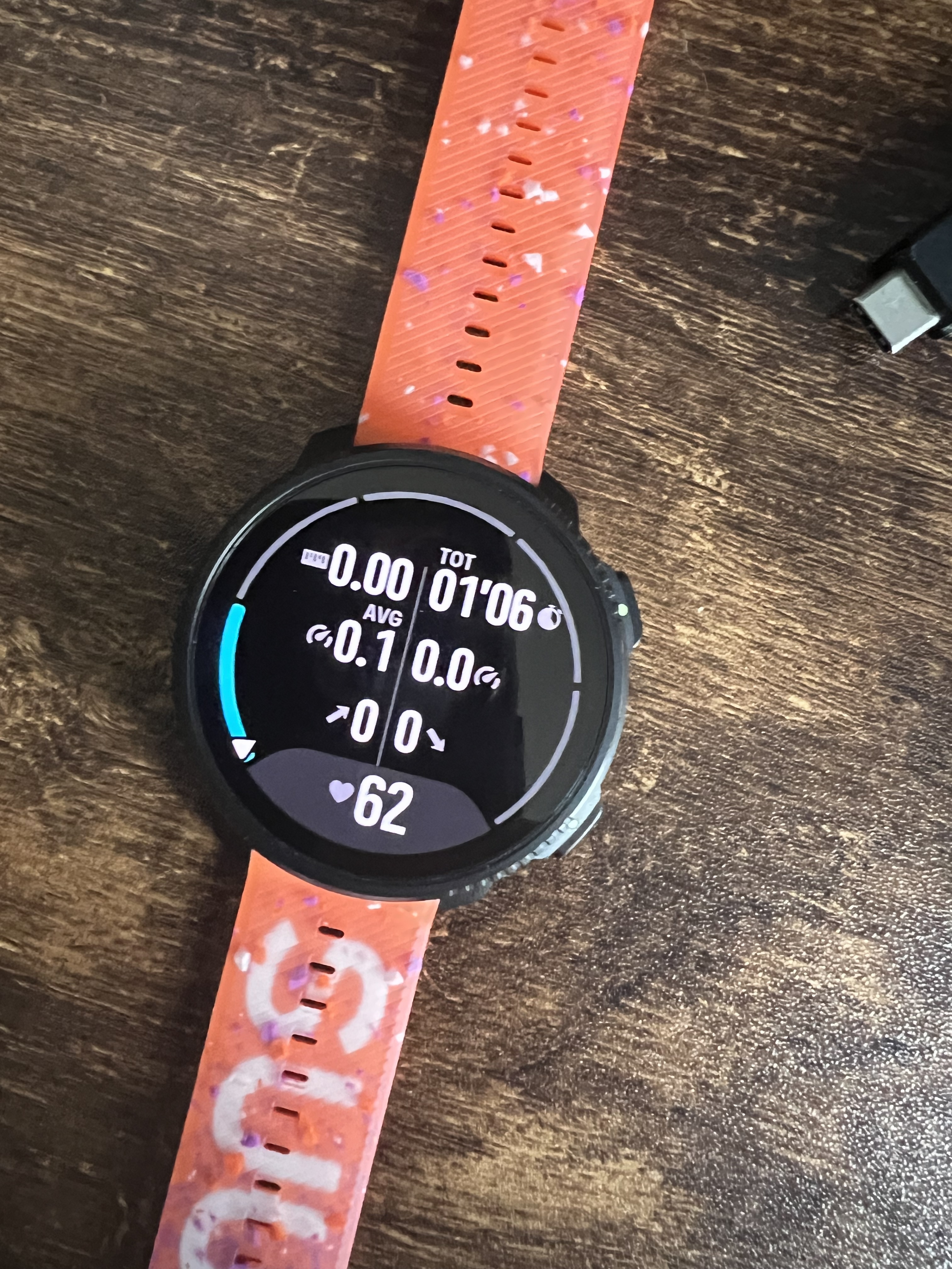

        @Gliko-Fashionista can you check if you have in the very top row a field which is displaying two lines of text? If yes, try to change it something which has just one line and see if time is shown. For example:

          In mine too:
          Vertical 2 v2.53.42
          M OutdoorManO 2 Replies Last reply Reply Quote 0
          • M Offline
            maszop Bronze Member @Manuel Extreme
            @Manuel-Extreme You can see that you have text displayed on the top line. Change it to a value without such text above the numbers, and the time will be displayed. This has already been discussed many times.
            • OutdoorManO Offline
              OutdoorMan Silver Members @Manuel Extreme
              @Manuel-Extreme the text “TOT” is causing time to disappear. Switch it with speed (middle right) for example and it will be displayed again.
              • Manuel ExtremeM Online
                Manuel Extreme Silver Members @OutdoorMan
                @OutdoorMan I tried using a single field on one row and the clock reappears.
                But for readability (and visual memory) I prefer to keep the fields arranged as I’ve set them.

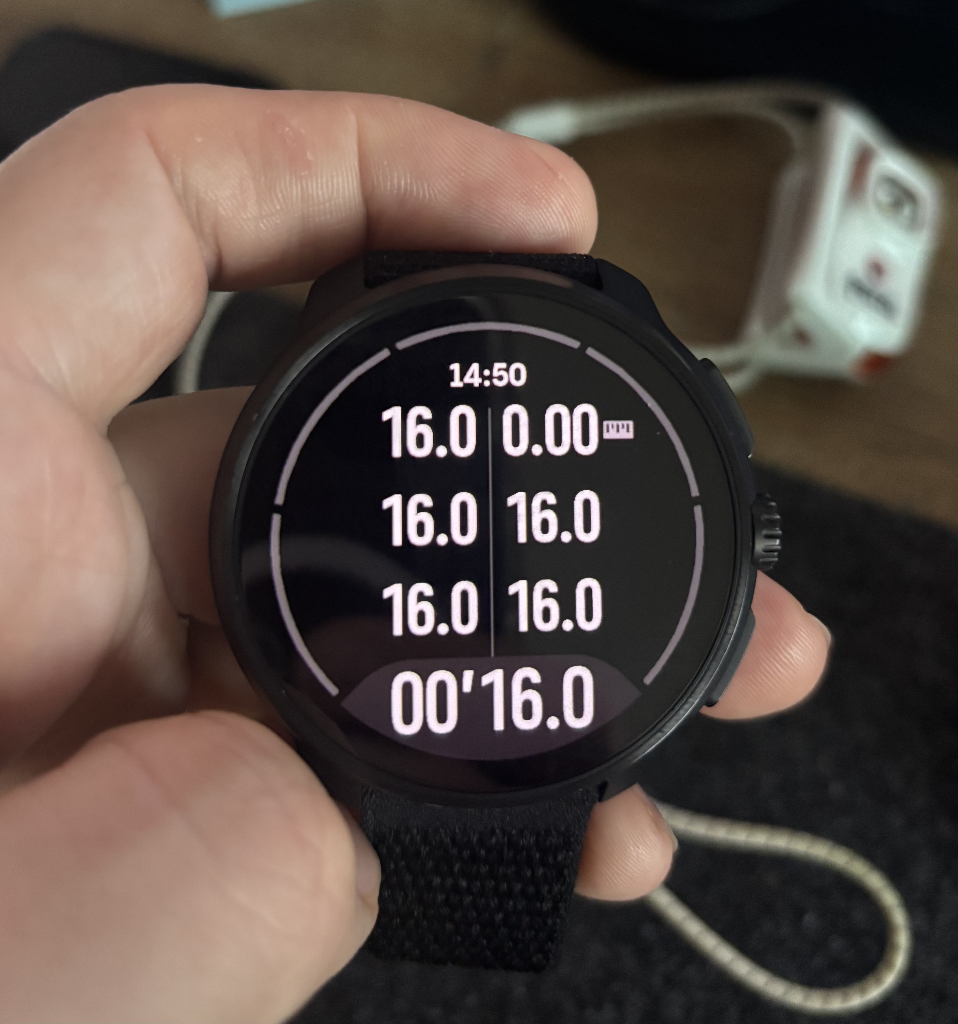

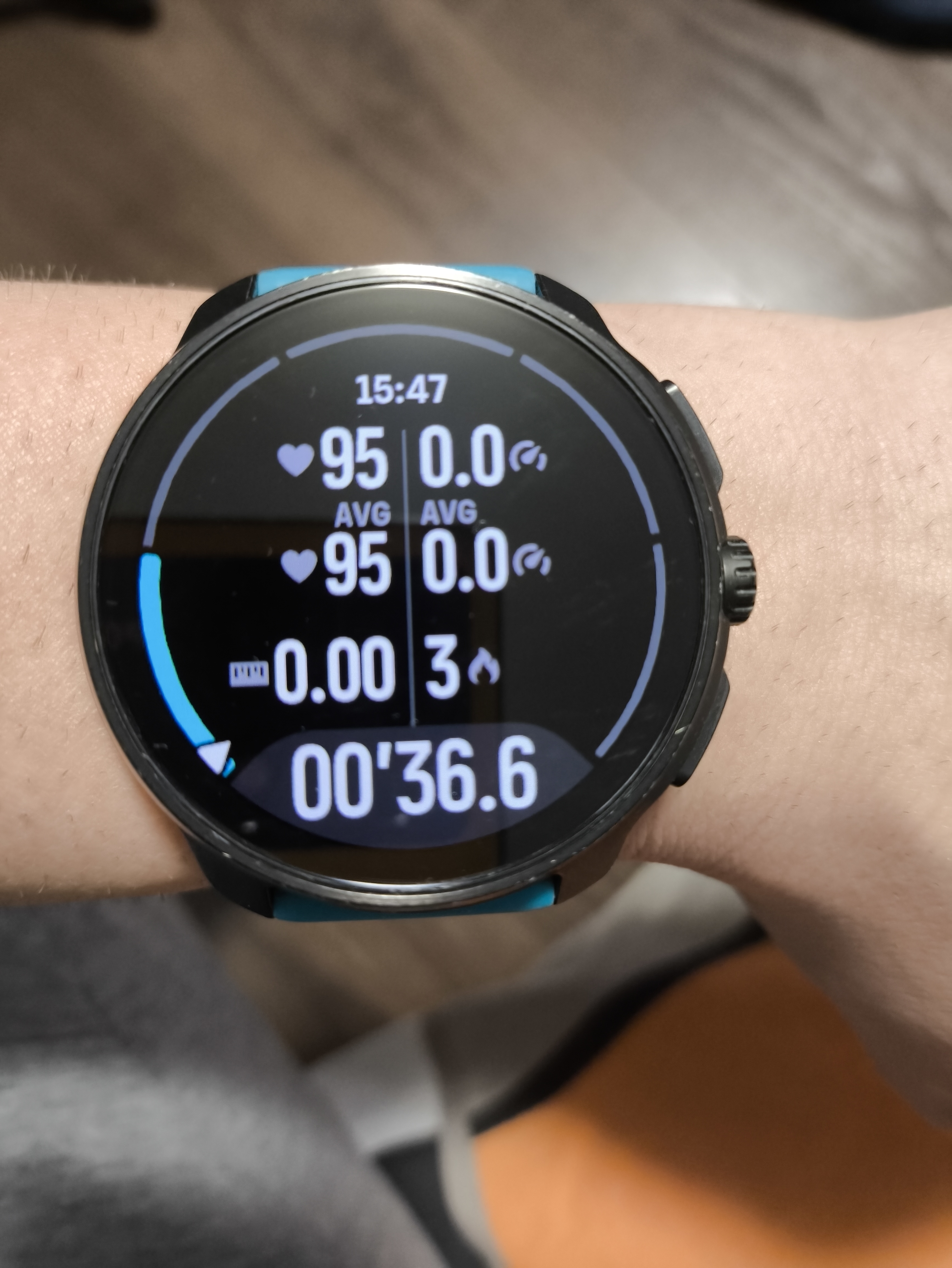

                • Tami999T Offline
                  Tami999 Silver Members @Gliko Fashionista
                  @Gliko-Fashionista said in Display 7 fields not showing time:
                  Suunto vertical 2
                  Display 7 fields not show time on the top screen. This is normal?
                  It happens if I’m not wrong if Your top fields have “average”. Average speed, average hr etc. move it lower. I know I had same problem and we figured it out here. Kinda bug or something. … change position and should work.
                  I think that when “average” is on top, “AVG” letters have problem with time and that’s why it disappear. Because they would be in same position on screen. Maybe some more “widgets” causes problem with time.
