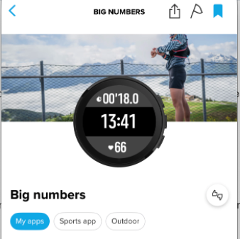

            @leehikes It uses up a SuuntoPlus slot but “Big numbers” does what it says for time of day.

                  @leehikes Have you installed the “Big numbers” SuuntoPlus app via the Suunto App watch configuration page?

                          ?? Not sure what I am saying yes to, but thought a visual of that app would be easier to identify than creating new sport profiles, I like it better than Garmin, They do not have the activity time and HR in the time.
