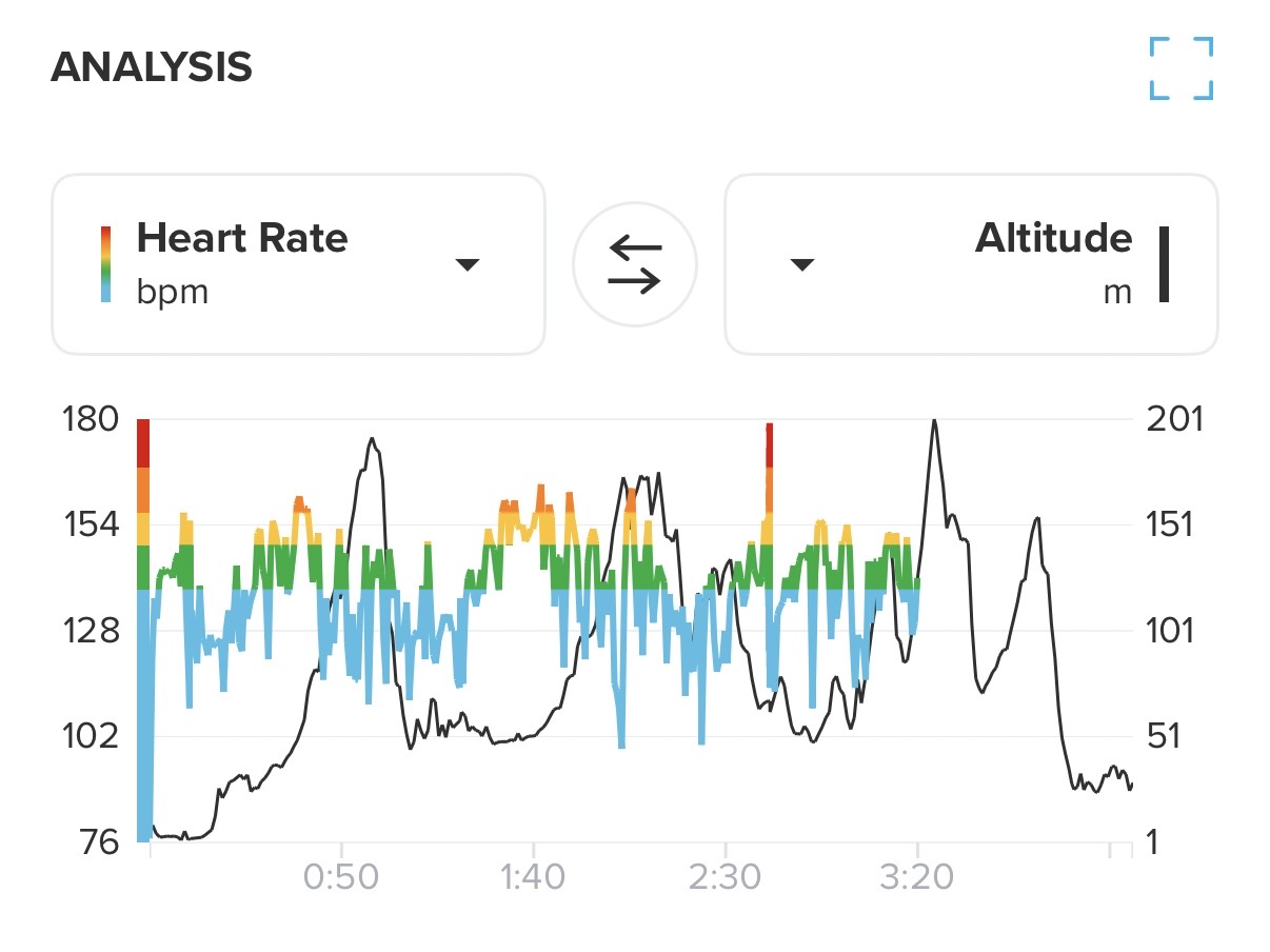

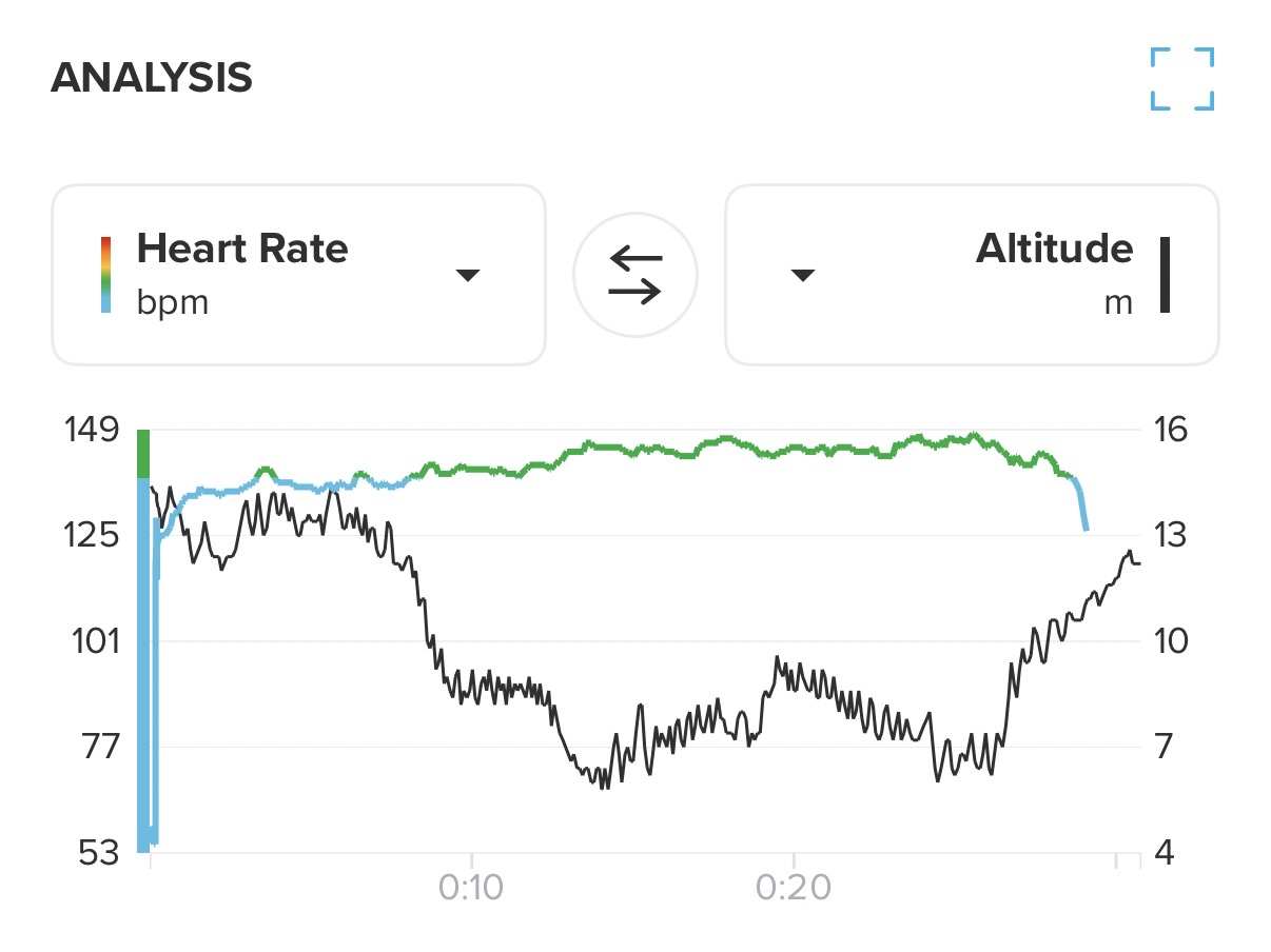

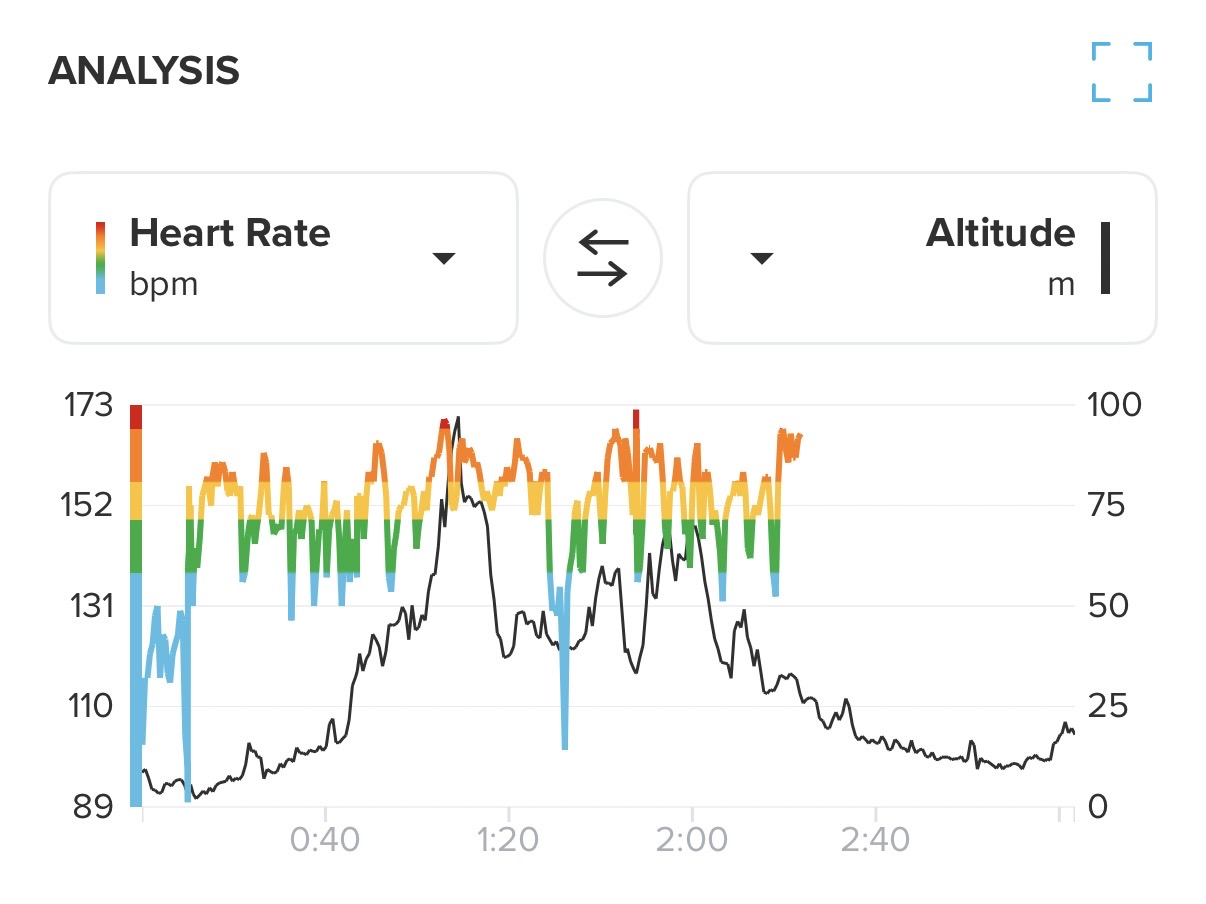

      I’ve been seeing issues where heart rate belt data just stops recording before the end of an activity. Not every time but probably like 20-30% of my rides and runs.
      You can see in the screenshots below how heart rate data just stops before the end. Sometimes it might be 5 minutes before, sometimes much longer. No specific event ties in with when it happens, it will just be seemingly random while I’m riding or running.
      I’m using a Wahoo TRACKR HR belt that was flawless with the previous watch I was using, and never has issues with my ELEMNT ROAM that I dual record to on my rides.
      I never see the belt actually disconnect from the watch. I’ve made sure it’s fully charged and have tried unpairing & repairing with the watch
      I’m curious if anyone else seeing similar behaviour using heart rate straps with their Run watch?

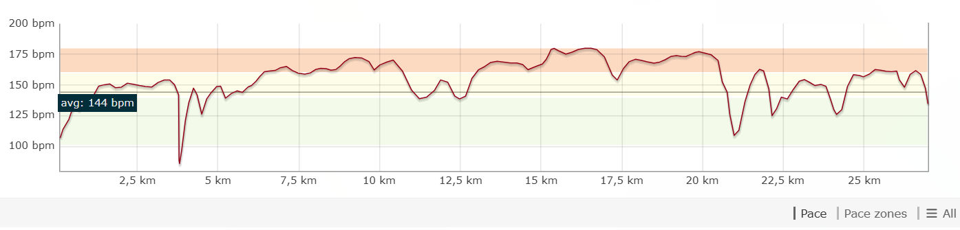

                          @Brad_Olwin right so I created a couple of Runalyze accounts and imported the Suunto Run fit file into one, and the Wahoo ROAM fit file into the other. Both were taking data from the same strap during the same activity as I dual recorded.
                          This is the ROAM activity:
                          This is the Suunto Run activity:
                          This looks really odd. It doesn’t appear that the Suunto is missing the data at the end, as the same pattern for the final 21-27km of the ROAM graph matches the 14-20km section from the Suunto graph. It looks more like the 4-11km section from the ROAM is missing from the Suunto graph.
                          Brad_OlwinB 1 Reply Last reply Reply Quote 0

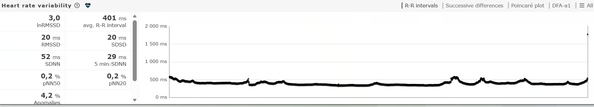

                            @owend Check the R-R data not HR, the HR is calculated from R-R. You will be able to see how noisy the R-R data are.
                            Vector/T6c/Ambit 3 Peak/S5 Copper/S3/S7 Ti/S9 baro Ti/S9P Ti/S9PP Ti/Vertical Ti/Race Ti/RaceS/Ocean/Wing/Race2Ti
                            O 1 Reply Last reply Reply Quote 0
                            • O Online
                              owend Bronze Member @Brad_Olwin
                              @Brad_Olwin ok this is what that graph shows for the Suunto activity. I don’t see the same graph on the Wahoo ROAM fit file:
                              • Brad_OlwinB Offline
                                Brad_Olwin Moderator @owend
                                @owend looks good

                                    @Hari-Seldon yeah it’s really odd. I’ve reported it to support and given them fit files from my Suunto and Wahoo ROAM for them to compare. On this mornings ride, I checked my Suunto screen every 15-20 mins and it always matched what I saw on my Wahoo screen, right up to the end of the ride. However the synced activity once I’d finished, is missing hr data for the last 50 mins. Which leads me to think it’s more an issue with the watch writing the data to the fit file than any potential connectivity issue with the hr strap.

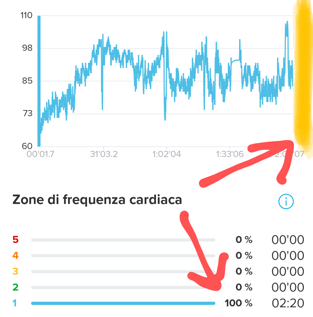

                                      @owend It was a recovery session spent entirely in Z1 and I noticed that the time reported in Zone 1 corresponds to the total time of the session, so it seems to be just a “graphic” problem
