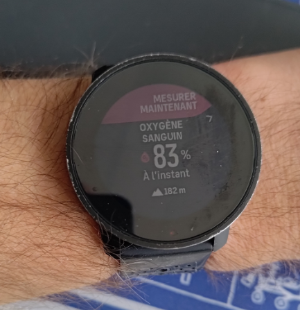

                        I will reply to myself, since my last post saying that I got bad ox saturation got downvoted, I understand there is some distrust in my claim, i re-enabled the widget (that I removed because the last time I used it my watch rebooted itself…).
                        Here is two SpO2 measurement taken back to back in good conditions, using the original silicon wristband, showing levels that should have taken me to a hospital (i’m fine)
