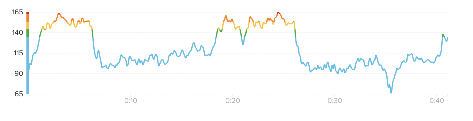

            Hi, so my experience is that this is the most accurate suunto sensor, i have tried.
            in sports mode, there is (in my case) a pretty consistent pattern, the first 4-5 minutes are not that accurate, it has a hard time recognizing the first minutes HR increase.
            But withing 5 minutes, its kinda ā€œlocked onā€ and the very very good. No crazy pikes, or even worse from my previous wathces, no 10 minute lows, in a high intense workout.
            Sportsmode used this first week has been.
            Ebike commute: approx 10 times. 1 of thoose readings were bad for 6 minutes, otherwise on target
            Weight training; 3 times: a little slow to capture the first increase, but from minute 4 on target
            Crossfit: 6 times; very high intense, and all interval is recognized from the HR graph, on the second. still a few minutes before it kinda hit the correc zone.
            I would compare this as being the secong best OHR ive tried, in front of Epix 2 pro, and just behind Amazfit T-rex3

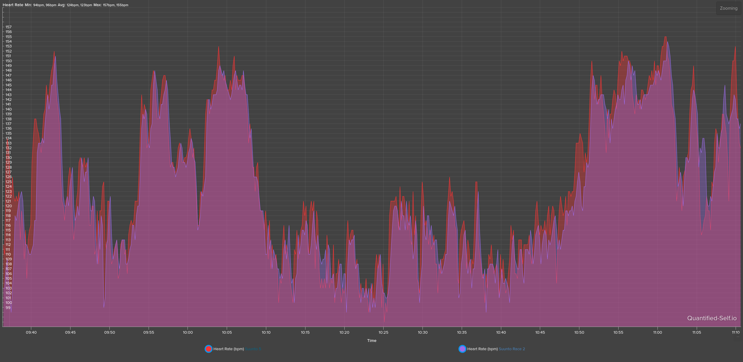

                @Tomas5 I have been testing this watch for some time. It is the only Suunto that gives me good OHR during running and similar to my Apple Watch Ultra. I am very happy with it and have the titanium version that is quite light. I can show a lot of data if you wish.

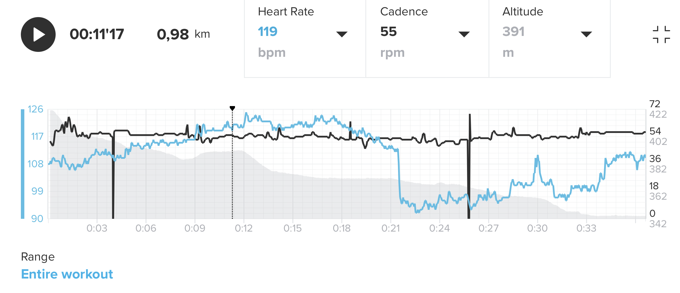

                                          Today possibly cadence lock in first half? Not sure but strange change in middle of activity while i walked same speed all the way.IMG_0893.png
