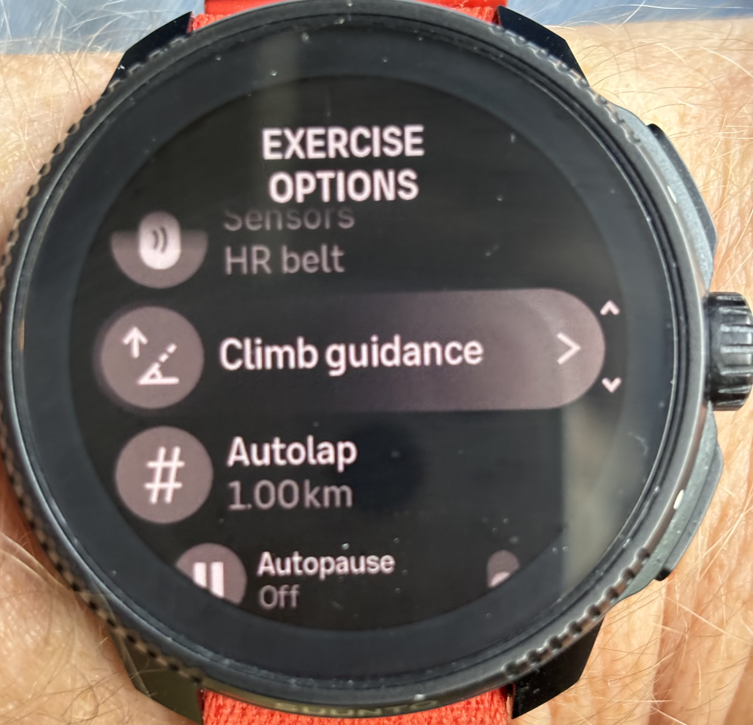

I’ve created a sport mode customization of ‘Running Basic’ and ‘Track Running’.
After that, it’s no longer possible to select intervals under ‘Exercise Options’.
Is anyone else unable to choose intervals in customized sports modes?
Exercise Options (Before/after) customization

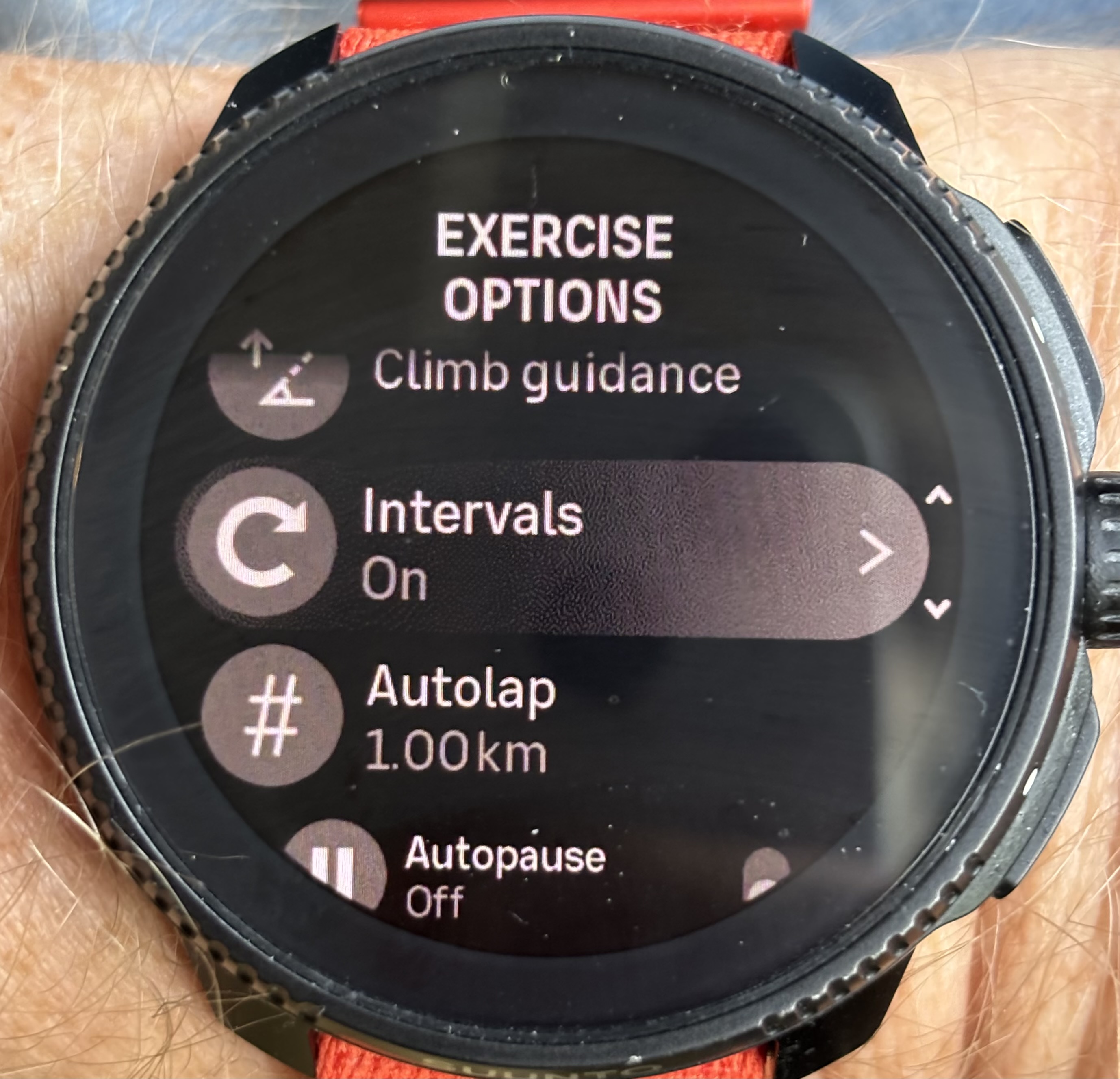

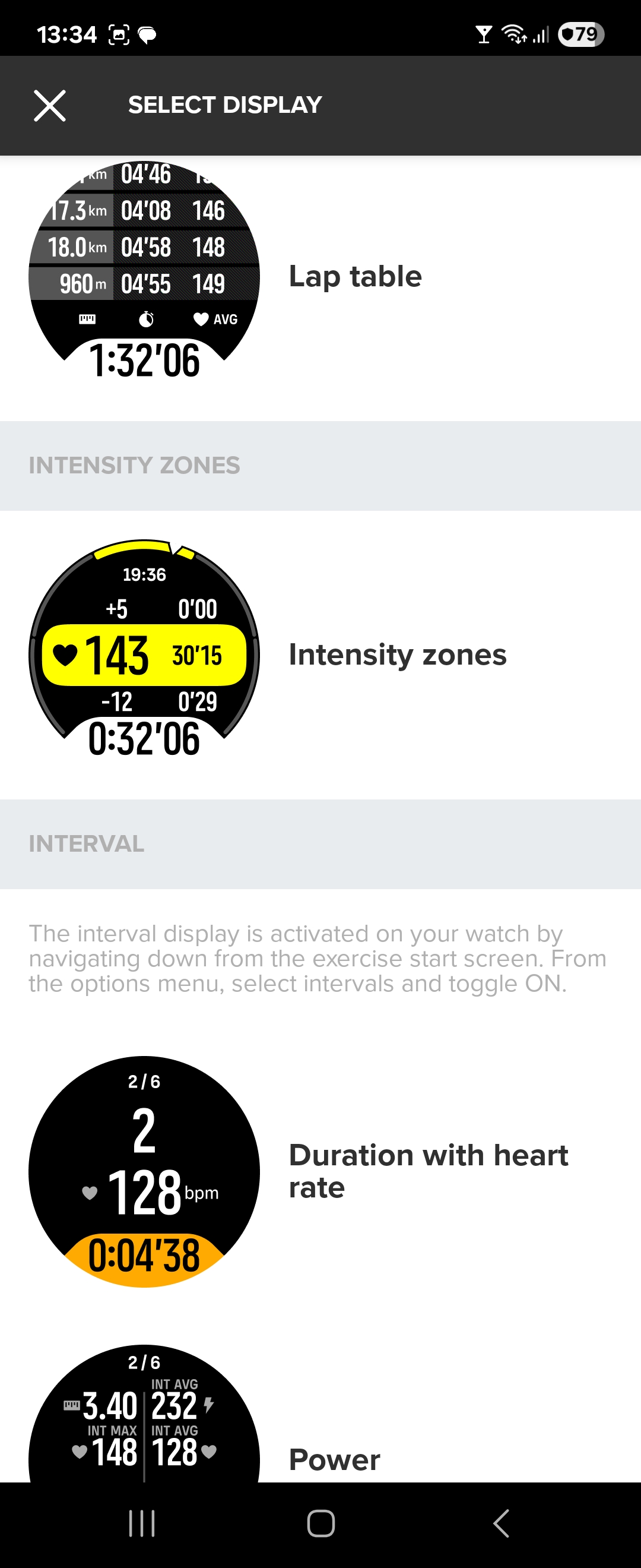

You have to change/add a data page in the Suunto App to contain an “Interval” screen. Then the custom sports mode also shows the option to toggle on “Intervals”. See the bottom half of this screenshot:
@Rayfox
You have to specifically add one of the intervals screens to your custom sport mode. So if you’ve already used the maximum number of screens for data, graphs etc, you’ll need to replace one of them.This is an example of when the very low number of screens allowed can be a significant limitation. I keep hoping that it’ll be increased at some point.
