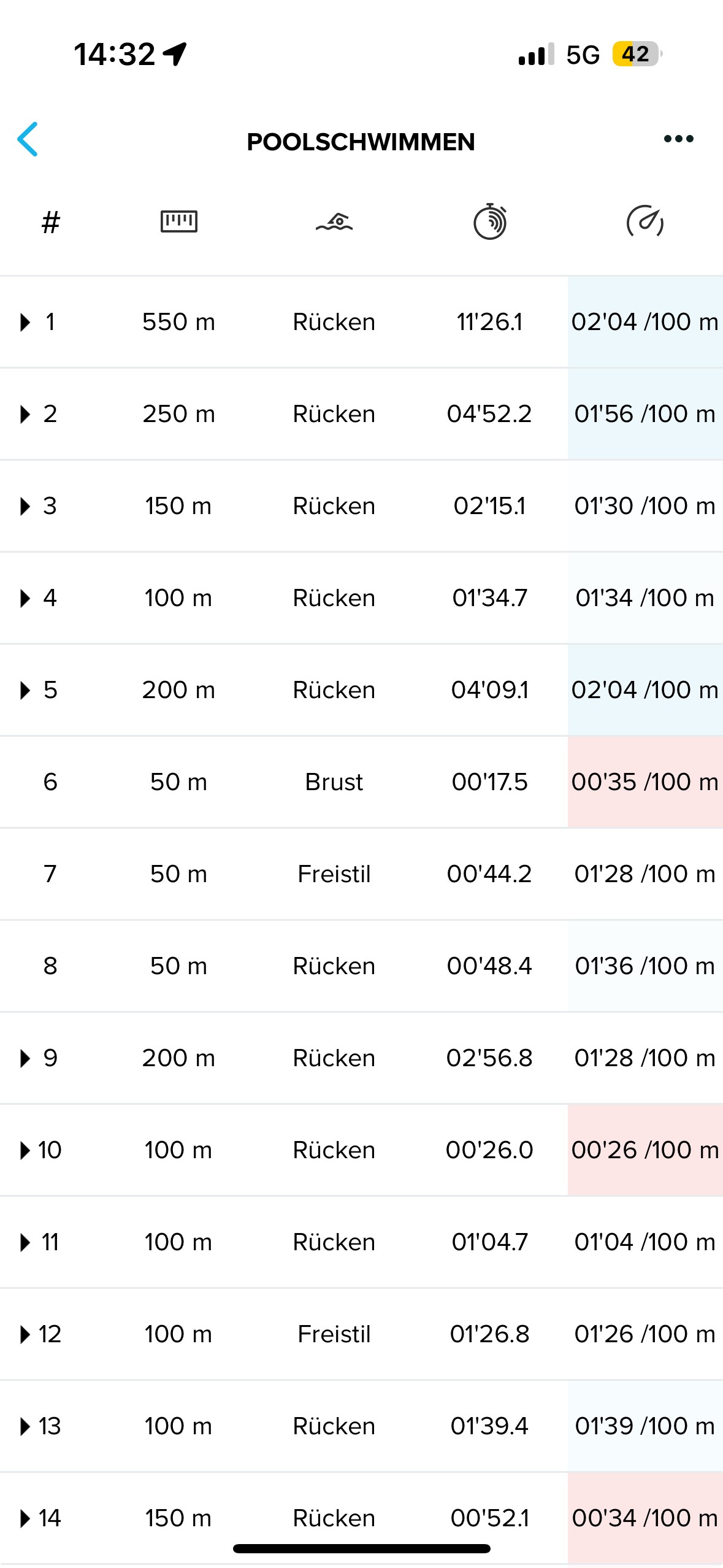

                      Hey there again!
                      today i did a 2km swim and counted the laps by myself, so im sure about the distance. My Suunto race added 800m to the finals result… i mean - looks great on my strava but f*cks up my statistics.
                      Here is a screenshot of the record:
                      seems pretty bad…
                      S 1 Reply Last reply Reply Quote 1
