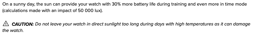

                        sartoric Moderator @VoiGAS
                        @VoiGAS
                        Be aware that it’s not recommended

                        VoiGASV 1 Reply Last reply Reply Quote 0
                        • VoiGASV Offline
                          VoiGAS Gold Members @sartoric
                          @sartoric Didn’t know that, thank you for the warning! Its still cold here, so I hope the watch didn’t got hurt
                          Race S
                          Vertical Titanium Solar
                          Ambit3 Vertical
                          SquirrelS 1 Reply Last reply Reply Quote 0
                          • SquirrelS Offline
                            Squirrel Silver Members @VoiGAS
                            @VoiGAS It all depends on the internal and thus battery temperature. You can easily check the internal temperature by looking at Alti/Baro/Temp widget after some time in direct sunlight. It depends on the ambient air temperature and also largely on the amount of infrared radiation the watch is exposed to. For example if the watch is in the interior and behind IR blocking glass window, the internal temperature would be very close to ambient temperature considering the very low charging power generated by photovoltaic panel. If this is let’s say between 20-25°C ambient air, that’s way more favorable for long term battery health than on the wrist temperature of ~32°C (currently on my wrist).
                            Leaving it directly outside is of course a bad idea for prolonged periods, unless you can compensate by low ambient air temperature that keeps internal temperature from raising to unhealthy levels.

                            • VoiGASV Offline
                              VoiGAS Gold Members @Squirrel
                              @Squirrel Thank you! So I will charge it inside from now on.
