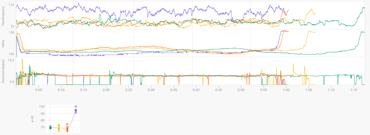

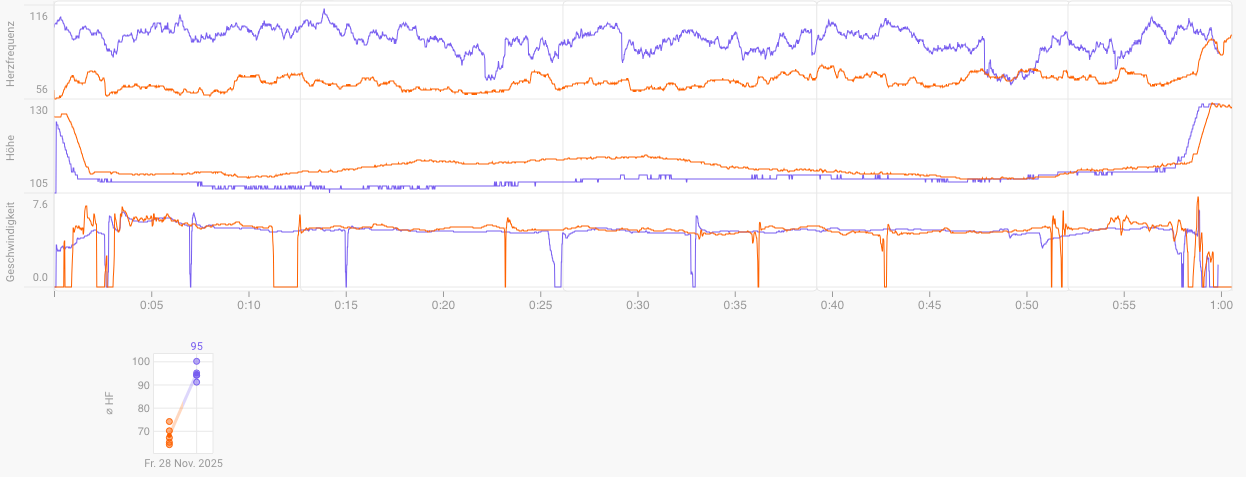

                      I want to share some data for my HR sensor is not good for even a simple walk. This week I did a couple of similar walks with my wife. Some with an Epix Pro and one with the Race S. Two of them are similar enough that I can easily compare them in intervals.icu. It’s always the same. A walk along the street, crossing a traffic light, walk a large round in the local park, cross the street again, back to the house where we rent a flat and walk up the stairs to the flat. So, it should be a fairly even HR recording apart from the climb of the stairs, where the HR should rise…
                      First graph is HR, second is elevation, below pace and then average HR. Educated guess on what the Suunto is and what the Garmin?
                      Combining it with the others that have been some minutes longer it looks like this:
                      Race S HR detection is not even reflecting the climb of stairs that all the other recordings do…
                      Race S
