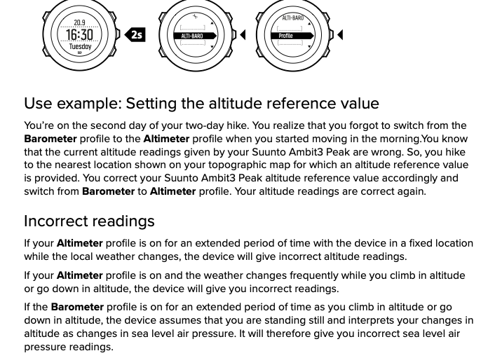

                                  Bringing this topic back to life …
                                  the storm alarm doesn’t seem to be really triggered as supposed to . Contrary to my ambit 3 peak , which I tested today over a storm the vertical didn’t show anything . I feel as if the sensitivity is somehow different
                                  surfboomerangS SamppaPS 2 Replies Last reply Reply Quote 1

                                      • It goes without saying that the storm alarm is on
                                      • the main watch is Suunto Vertical Ti (it has a barometer)
                                      what I am saying is that by observation the Vertical does not respond the same way as my Ambit 3 Peak ( I own the vertical for approx 2 years now)
                                      The Vertical and my 9Peak seem to have a very similar approach whilst the Ambit 3 Peak not
                                      I am thinking and have stated also in the past (maybe I’m wrong though) that the automatic adjustment of barometric pressure to altitude vs weather changes may be the reason for some delay in the triggering.
                                      So it may (or may not of course) be the case that the newer devices initially treat the pressure as altitude variation and then the hPa variance to be calculated versus a slightly offset measurement, resulting in delays in this triggering

                                          Just our of curiosity
                                          Have you defined the ambit to use barometer or automatic in alti-baro (if you set the altimeter i think the alarm is not triggered) ? ca12fc45-a74d-496e-86c1-ca2f36bdd566-image.png
                                          SamppaPS 1 Reply Last reply Reply Quote 0
