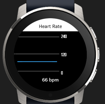

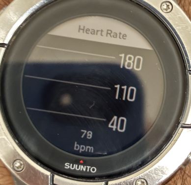

                          • Tomas5T Offline
                            Tomas5 Gold Members
                            Hello, can anyone help, I am trying to display Graph for HearthRate.
                            I am using this code for displaying graph, it is taken from one of examples just modified input path for current hearth rate:
                            <graph style="position:absolute;
                                          left:0px; top:0px; width:100%; height:100%;
                                          box-sizing: border-box;
                                          padding-right:90px; padding-top:60px; padding-bottom:60px;
                                          font-size:21px;"
                                   valueFormat="HeartRate_Fourdigits"
                                   type="line"
                                   grid="three lines"
                                   inputType="subscribe"
                                   input="/Activity/Move/-1/HeartRate/Current"
                                   min="0.6666666667"
                                   max="3"
                                   slack="0.1"
                            and it works fine in simulator and I see this:
                            but when I upload app to watch (Suunto 5 or Race 2), than there is no graph line for Heart Rate:
                            Suunto Ambit 2 > Suunto 5 > Suunto Race 2
                            Tomas5T M 2 Replies Last reply Reply Quote 0
