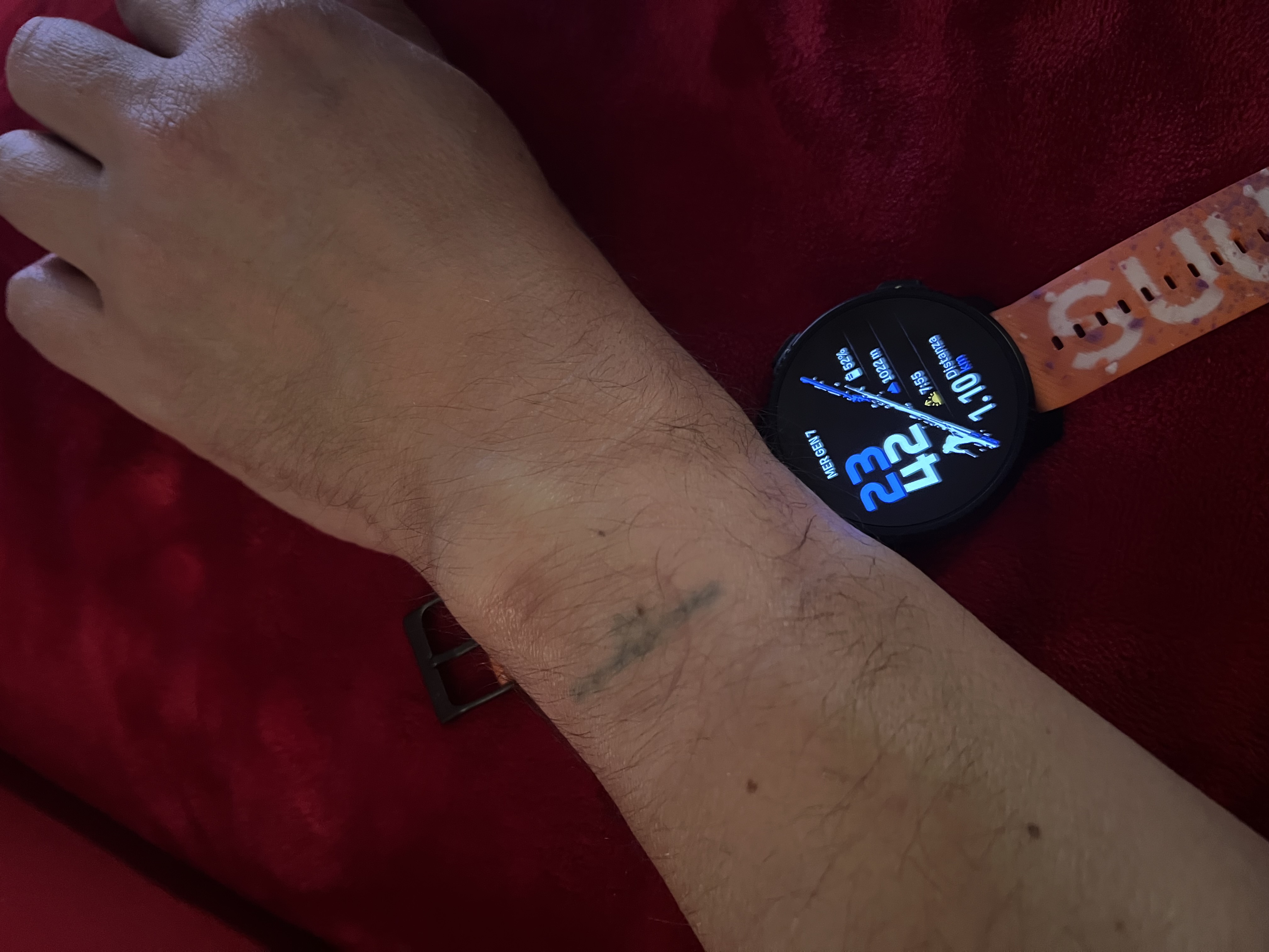

              After a few weeks of testing, the issue started to occur again.
              The OHR sensor turns off without warning and does not turn back on until the watch is removed from the wrist or a forced restart is performed.
              Vertical 2 v2.53.42

                Nothing. Even after the FW update, the issue with my V2 persists, but only on my left wrist — the one with this tattoo.
                It doesn’t happen with any other sensor.
                Suunto, do something!!
                Vertical 2 v2.53.42
                EgikaE 1 Reply Last reply Reply Quote -1

                  Egika Platinum Member @Manuel Extreme
                  @Manuel-Extreme how can Suunto do anything about your tatoo…?
                  I suggest you move the watch to the other arm, to the underside of the tatooed arm or higher up the wrist.
                  t6, S6, Elementum Terra, Ambit 3 Sapphire, Spartan Ultra Copper, Traverse Alpha, S7 Graphite LE, S9B Ambassador, S9P Titanium, S9PP Titanium, Vertical All Black, Race Titanium Charcoal, Race S Titanium Courtney, Run Lime, Race 2, Vertical 2 Titanium
                  Manuel ExtremeM 1 Reply Last reply Reply Quote 1

                    Manuel Extreme Silver Members @Egika
                    @Egika The sensor crashes. It turns off and won’t turn back on until I remove the watch and put it back on my wrist.
                    This happens in particular after using the heart rate strap for an activity.
                    It doesn’t happen with any other sports watch. It didn’t happen with the Vertical 1 either.
                    For this reason, I think it’s a software management issue that should be analyzed by Suunto.
                    Vertical 2 v2.53.42
