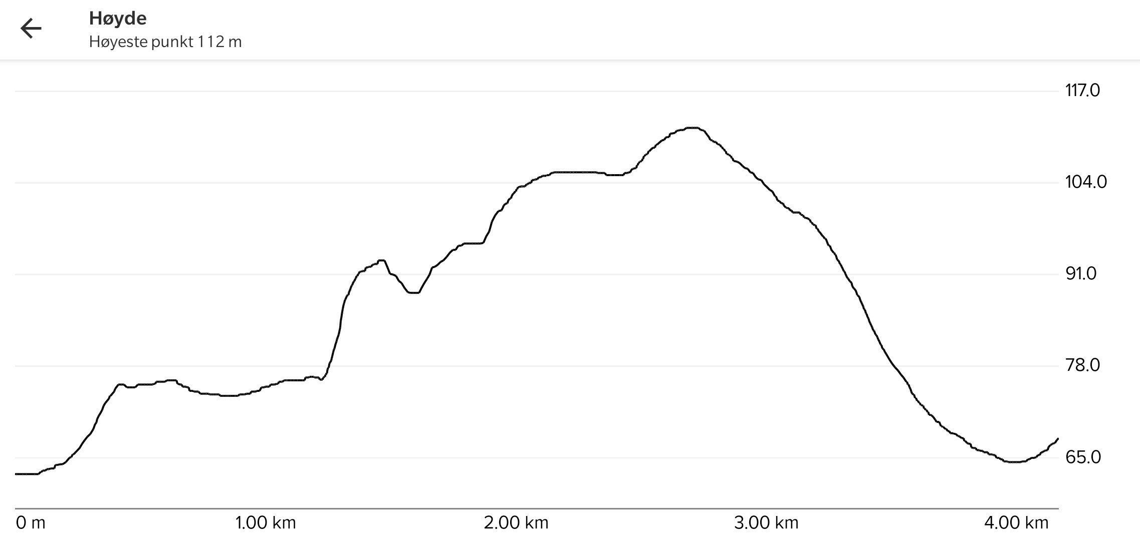

                        I haven’t noticed any issues with the altitude recorded by my Suunto 7.
                        For example, today I did a run along a local canal and at a defined point I turned around and came bac along the exact same route.
                        As expected a canal is pretty flat, and the watch recorded only 3m of altitude change (I ran 8.6km out and back with a total of 17.2km).
                        The plot of altitude change is also symmetrical, as one would expect.
