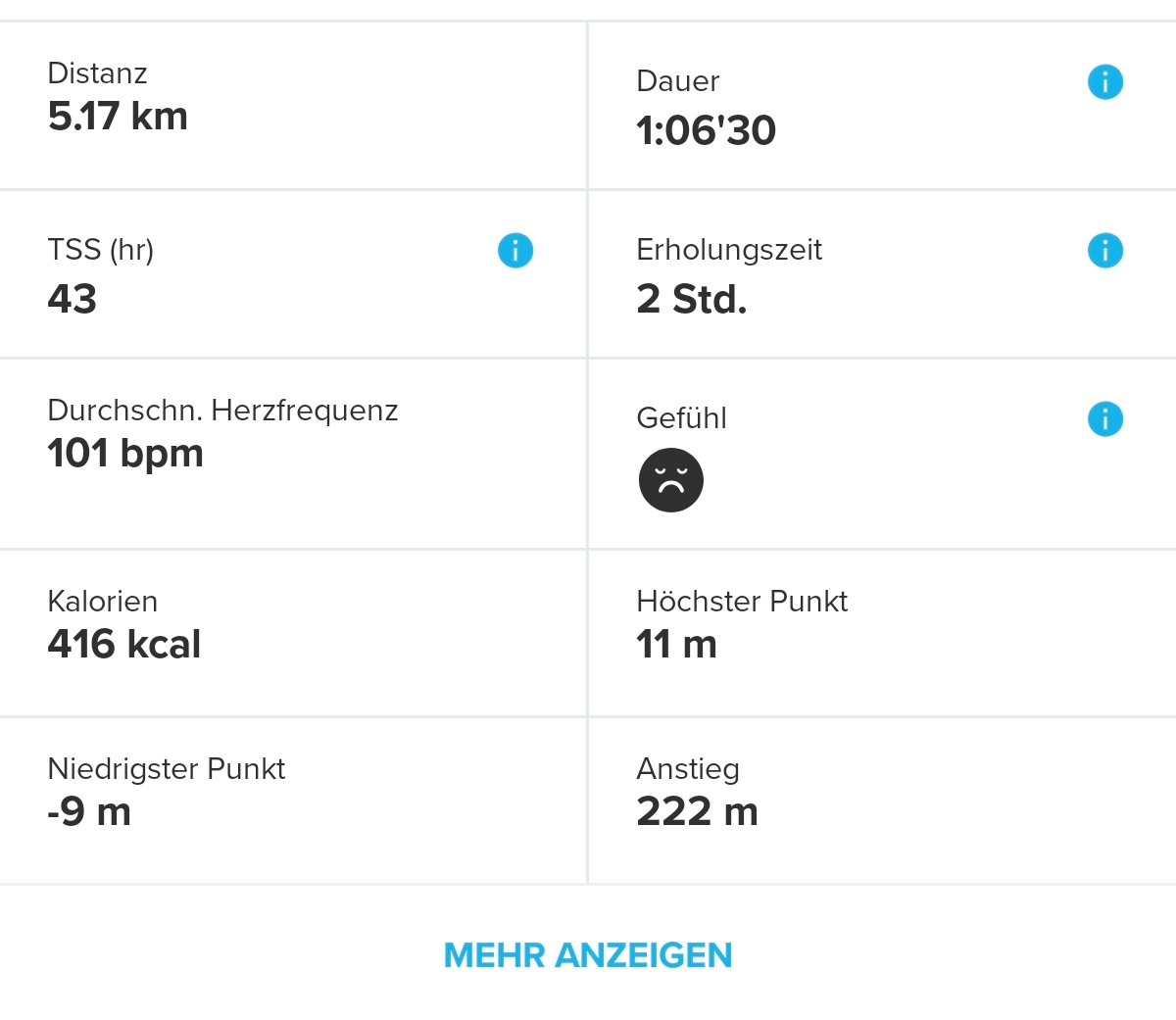

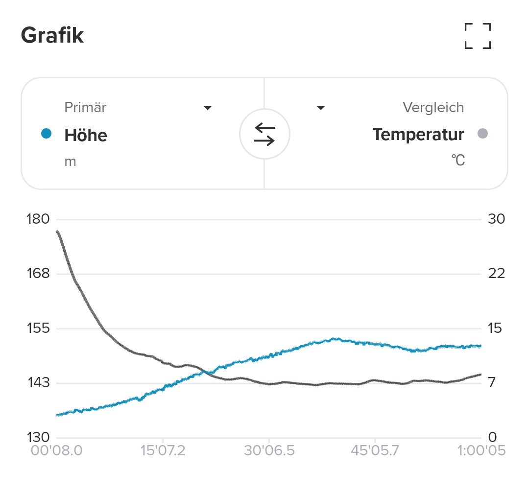

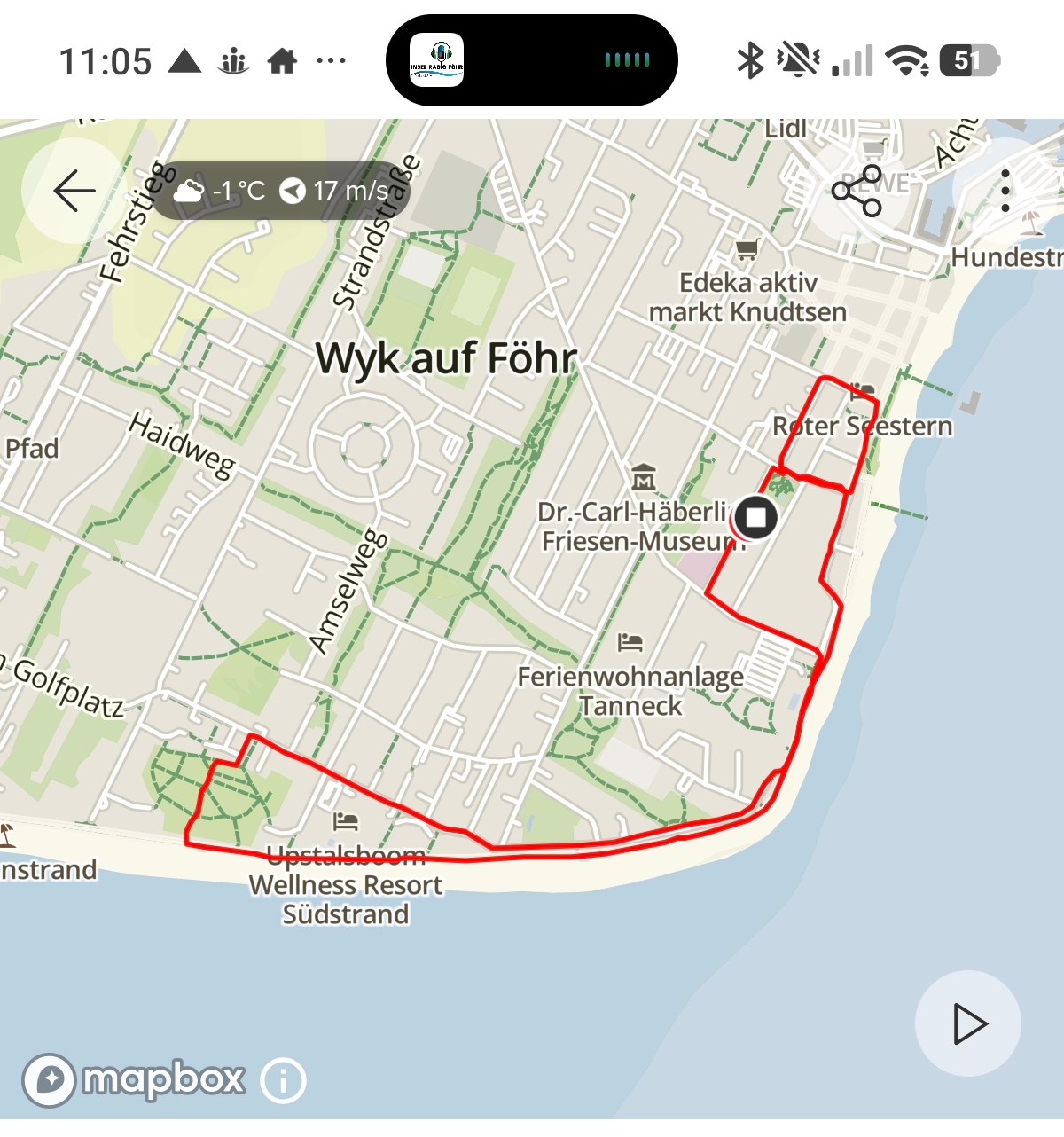

      Like @Dimitrios-Kanellopoulos says in another Post - i Open a extra Post for the Elevation “Problem”.
      One data set i post here, too.
      Hiking_2026-01-09T09_37_55.fit
      Here is the Activity at sealevel. My watch counts 222m of positive Elevation…
      ![Bild Text](Bild Link1000134872.jpg 1000134871.jpg 1000134869.jpg )
      If it doesn't challenge you, it doesn't change you. #lifewithasthma #runwithasthma #nevergiveup #pushinglimits #adventurestartshere Suunto Ambit 3 Peak , D9, Vertical Ti, Race , RaceS Courtney, Race 2, Vertical 2, SA (Beta) Android Insta: @gipfelkind
      B sky-runnerS 3 Replies Last reply Reply Quote 0

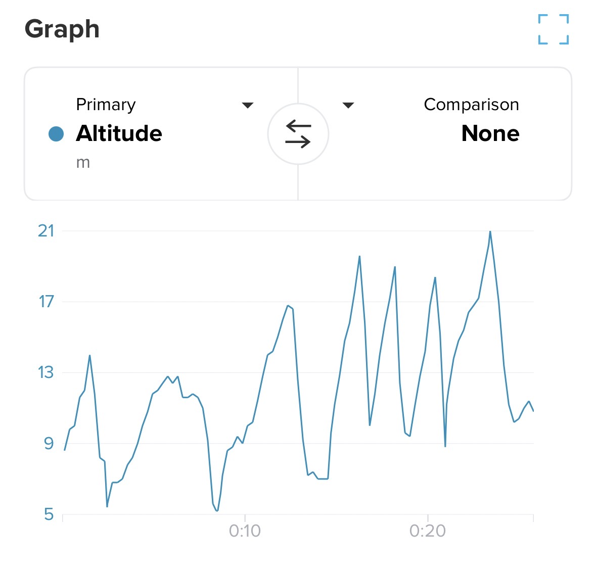

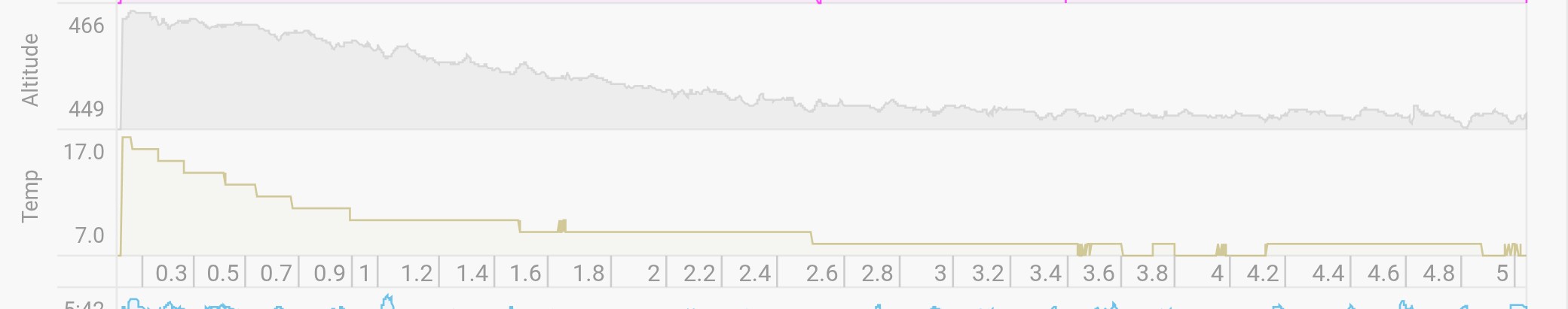

        @Dimitrios-Kanellopoulos As requested…
        I did an almost similar round of running before and after the firmware update of my SV1.
        The route is totally flat except for one tunnel. This explains the small dips in the altitude graph.
        Before the firmware update: ascent 0m, descent 0m
        After the firmware update: ascent: 4m, descent 19m
        I live 1m below sea level which was nicely recorded before the firmware update. After the firmware I ended the run with -18m
        Suunto Vertical Titanium Solar
        OnePlus Nord 4
        sky-runnerS 1 Reply Last reply Reply Quote 0

          @GiPFELKiND is this maybe the cumulative ascent? Looks reasonable if you add all the „ups“ ? Don’t know just wondering

            @BastMaSVSRS9PP 222m of positive Elevation while Walking at sealevel?! No never ever. Never had this before. There arent Hills…

              @BastMaSVSRS9PP there was No Up… 🫣

                @GiPFELKiND 🙂 ok that’s weird then

                  @surfboomerang To me this looks like the barometer port might be dirty. I’ve had something similar recently and fixed that by soaking the watch for a few hours in water with a bit of dish soap, then rinsing and drying it. After that the issue has gone away.
                  Suunto: Ambit, Ambit 3 Peak, 9 Baro, Race S, Race Ti
                  Garmin: Forerunner 210, Forerunner 610, Fenix 6X, Fenix 7X Ti
                  surfboomerangS 1 Reply Last reply Reply Quote 1
                  • surfboomerangS Offline
                    surfboomerang @sky-runner
                    @sky-runner the watch is cleaned after every activity and the baro sensor looks clean.
                    Wind could be a factor, but I checked a bit further back in history and the last 10 runs before the firmware all show a relative flat line like in the first graph.
                    OnePlus Nord 4

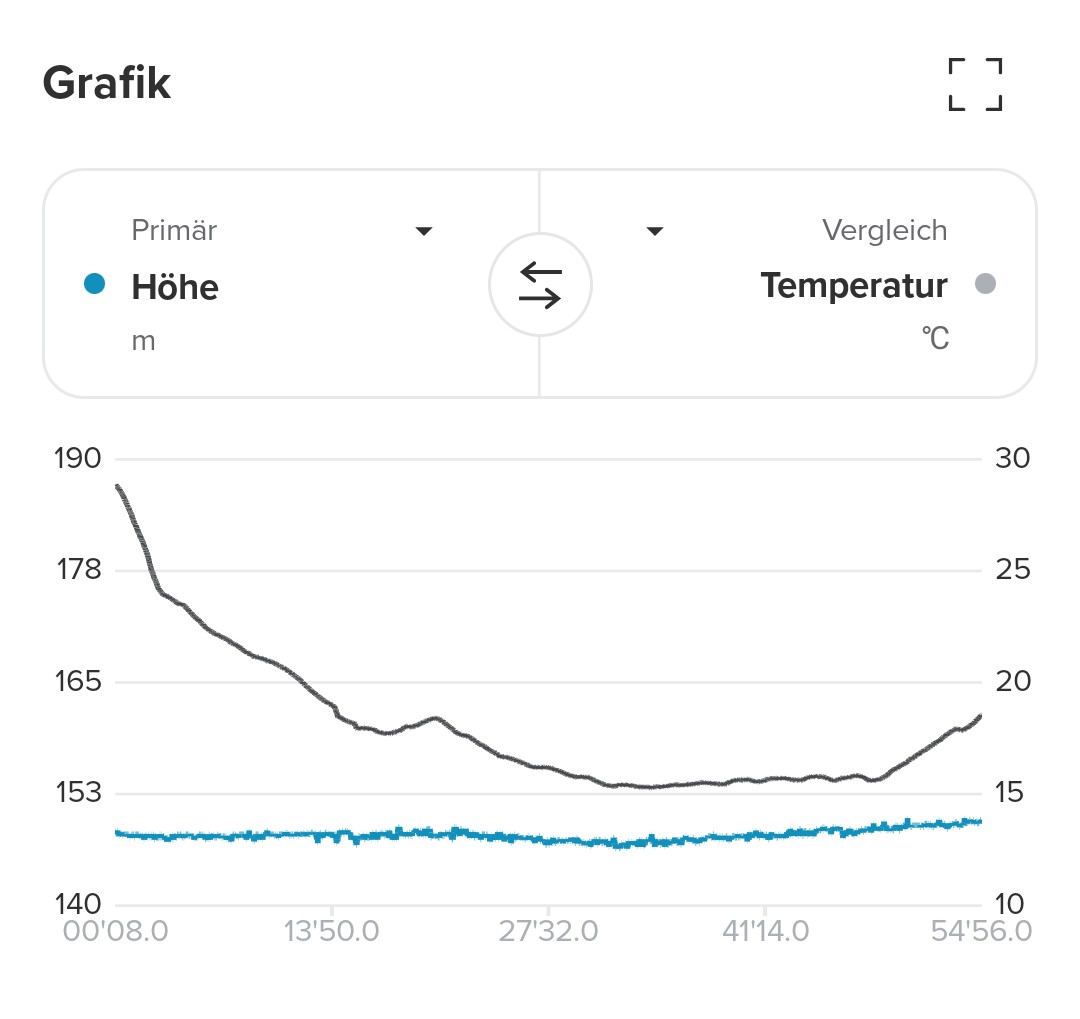

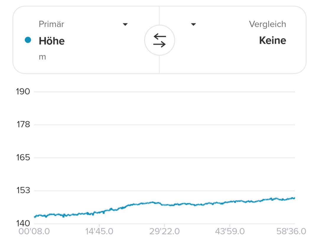

                      As @Dimitrios-Kanellopoulos suggested in https://forum.suunto.com/post/183086 i wanted to with additional data (however i am using a race 2 not a vertical 2):
                      I ran a flat route (track training) - to give you an impression:
                      With the latest firmware the watch tracked 16m ascent / 0m descent, see picture and .fit file:
                      Running_2026-01-08T17_37_59.fit
                      This corresponds with the latest firmware 2.50.26 (altitude and temperature):
                      For your reference the former firmware was working fine:
                      Running_2025-12-18T17_41_36.fit
                      This corresponds with the former firmware 2.48.16 (altitude and temperature):
                      I couldn’t upload the json files for some reason, please note that i will return to the track on thursday (and most likely every other thursday) so just let me know if there is a setting that i should try and if you need additional infos/data.
                      Thanks to @GiPFELKiND for opening this thread 😉

                        @GiPFELKiND you barometer had noise and ups and downs. So this is not due to the update fyi. WE analyzed the data.
                        About the other one activity I see fused alti kicking in and that created the ascent. Lets see how this goes need more info

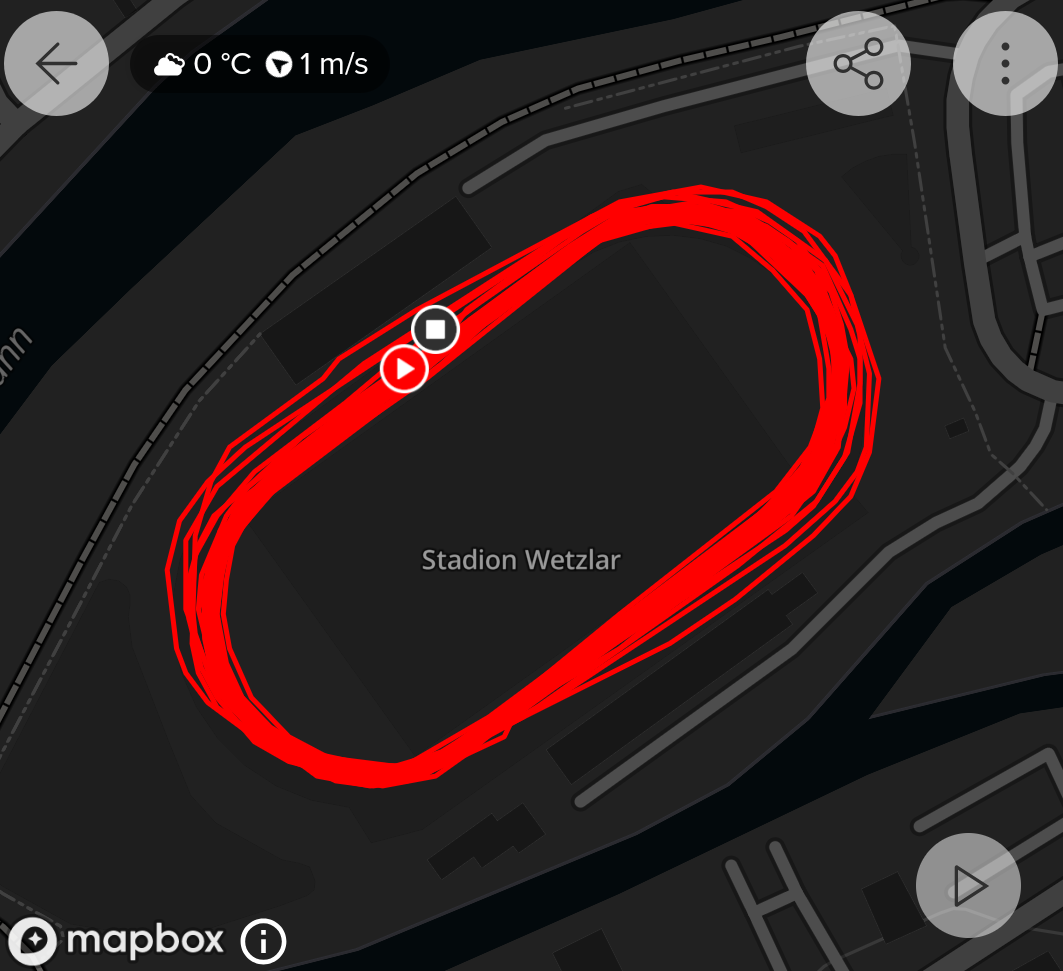

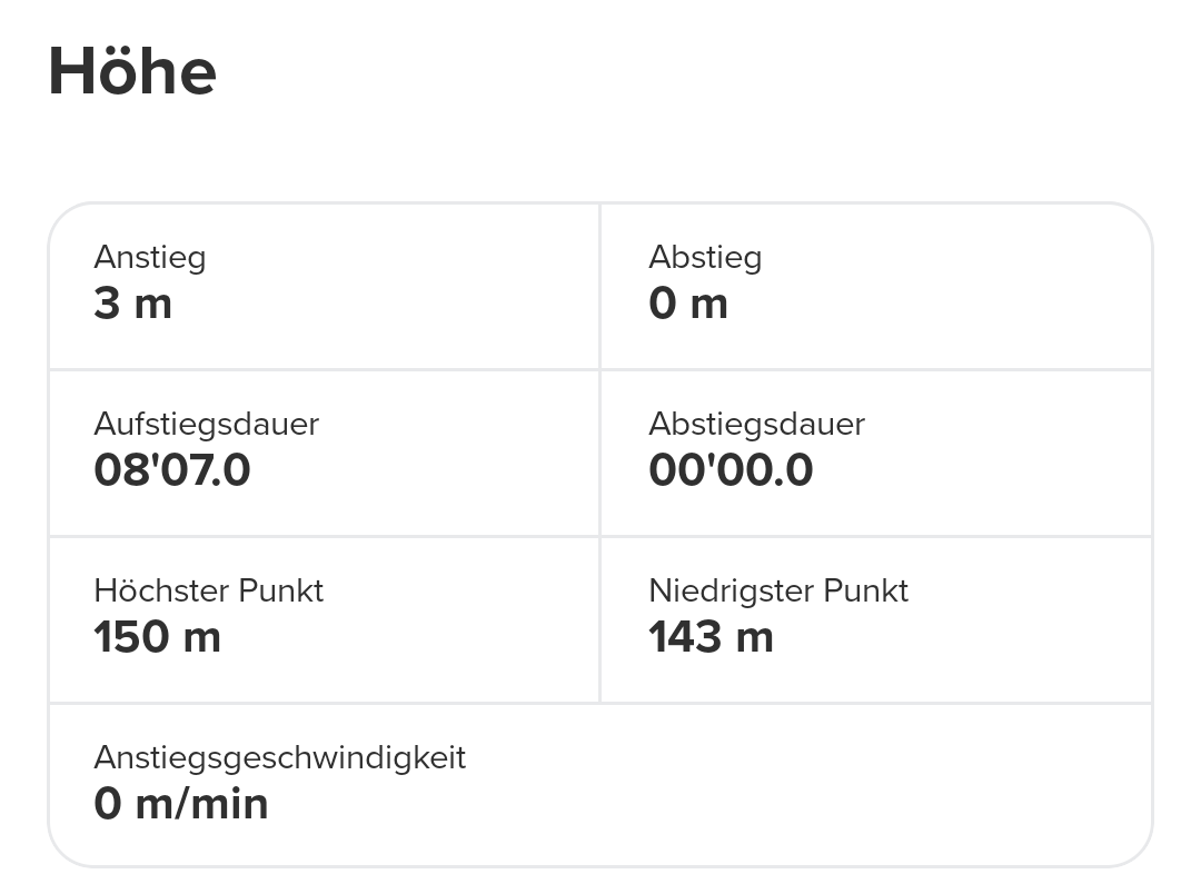

                          @Dimitrios-Kanellopoulos today i ran an identical training on a (flat) track, there are 3m in ascent. Compared to former firmware unfortunately not better.
                          However If the effect ist die to fused-alti, could this fused-alti bei improved to be as good as before? 😁
                          Here ist the data
                          Running_2026-01-15T17_41_32.fit
                          The (flat) track:
                          the altitude, this time just a bit off, but still off:
                          The altitude stats in numbers:
                          highest point 150 m, lowest point 143 m, ascent 3 m, now lets me wonder if the change in the initial threshold from 3 m -> 2m and meter by meter measurement afterwards does mess numbers for this case?

                              What can i do now? Where the noise is come from? My Sensor is Clean. Thank you for your informations about this 🙏🏼

                                @GiPFELKiND nothing. It could be one off or just some water before. If it persists then pm me.

                                  @MatthiasKlug the fused alti has not been touched. This is expected and it’s ok for 3m. For the time being that is.

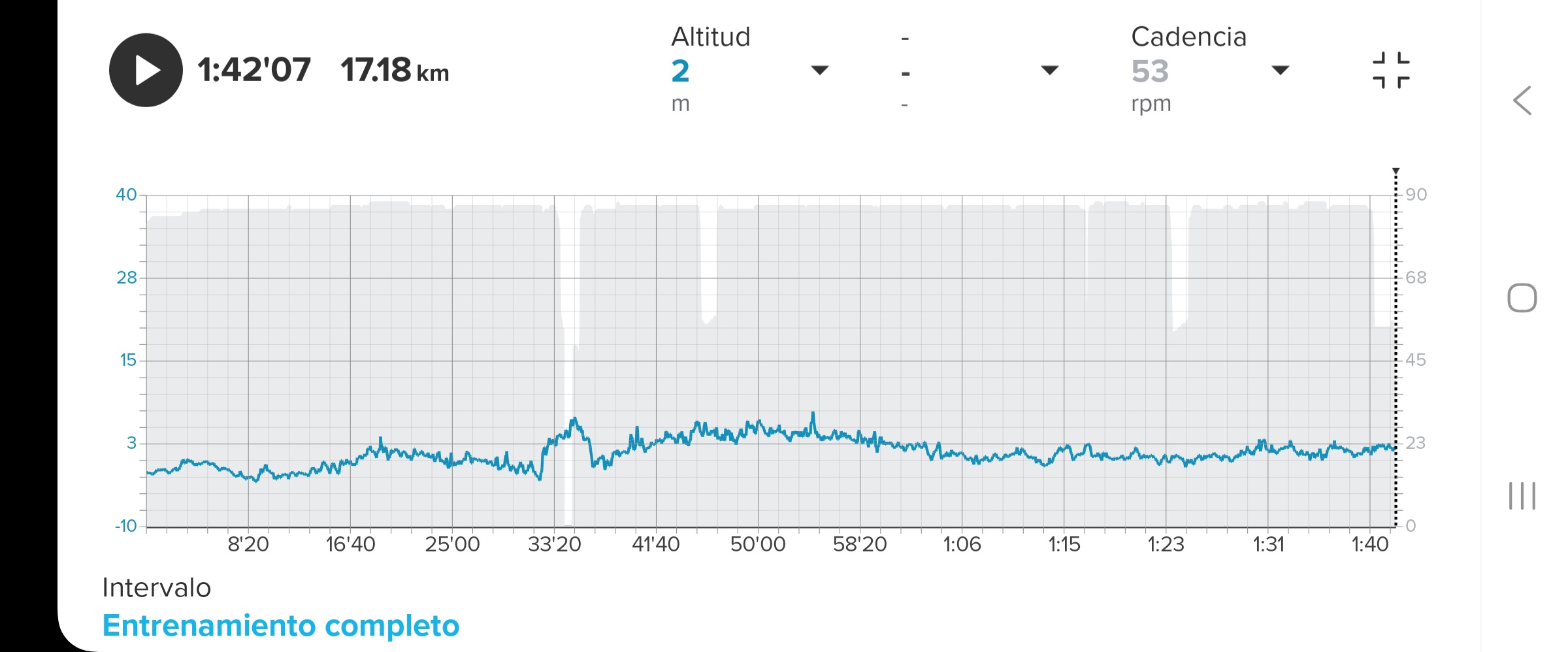

                                        Just returned from first run after few months. I tried 5km track run activity on 200m oval 2nd lane, so 208m but that that’s not important. I got 15m descent even on flat track. Don’t know, if it was better before 2.50.26 FW, but according to charts, it seems temperature correlated. At home, I put the watch on jacket sleeve, so the watch temperature was gradually decreasing outside, but not to ambient temperature, which was about 1°C. And the elevation chart curve seems to copy the temperature chart.
                                        Suunto Vertical 2
