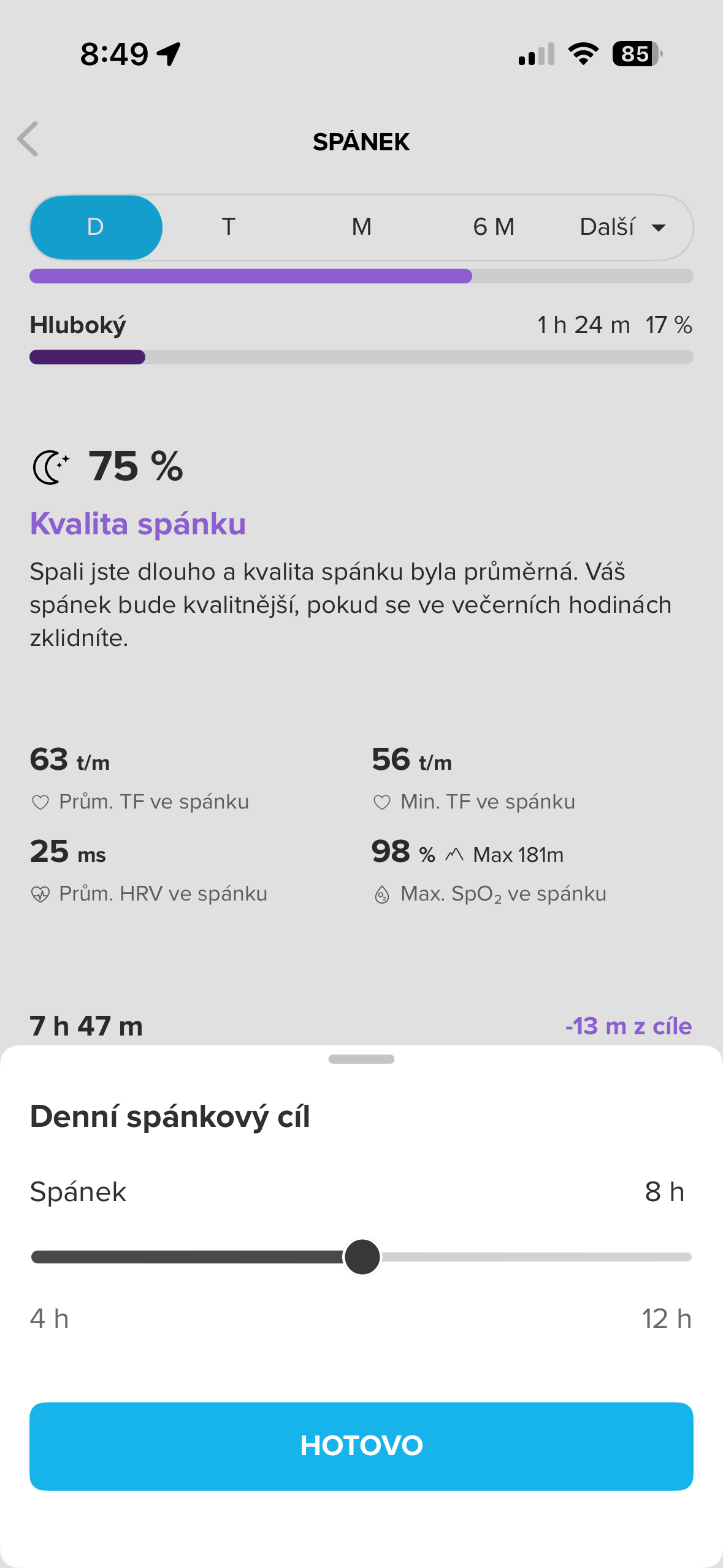

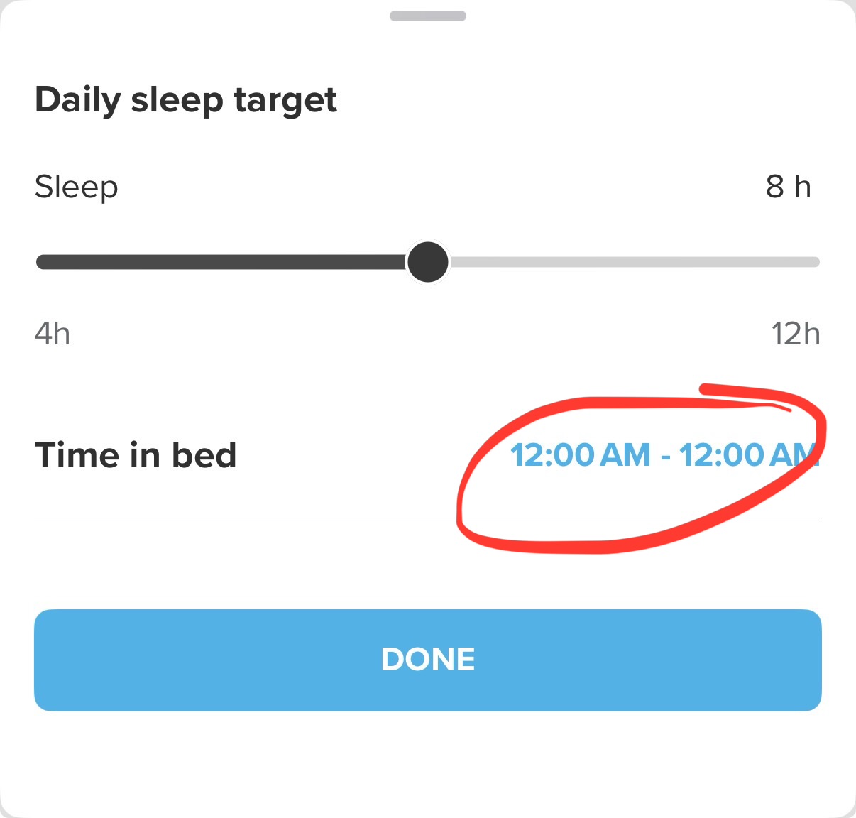

                                        I would like to update/clarify the above instructions as per my (successful) fix.
                                        Re: 2 - you do this in the (iOS) Suunto App. My time in bed was (re)set to be from 12:00AM - 12:00AM and that’s why the watch was showing a day old sleep data (see img. below).
                                        I also had to add point 4. - soft-reset of the watch (12 seconds upper button).
                                        All good now in the land of sleep.

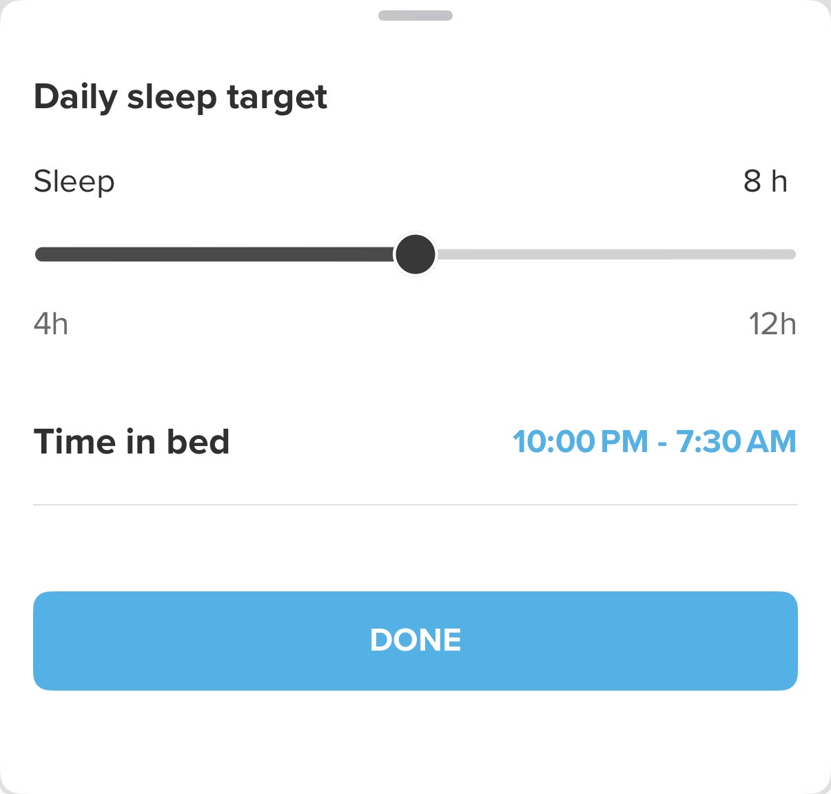

                                            @Egika , @Freezer Thanks for these clarifications, indeed I assumed the sleep time adjustments had to be performed on the watch, not the iOS app. And after „forgetting“ the watch AND restarting the app on the iPhone, the „time in bed“ settings showed up. Given that apparently past data is not changed, I will have to wait for after the coming night to evaluate the effect this has (or has not) taken. By the way, if you have a second iOS device running the Suunto app, but obviously not paired with the watch, the settings (which then seem to be linked to your generic account and not to a specific watch) can also be changed there without undergoing the forgetting/re-pairing procedure. The „time in bed“ settings are visible on my second iPhone.
