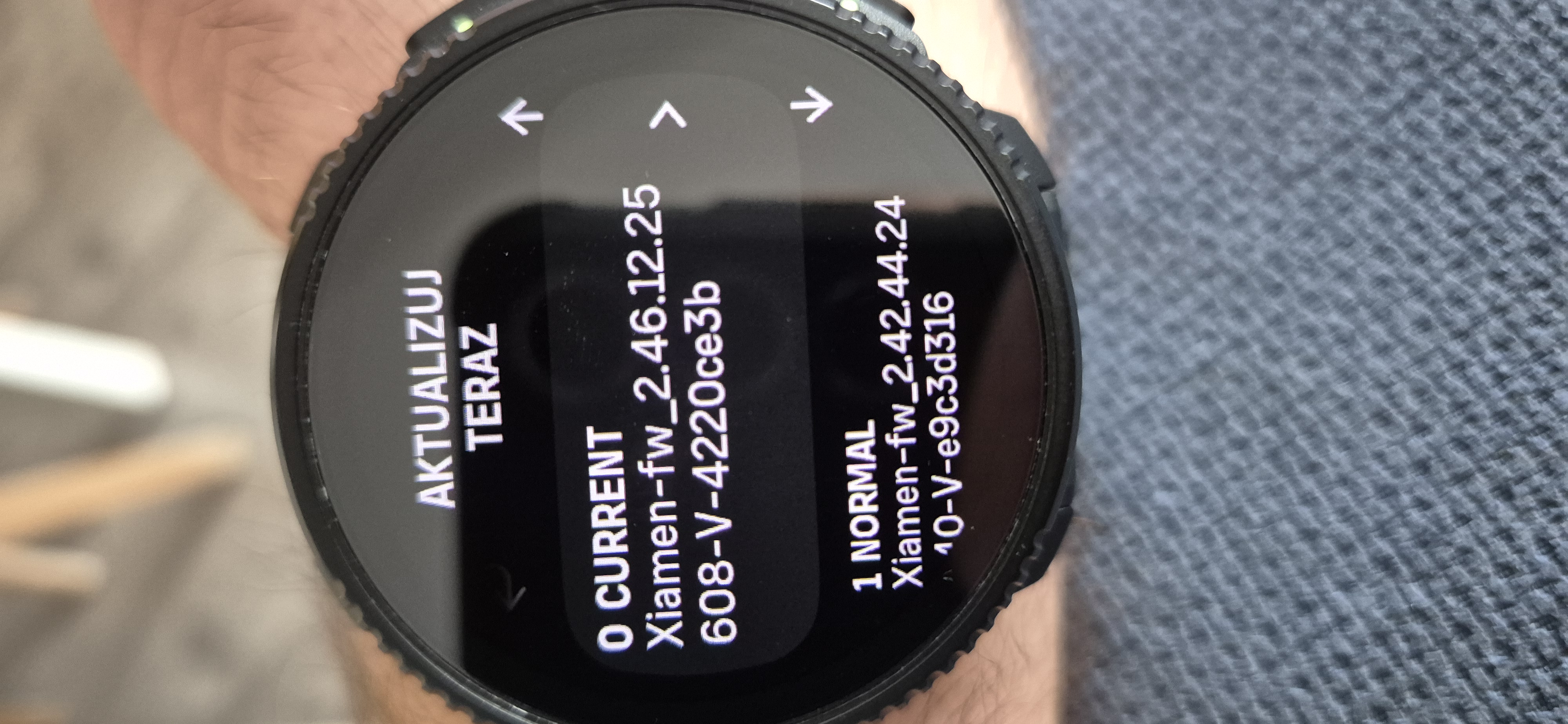

        @Martin-Vrska Do you mean you removed all the OTA packages from the watch in the hidden DEBUG menu? As far as I understand it you‘ll need at least one to restore the watch to the original state/hard reset it
        Martin VrskaM 1 Reply Last reply Reply Quote 1
        • Martin VrskaM Offline
          Martin Vrska @ChrisA
          @ChrisA There’s only the current one, but when I click on it, the watch goes back to the previous screen. It seems like I can’t help myself, right?

            @Martin-Vrska I don’t really know if there needs to be at least one, which is considered the one the watch boots with when a hard reset is performed. They have numbers and labels like “1 normal ” or “0 current” and maybe there need to be a “normal” one?
            I personally really don’t touch those (or even open this menu), since you can wipe all OTAs with the press of a button. A friend of mine did this accidentally and called me because he knew I had a Suunto too and it turned out he had to send his watch in for service then to get it restored. I would contact Support - perhaps they can help?!
            Martin VrskaM 1 Reply Last reply Reply Quote 0

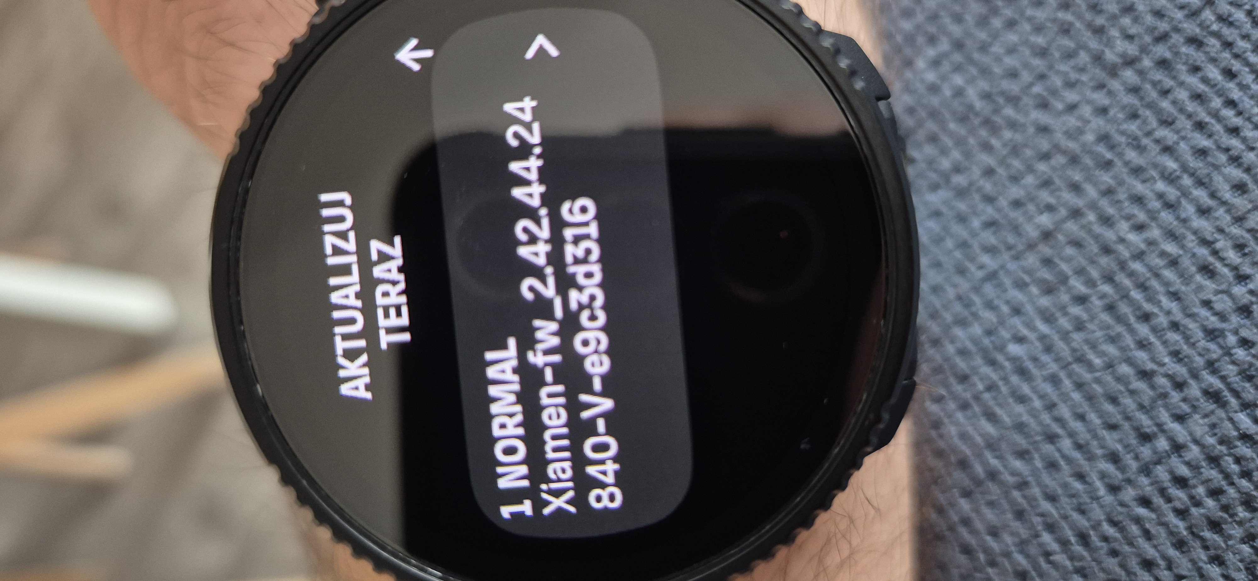

              @Martin-Vrska
              That’s the one labeled “1 normal” in my Race 1 (just looked it up, being extra cautious, not to press something wrong here 😀)

                @ChrisA VIDEO I’m attaching a video. So would it help to at least wait for a new SW, which would allow me to go back to the one I have now? Or just service?

                  @ChrisA Under which item can I see this, please?

                    @Martin-Vrska It’s in a hidden debug menu. I strongly advice not to go there unless told to by Suunto support (I don’t touch it) There are posts here in the forum how to get there. Be careful you can delete all OTAs ther just by clicking (without further confirmation)

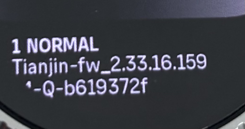

                                            @Tami999 by any chance did you have the needed firmware on your watch ? Or anyone else in order to try pushing it on the device of @Martin-Vrska before he try to send it to service ?
                                            I’m not sure it’s a good idea @ChrisA recommend to not go to this menu, I use it to downgrade but I don’t want to brick your device 🙈
