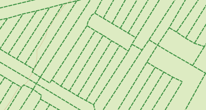

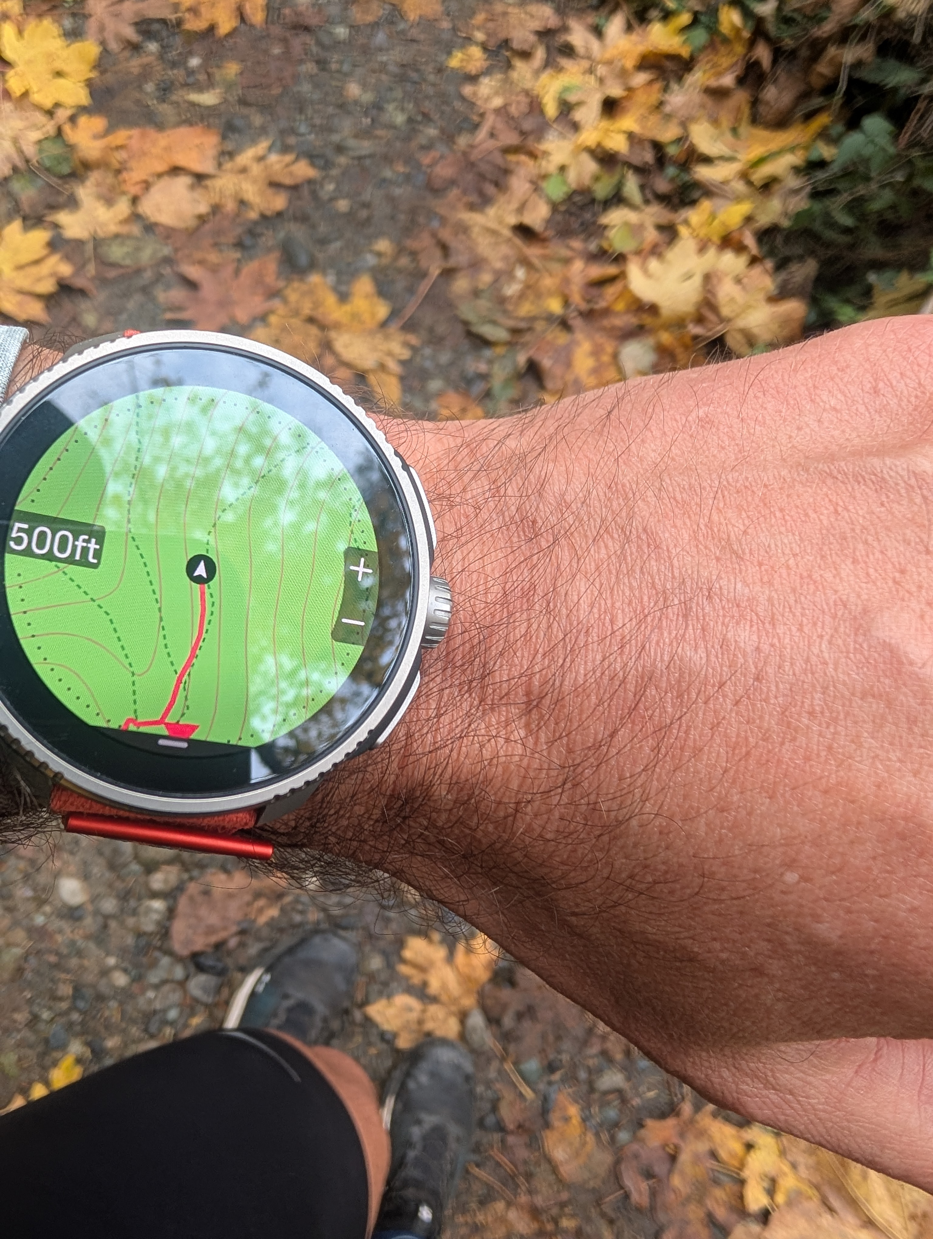

                        Suunto maps only look better, but are much less usable if we forget for a moment about the navigation layer on top of the map. Consider the map itself. But I would question even the “look better” part. For example consider this screenshot from my weekend trail run and imagine looking at that not on a large screen but on a small watch screen at a distance of extended arm and while running:
                        Can you even see what I am talking about? Who thought that rendering trails as green on a green was a good idea? And I don’t even mention that one more zoom out and I’d be staring at a pure green screen with zero details.

                          @sky-runner I have already written here many times that Suunto maps become useless when viewing a slightly larger area. No trails, no paths, no contour lines – just breadcrumb on a colored background.
                          If there is a place with more landscape elements (lake, fields, cliffs, etc.) then Suunto maps look great.
                          Regarding your photo, I’ve been concluding for some time that the people responsible for the map’s appearance don’t actually use them in the field. Look at how cartoonishly clear these paths are in the city (they look like some kind of highway), and how difficult they are to see, for example, in your photo.
