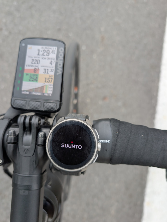

      …just a quick reminder to all Suunto developers: a sports watch should never, I repeat never, do one thing while recording: Crash.
      Suunto Race crashing
      But Suunto, just like Polar and Garmin, don’t really know how to safeguard their operating system so that mal function that causes the complete product to crash cannot happen, nor are they able to at least automatically resume recording right after the reboot happened. (This is what Wahoo does, but I’ve not seen it crash as many times as Suunto)
      As a responsible developer this would make me do some extra work and night shifts to find the root cause of such crashes and I could not rest until this is fixed.
      I do not mind bugs at all, it happens to all of us, but the system core must be designed in such a robust way that inner processes might restart, but are not able to doom the whole system like shown in the above picture after almost 5 hours of workout.
      And, please I do not need any answers that I did something wrong or should not mind. I do mind. I don’t crash after 5 hours of riding my bike, so my sports watch shouldn’t crash either.
      And I am not using any third party apps and my Race is on the most recent firmware and charged sufficiently.
      I sent my protocols to Suunto using the App. Anybody I might want to inform about this?

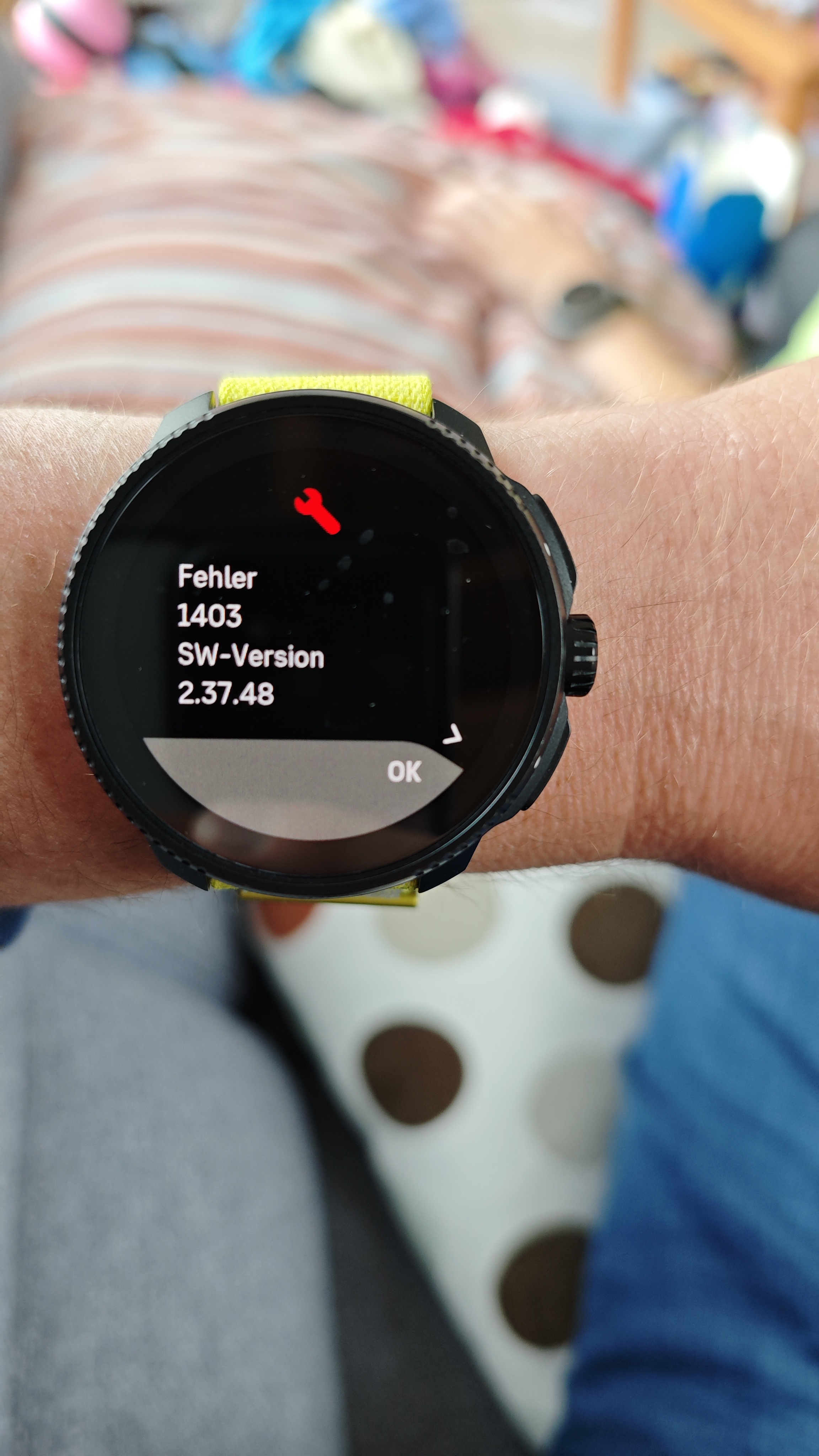

                            Hi Dimitrios - crashed again today. 2 crashes within 3 days. This is simply sick and defeats the complete purpose of a sports watch!
                            Today it crashed after only one hour. Didn’t notice it and since it did not resume recording my activity is more or less destroyed by Suunto.
                            I do NOT use any Suunto plus apps or whatsoever, it is the plain core Suunto App recording a bike ride.
                            This is not okay.
