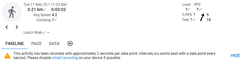

                  Ultra mode in Race seems that is not recorded with 1s interval, but about 2 seconds. At least according to intervals.icu which give me that info for Ultra mode test activity…
                  I was surprised, that I can´t turn map on with other modes than Performance.

                        @Jan-Suchánek There is power management in Ultra mode with the GPS chip so the recording interval will likely vary depending on the connection. The GPS fix will try every second but every second may not be recorded.
