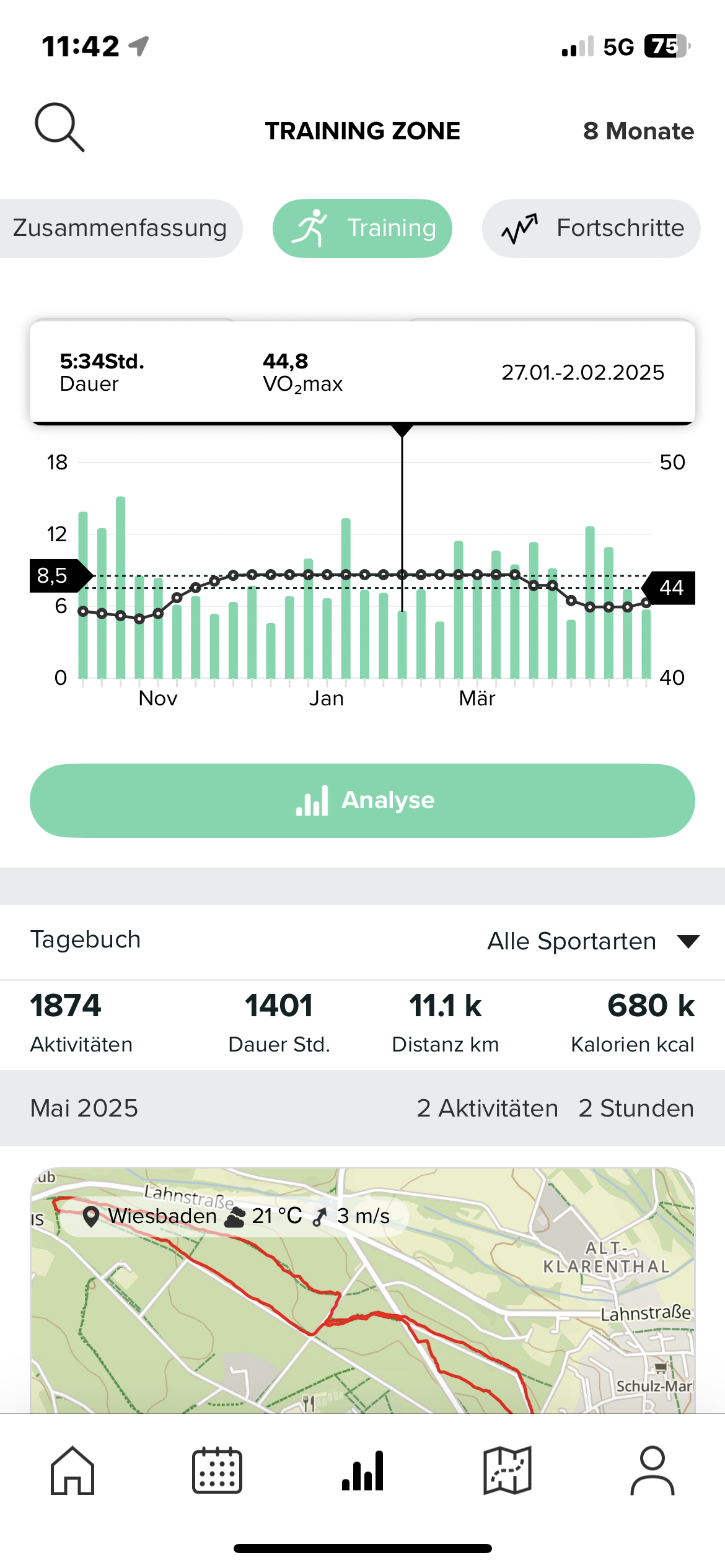

                            It is still working here but I had a back injury and didn’t go running or biking from Nov - Mar. but Vo2max stayed at 44,8 so I guess as there was no new measurement it just stayed there. Now it gets new data from running and it changes.IMG_1393.png
